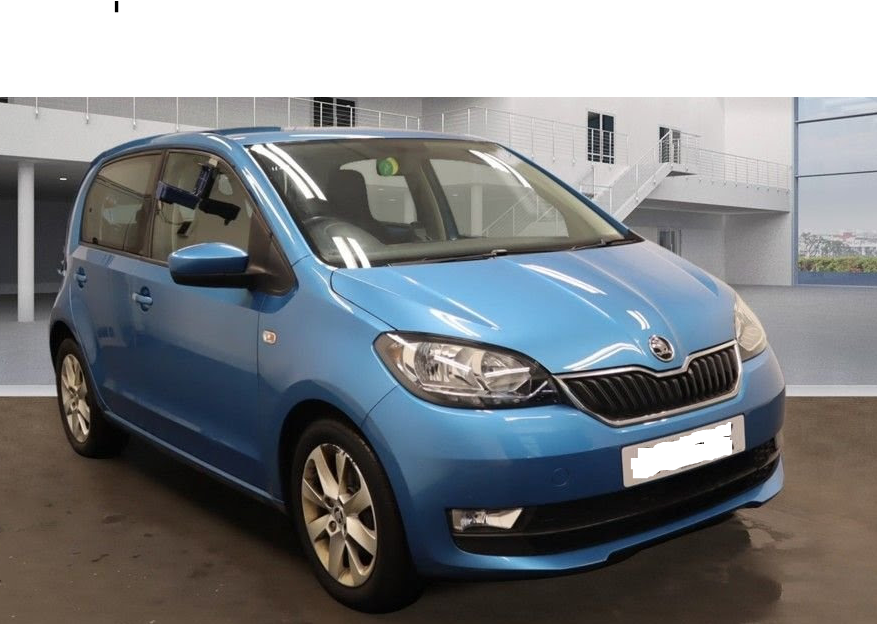

Anyone advise on paint code W5M (it's a metallic blue). I contacted my local Skoda dealer for a touch up kit and they could not find it on the Skoda system. Pic attached. Believe it might be called Crystal Blue metallic.
