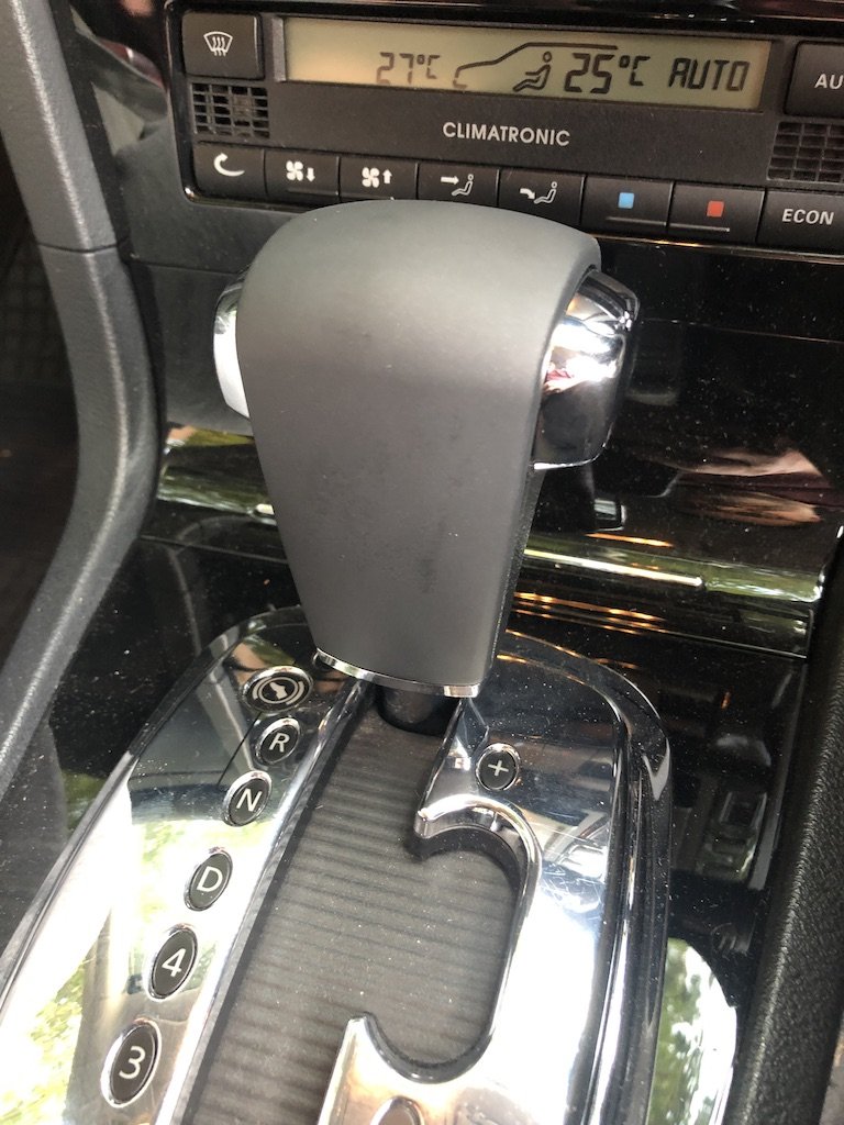

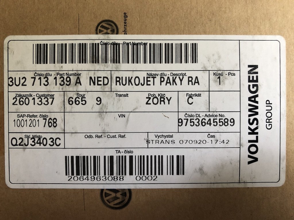

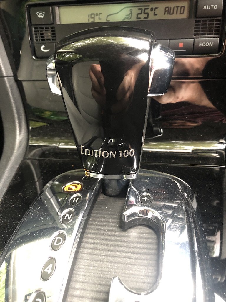

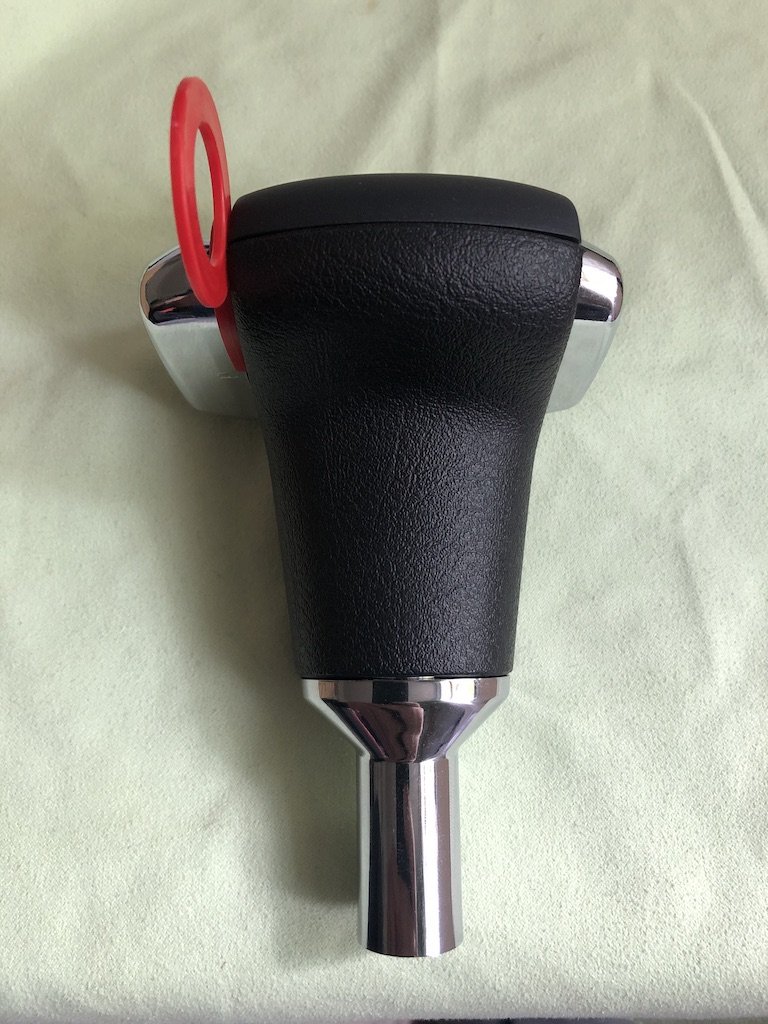

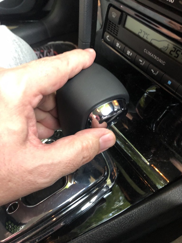

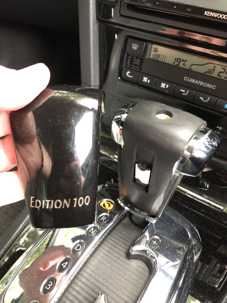

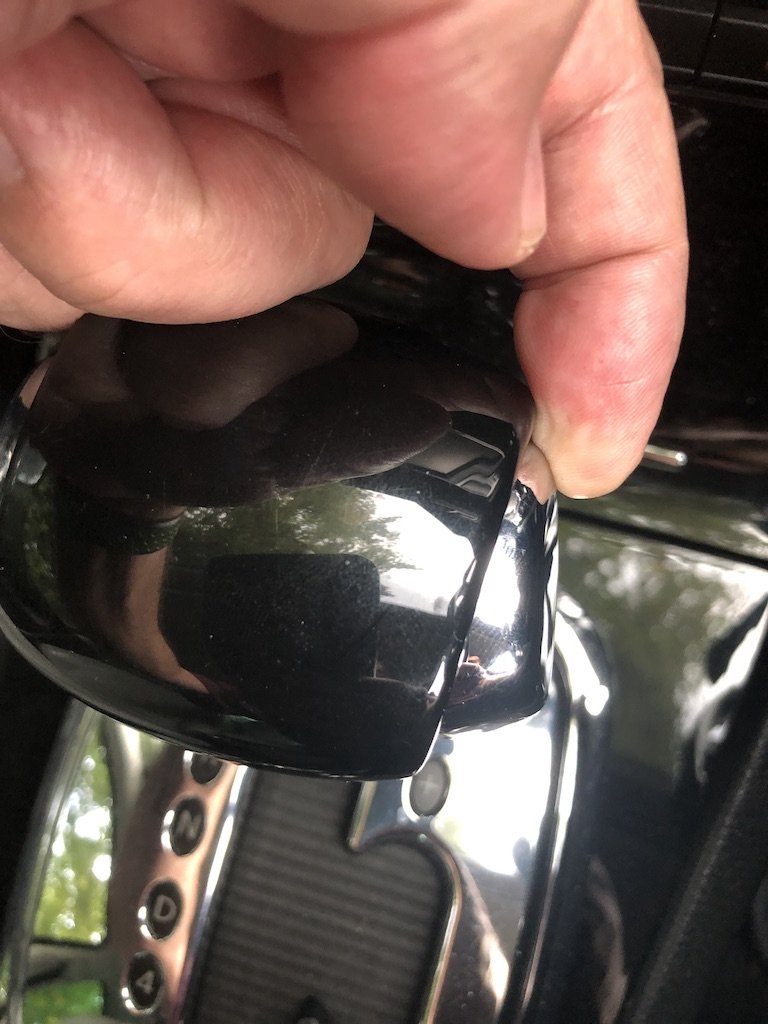

Hello All First thanks for the advice and reassurance that the Edition 100 gear lever can be replaced with the Superb Elegance model. Thanks to KKBC and all of you posting bits and bobs about it. The Tiptronic button on my gear selector got a bit wobbly, and by not listening to the elders and wise ones from this forum (it’s not will it, it's when it will go) I got myself in a bit of a pickle. Gear selector got stuck on to the P position and no budging. Option_1 £427 Inc. VAT from TPS for non-trading sale of original Edition 100 Tiptronic. 2-5 weeks waiting as no part is available in the UK Option_2 £100 Inc. VAT from local small garage for the Superb Elegance model, still 1-2 weeks waiting as no part is available in UK with no guarantee from them that it will fit as per ETKA 3U2713319C (original Edition 100) showing not compatible or replaceable part The wise and good people from this forum confirmed that the Elegance model is compatible with the Edition 100 and I did order it, replaced it, and I hope following details can be useful to somebody else Original Edition 100 part 3U2 173 319 C (too expensive by a mile) Superb elegance part 3U2 713 319 A NED (black and not so bad looking) Here are some pictures of parts and of the wobbly button as a warning to replace your gear lever on time. Best zoka Thanks
