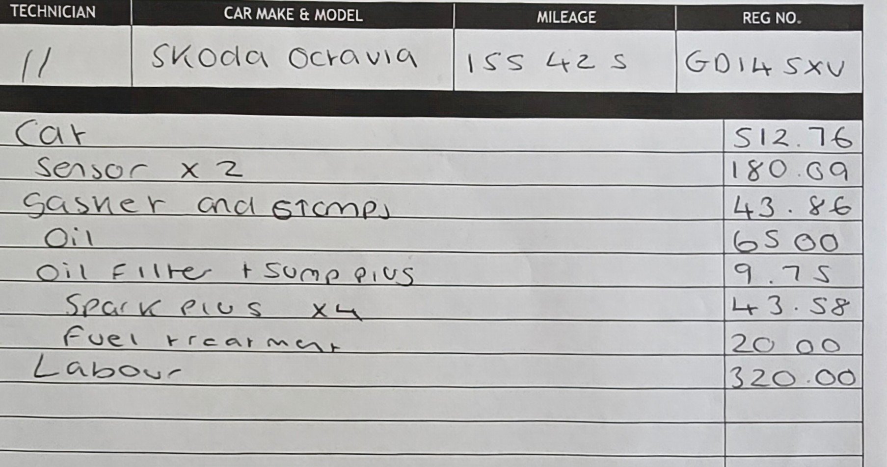

  1. That's the thing, the car seems to have been running fine. Yes there's a bit of rattle but then again it's done over 150k. Fuel economy seems to be ok, and I haven't noticed a huge drop in responsiveness. What else could cause such a huge increase in emissions from last year?
  2. To clarify a bit more: the catalytic converter was knackered and had to be replaced (I know, madness on a car with 155000 on the clock but cheaper than a replacement car right now!). When the new converter was fitted, it JUST got through after oil change, spark plugs and fuel treatment. I was then told it wouldn't get through another year due to the carbon build up even with the new catalytic converter. That's why I'm asking about Walnut Blasting as an option.
