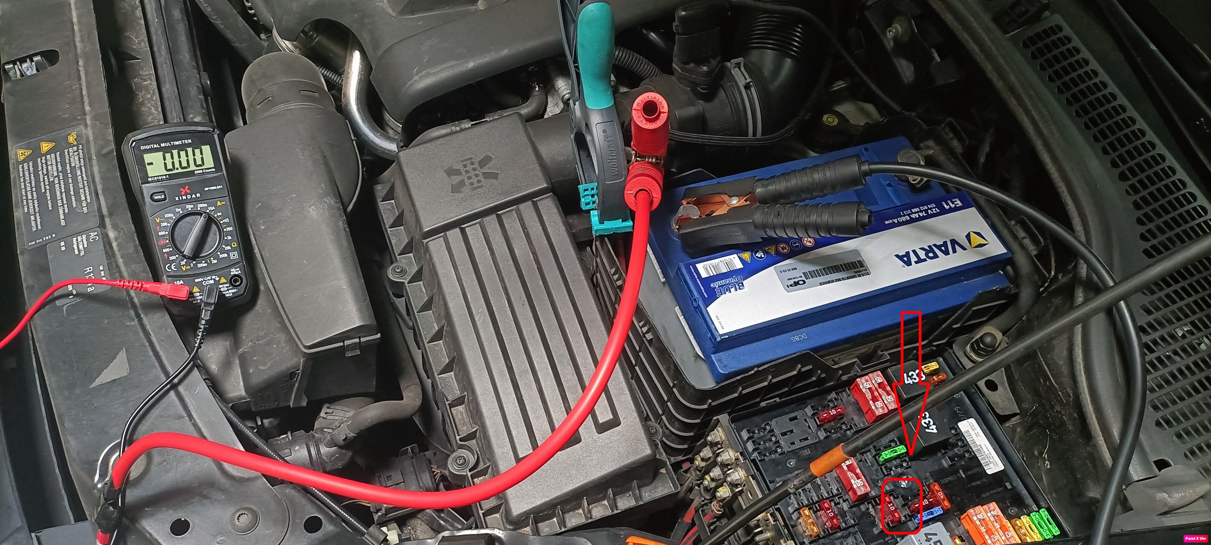

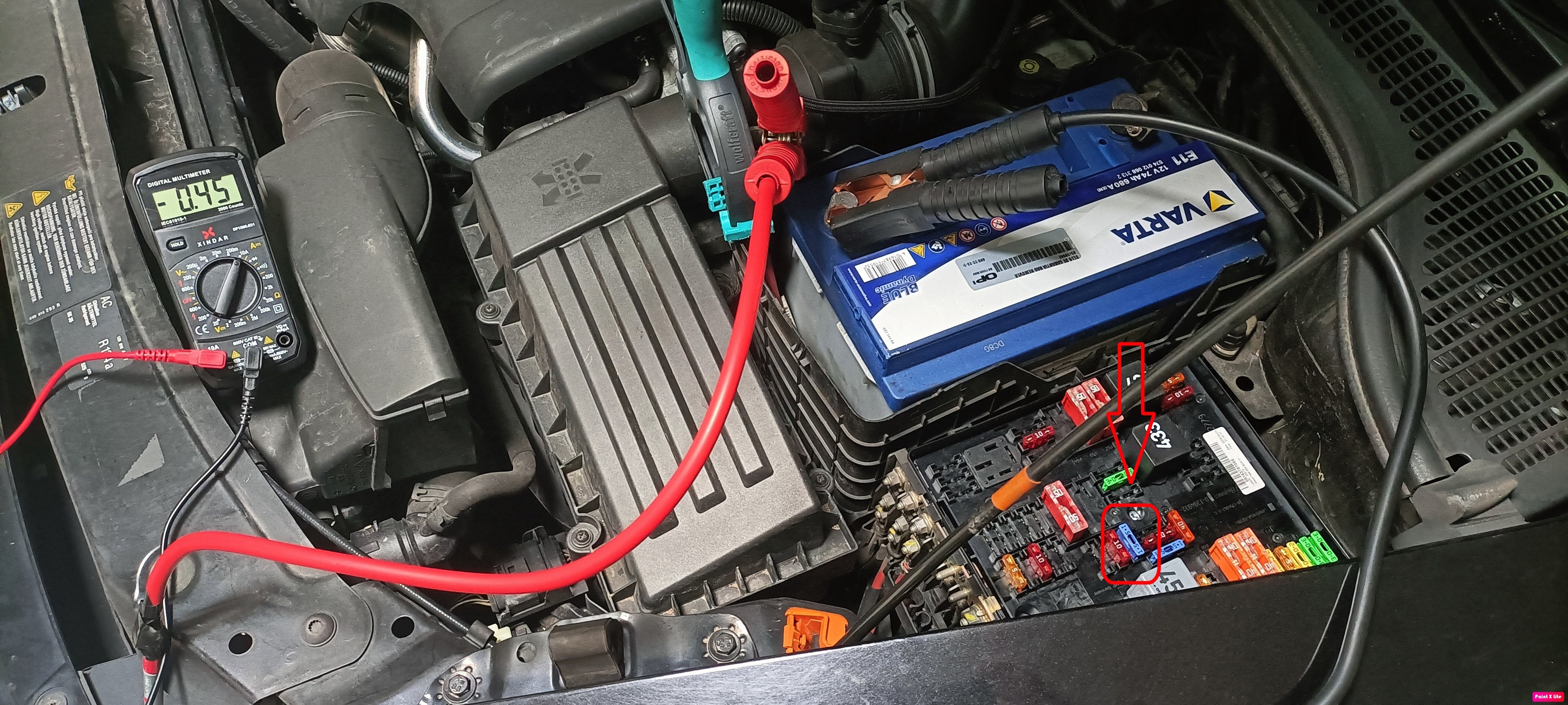

  3. Hi guys, news... Changed the fuse, the drain continues. So it's not the fuse. Unplug all the plugs in the back of the radio, one by one and only i unplug the power the drain is over. So the conclusion it's the radio that does this consumption. Any more ideas?

  7. I just get the fuse and replace it. More news to come...
  8. No, this battery drain happens when the ignition is OFF. No key in the car.
  9. Yes. i've posted pictures with and without the fuse.

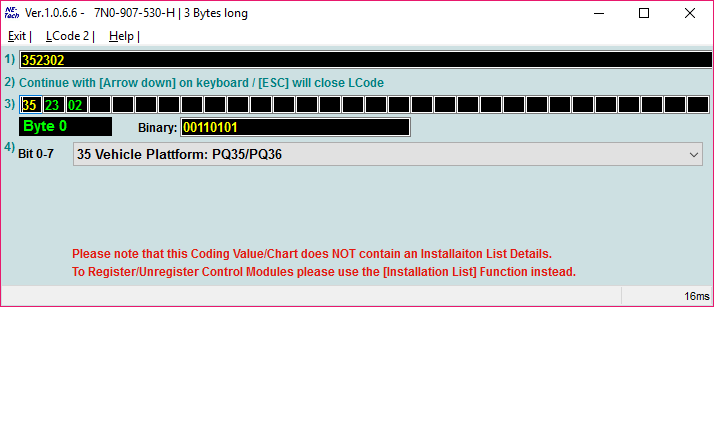

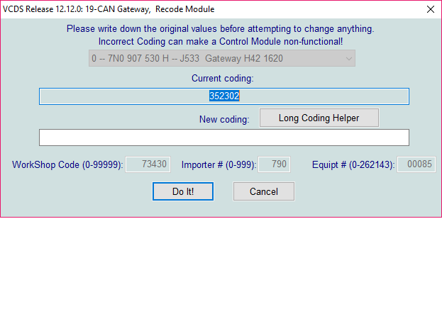

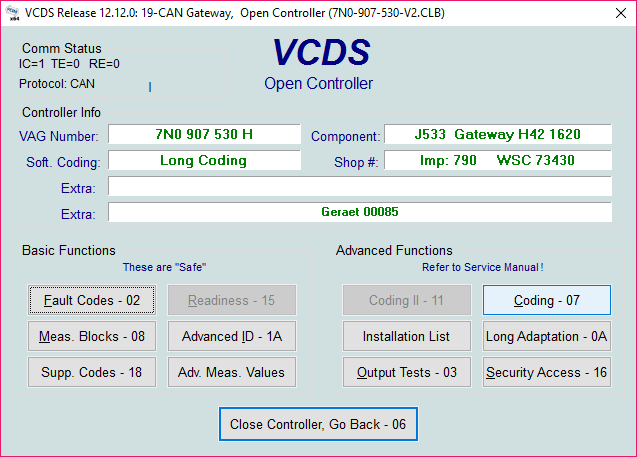

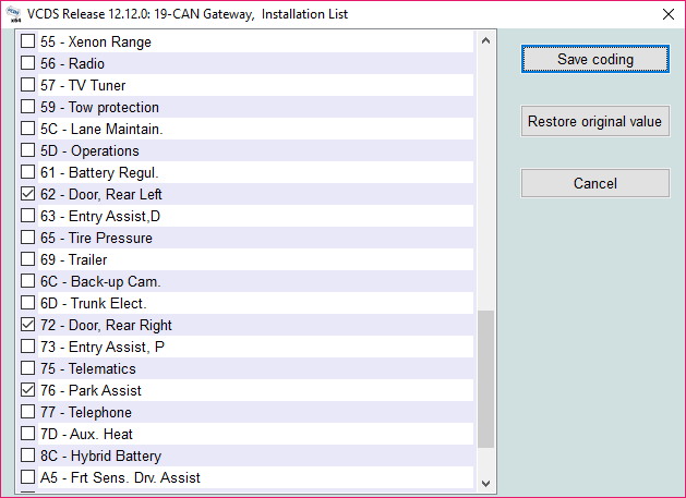

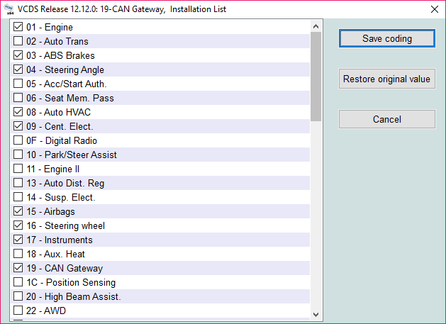

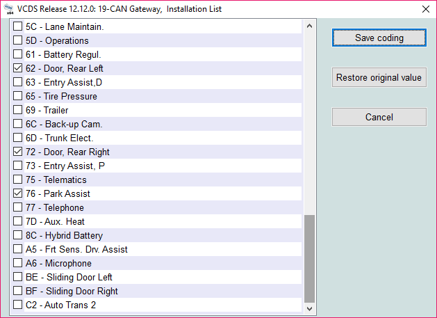

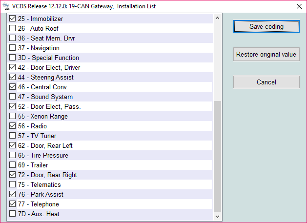

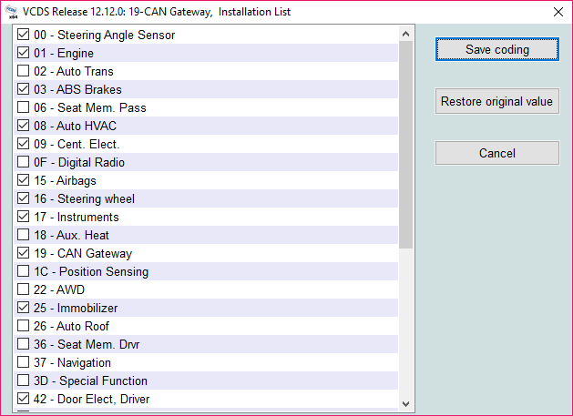

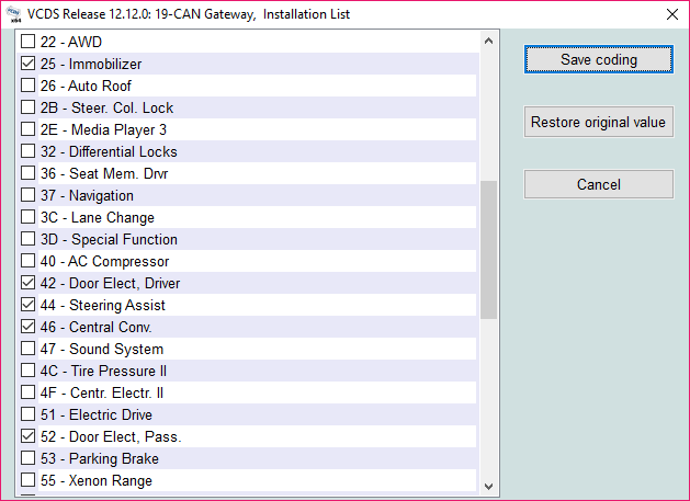

  10. Hi, i've only got the time now to have this done. So, about the radio tick when i untick the thing it gives me an error on the gateway. Address 19: CAN Gateway (J533) Labels: 7N0-907-530-V2.clb Part No SW: 7N0 907 530 H HW: 1K0 907 951 Component: J533 Gateway H42 1620 Revision: H42 Serial number: 070911F1002505 Coding: 352302 Shop #: WSC 73430 790 00085 VCID: 3561C75F9CB4ADB6775-8060 1 Fault Found: 01044 - Control Module Incorrectly Coded 000 - - Freeze Frame: Fault Status: 01100000 Fault Priority: 1 Fault Frequency: 1 Reset counter: 255 Mileage: 191567 km Time Indication: 0 Date: 2000.00.00 Time: 12:16:43 So i think this needs to be ticked. This is what i've got now: 01-Engine -- Status: OK 0000 03-ABS Brakes -- Status: OK 0000 04-Steering Angle -- Status: OK 0000 08-Auto HVAC -- Status: OK 0000 09-Cent. Elect. -- Status: OK 0000 15-Airbags -- Status: OK 0000 16-Steering wheel -- Status: Malfunction 0010 17-Instruments -- Status: OK 0000 19-CAN Gateway -- Status: OK 0000 25-Immobilizer -- Status: OK 0000 42-Door Elect, Driver -- Status: OK 0000 44-Steering Assist -- Status: OK 0000 46-Central Conv. -- Status: OK 0000 52-Door Elect, Pass. -- Status: OK 0000 56-Radio -- Status: Malfunction 0010 62-Door, Rear Left -- Status: OK 0000 72-Door, Rear Right -- Status: OK 0000 76-Park Assist -- Status: OK 0000 77-Telephone -- Status: Malfunction 0010 ------------------------------------------------------------------------------- Address 16: Steering wheel Labels: 1K0-953-549-MY8.lbl Part No SW: 1K0 953 549 G HW: 1K0 953 549 G Component: Lenks‰ulenmodul 021 0050 Coding: 0002042 Shop #: WSC 73430 790 00000 VCID: 3663C05341B2A6AE7EF-8063 Subsystem 1 - Part No: XXXXXXXXXXX Component: Lenkradmodul 007 0050 1 Fault Found: 00888 - Wiper Switch for Intermittent Operation (E22) 014 - Defective - Intermittent ------------------------------------------------------------------------------- Address 56: Radio Cannot be reached ------------------------------------------------------------------------------- Address 77: Telephone Labels: 5P0-862-335.lbl Part No SW: 5P0 862 335 HW: 5P0 862 335 Component: FSE_2P5x H18 0030 Revision: 00000001 Serial number: 00000000188674 Coding: 0000422 Shop #: WSC 73430 790 00000 VCID: F0EFB64BE356489EE43-80A5 1 Fault Found: 01523 - Microphone for Telephone (R38) 011 - Open Circuit Freeze Frame: Fault Status: 01111011 Fault Priority: 5 Fault Frequency: 1 Reset counter: 62 Mileage: 191567 km Time Indication: 0 Date: 2000.00.00 Time: 12:25:00 So ignoring the telephone because it could be that i disconnected the original microphone, i've got only the Steering wheel problem and the radio not reachable. Measuring the battery with the new multimeter it seems that the problem is yet not solved. Same as before, but with a new CAN Gateway, the battery is drained by 0,45 amps. Pictures below: This is the measure with the radio fuse ON (Arrow in the picture): This is the measure with the radio fuse OFF (Arrow in the picture): As you can see the drain continues... Cheers.
  11. Hi, Just did the tick on telephone and radio and like you said the CAN Gateway error disappeared. This is the status of the thing: 01-Engine -- Status: OK 0000 03-ABS Brakes -- Status: OK 0000 04-Steering Angle -- Status: OK 0000 08-Auto HVAC -- Status: OK 0000 09-Cent. Elect. -- Status: OK 0000 15-Airbags -- Status: OK 0000 16-Steering wheel -- Status: Malfunction 0010 17-Instruments -- Status: OK 0000 19-CAN Gateway -- Status: OK 0000 25-Immobilizer -- Status: OK 0000 42-Door Elect, Driver -- Status: OK 0000 44-Steering Assist -- Status: OK 0000 46-Central Conv. -- Status: OK 0000 52-Door Elect, Pass. -- Status: OK 0000 56-Radio -- Status: Malfunction 0010 62-Door, Rear Left -- Status: OK 0000 72-Door, Rear Right -- Status: OK 0000 76-Park Assist -- Status: OK 0000 77-Telephone -- Status: Malfunction 0010 The Malfuntions: ------------------------------------------------------------------------------- Address 16: Steering wheel Labels: 1K0-953-549-MY8.lbl Part No SW: 1K0 953 549 G HW: 1K0 953 549 G Component: Lenks‰ulenmodul 021 0050 Coding: 0002042 Shop #: WSC 73430 790 00000 VCID: 3663C05341B2A6AE7EF-8063 Subsystem 1 - Part No: XXXXXXXXXXX Component: Lenkradmodul 007 0050 1 Fault Found: 00888 - Wiper Switch for Intermittent Operation (E22) 014 - Defective ------------------------------------------------------------------------------- Address 56: Radio Cannot be reached ------------------------------------------------------------------------------- Address 77: Telephone Labels: 5P0-862-335.lbl Part No SW: 5P0 862 335 HW: 5P0 862 335 Component: FSE_2P5x H18 0030 Revision: 00000001 Serial number: 00000000188674 Coding: 0000422 Shop #: WSC 73430 790 00000 VCID: F0EFB64BE356489EE43-80A5 1 Fault Found: 01523 - Microphone for Telephone (R38) 011 - Open Circuit Freeze Frame: Fault Status: 01101011 Fault Priority: 5 Fault Frequency: 1 Reset counter: 12 Mileage: 191274 km Time Indication: 0 Date: 2000.00.00 Time: 12:33:37 About the microphone i've replaced the microphone by an external one and i've just used the same bay. Probably its detecting that the old micro is no longer there. About the radio like you suggested i will not do anything. Regarding the wiper switch (i don't know what this is) i need to investigate further because i've not tested the wipers. neither front neither in the back. Any lights would be appreciated. Cheers.
  12. Hi, i've remove the tick from the Installation List because it was giving me errors and also the error from the gateway was there. For example when i had the Telephone ticked this was the error that appear: ------------------------------------------------------------------------------- Address 77: Telephone Labels: 5P0-862-335.lbl Part No SW: 5P0 862 335 HW: 5P0 862 335 Component: FSE_2P5x H18 0030 Revision: 00000001 Serial number: 00000000188674 Coding: 0000422 Shop #: WSC 73430 790 00000 VCID: F0EFB64BE356489EE43-80A5 1 Fault Found: 01523 - Microphone for Telephone (R38) 011 - Open Circuit Freeze Frame: Fault Status: 01101011 Fault Priority: 5 Fault Frequency: 1 Reset counter: 12 Mileage: 191274 km Time Indication: 0 Date: 2000.00.00 Time: 12:33:37 This was the Installation List before i've changed the gateway: So the Radio and the Telephone are there but with the new one it gave me different errors. What should i do? Should i tick the radio and the telephone? Cheers.
