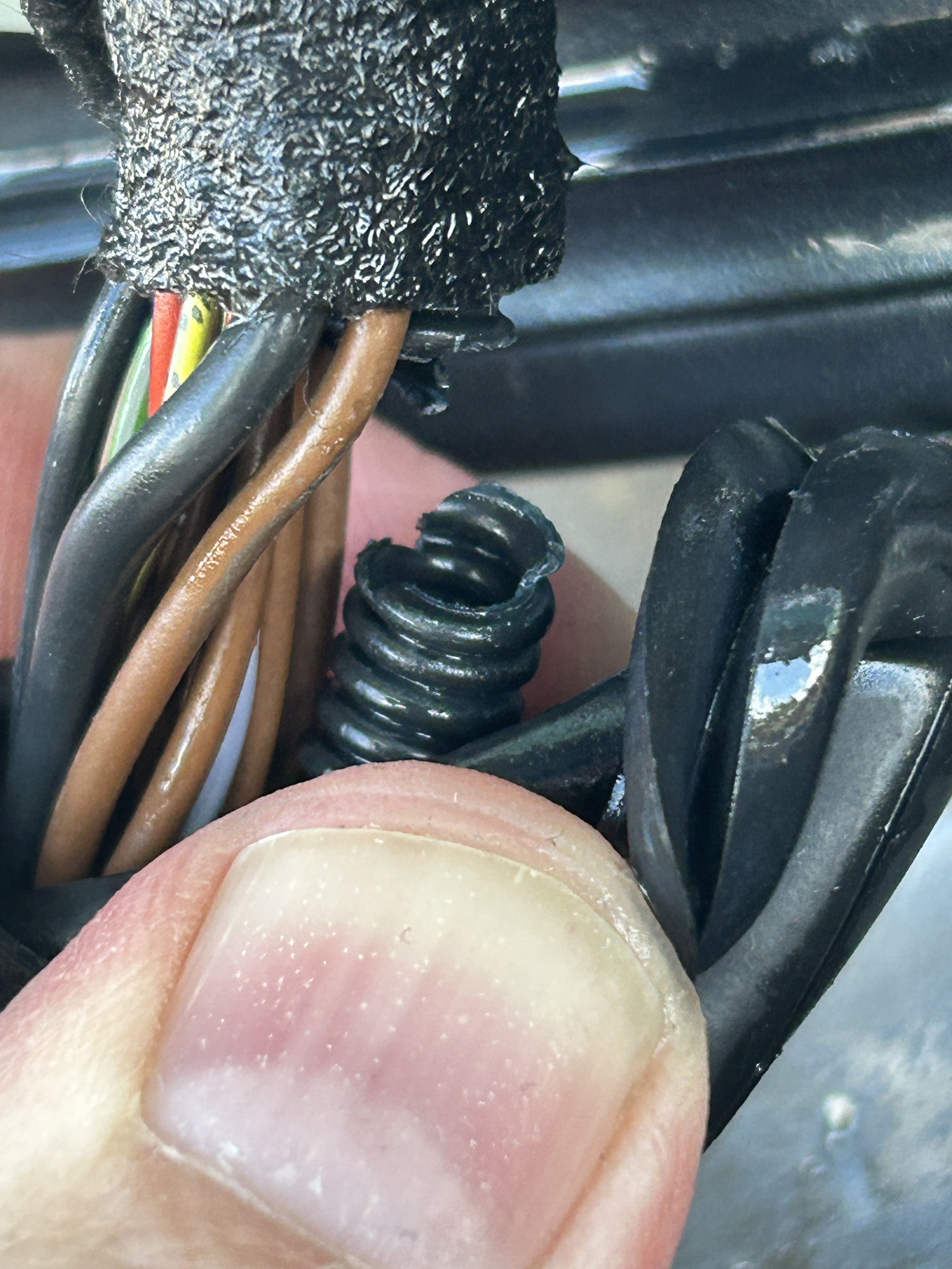

  1. It is indeed the spiral trunking thing that’s split. The forked tongue thing you mention is just the trim to push it back into the metalwork.
  2. These 2 bits should be attached. Will try to join with another pipe thing.
  3. I’m guessing that’s the bit that’s split and the water runs through it. Thanks
  4. Thank you all for your help. Bought a can of that (wow smells so much nicer than WD40). Cleaned and removed the brake light. All fixed nicely. Grrr. Went inside and removed the cover and found this. How do you fix a broken hose like this ??
