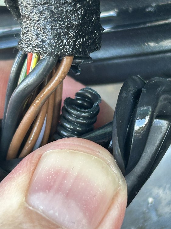

Went inside and removed the cover and found this. How do you fix a broken hose like this ??
Is that black thing a hose then, or do you mean the black sprial trunking or both? For hose or cable you can cut out the broken section and put in a new piece joining at both ends. This can mean going back a longer way one or both ends to get to convenient piont or pionts to fit in the new piece.

Hum "flexible-ish" black plastic tubing, oh dear - progress!
I suppose that you buy a similar product and a suitable joining piece and fit the new tubing to the light/jet and make the join well back inside the body of the car.
Edit:- one version is 6V6 956 663 or another 6V6 956 663 A probably depend on the age of your car, maybe estate pipe is longer, it seems to be quite cheap.
I'd hope that you can find and buy a joining piece so that you can fit the new hose end to the high level brake light housing jet and just splice in a shortish section and form a join back within the car's body area and so well away from the rear hatch hinge point.

I’m guessing that’s the bit that’s split and the water runs through it. Thanks
These 2 bits should be attached. Will try to join with another pipe thing.
Get someone else to operate the rear washer and see if the fluid comes from there, have rag(s) prepared to soak up fluid.
I thought there might be a hose inside that but looking at my thumb now I think I might have had the scale of the photo wrong. 😄
Edited by nta16
It is indeed the spiral trunking thing that’s split.
The forked tongue thing you mention is just the trim to push it back into the metalwork.
