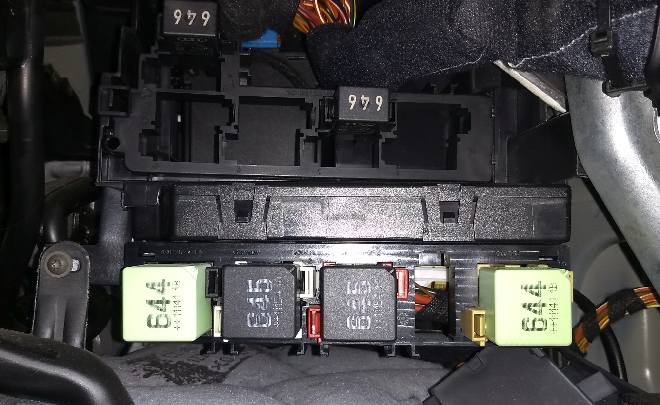

Roy: it's been OK so far, and i suspect the relay swap may have been responsible. The trouble is, merely going in and disturbing things could have caused the issue to go away. My hunch would be try swapping the two relays marked 646 (under the steering wheel). There's still something odd about battery voltages: I'm about to conduct a further experiment with a variable power supply. John

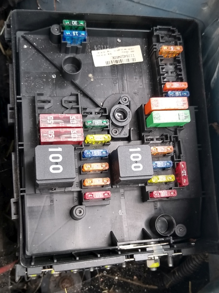

Update. I ended up downloading the schematics from the Skoda database: 2700 pages of pdf. - I've wiggled all the fuses, both boxes, and cross-swapped all the relays with identical type no's. - the battery voltage was slighly low at 12.2(5) volts, so it was given an overnight charge with a CTEK 5A charger. The battery did not make it to the last holding charge state. - after a short time & ignition load the battery voltage dropped back to 12.3 V which is not right for a healthy charged 12V battery, However, the car has not had a problem starting since these interventions, and the stability control icon goes out @ ignition position. I've now fitted a voltmeter module in the cabin, and also swapped out the battery for the one it replaced a couple of years ago. I'll report back if the problem recurs.

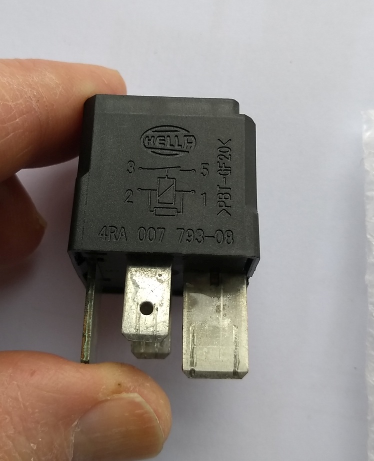

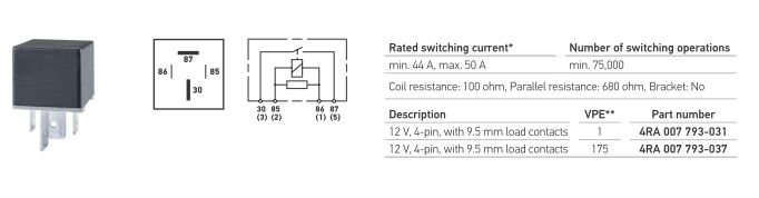

If the car is left for 24 hours+, it will not start on first crank. It's been getting progessiely worse, but to date will eventually start after three or four attempts. After some days of observation i noticed that 1. if the ESP / Tranction control light remained on after a second or two in ignition position, the car would not start. 2. If I waited and it went out, it would start straight away. The garage found one code 01314 suggesting intermittent ecu comms. I've now had a look at fuses & relays, but I can't find a definitive doc showing my particlar relay locations / idents. NB the two under-bonnet 100 relays R1 and R2 are made by Hella and rated at 50A. Can anyone help? It's engine code CDA. I did originallly suspect fuel pump / fuel pump relay but now I'm not so sure.
