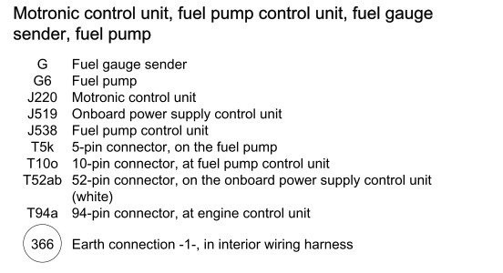

  2. Yes, I think you're right! J538 on RHS

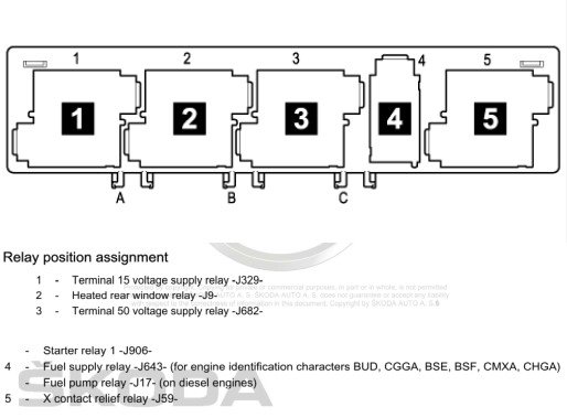

  3. Having trawled through the schematics I have (relating to the CDAA engine code) - it looks like there may be no relay: rather, a fuel pump control unit

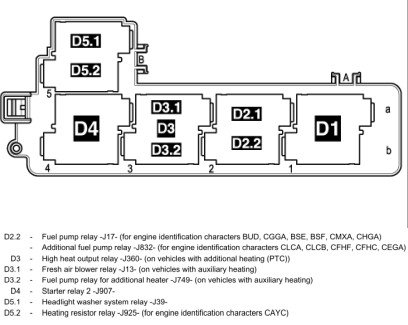

  5. Here's the other bank: both layouts are for RHD Octavia II
  6. This is what I have for the Octavia relays under the dash: D2.2 is listed as fuel pump. But on my car only two of thse relay are present: D5.1 and D2.1, neither labeled as fuel pump! ( 2.1 Horn relay)
