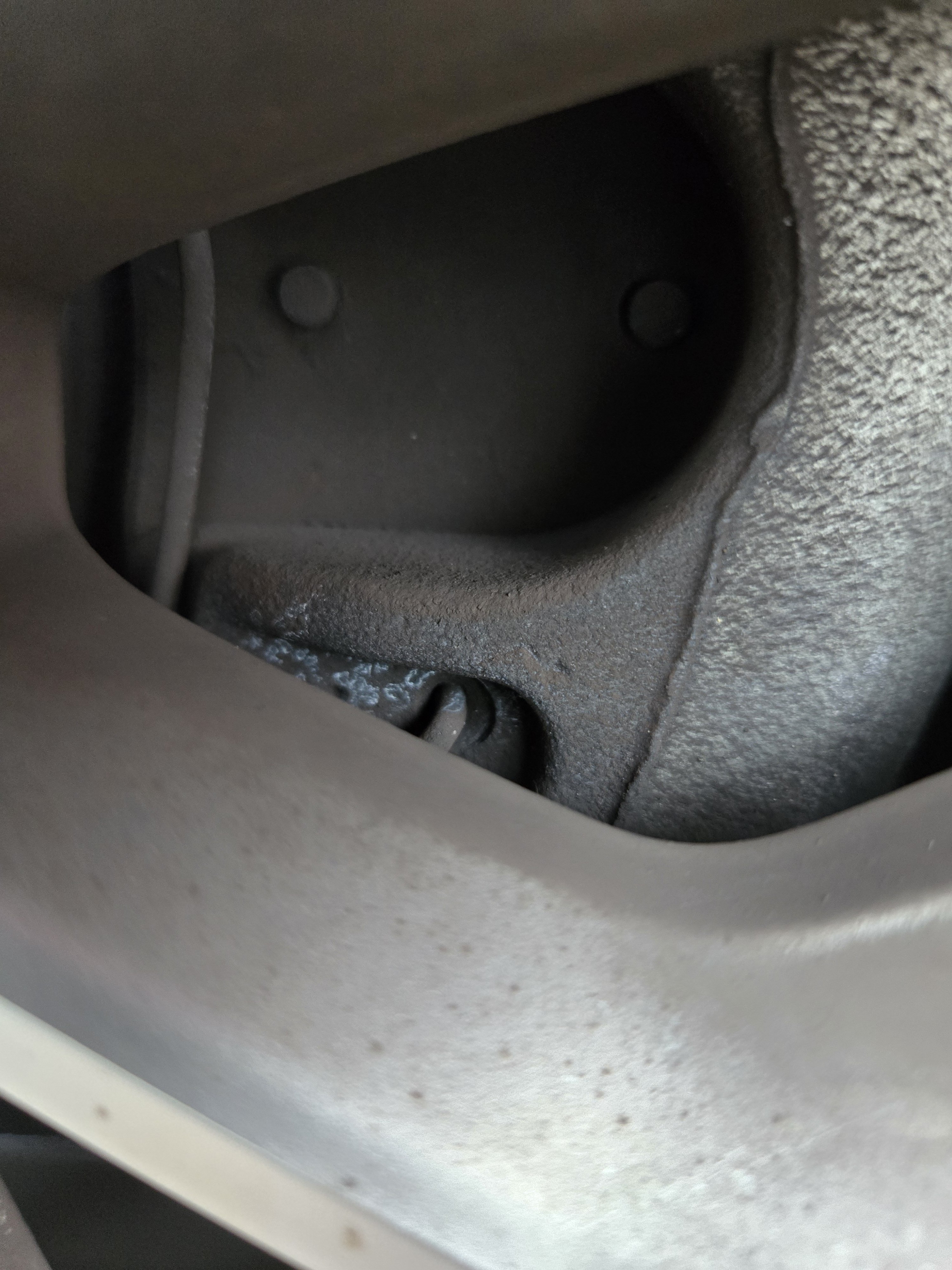

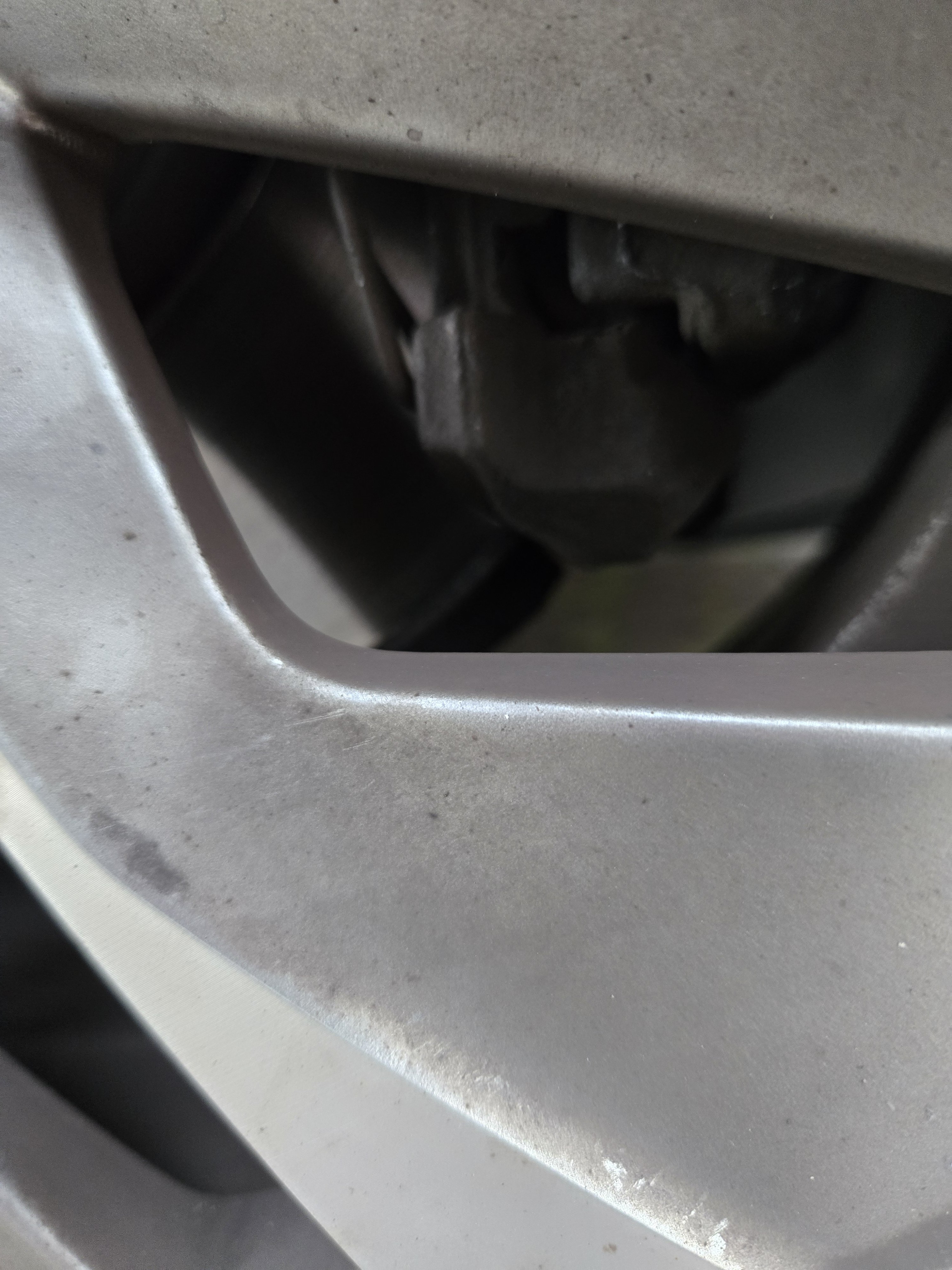

  1. Thanks for the information pab587. My car had 288mm front disks and standard 230mm rear disks
  2. Having trouble trying to find out what size the brake disks are on the front of my 21 plate fabia estate automatic. Hard to see the callipers through the wheels but have added photos through the rims car has 16" wheels and I can share vin number if anyone can find out using that
