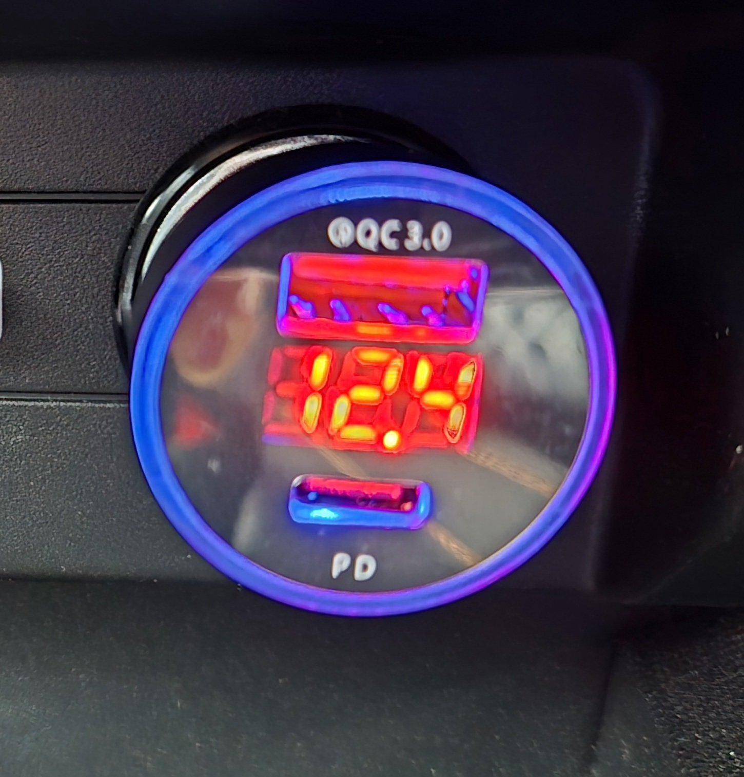

  9. I do have a nextbase 422gw dashcam hard wired in the car (can't remember which fuse it was piggy backed to) will have to check if it was permanent live or ignition live. After a 5 mile drive from home to work the charge on the battery had gone from 11.4v to 12.4v so hopefully it'll be a simple case of moving the dashcam power feed to a fuse that is definitely ignition only once one has been found with a multimeter

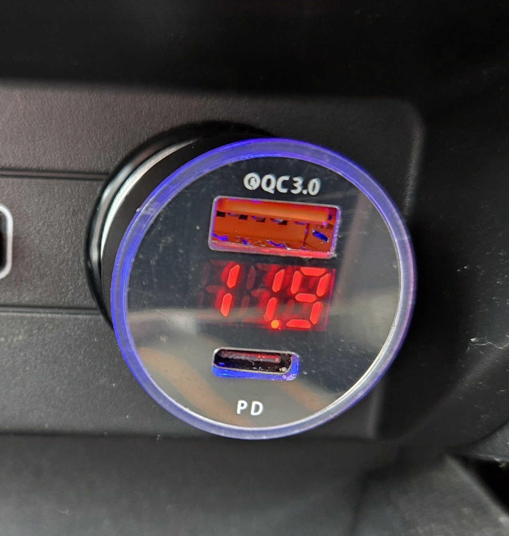

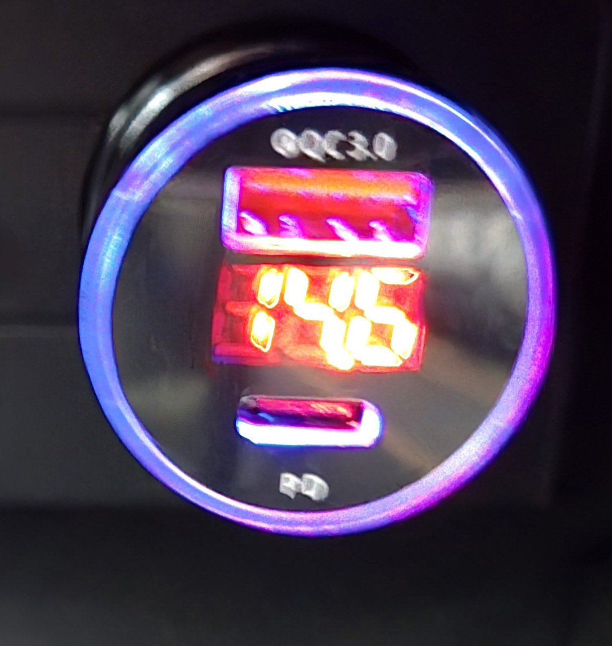

  10. Just as an additional note. Car is a 21 plate 1ltr auto estate. Charge voltage with engine running 14.6v Battery voltage after 5 mile drive 12.4v Battery voltage after sitting for 8.5 hours 11.9v
  11. Ok There's probably been quite a few posts about the batteries on the mk3 fabia forum but for some reason every time I try searching it brings up results for the whole of briskoda. Problem is as follows. I have been getting start stop errors for the last couple of months with and without the emc error light on the dashboard. Most recent it was saying that the voltage was low disabling the start stop system. Just got hold of a cigarette lighter charger that shows the battery level and as can be seen in the attached photos which were taken after the engine was started, when I arrived at work and turned the engine off and before the car was started 8.5hours after leaving work. Unfortunately where I live I have no way of getting a charger connected to the battery on the car and no safe location to put the battery on charge in the house. Driving to and from work is a 10 mile round trip all at motorway speeds and I might get to do a 100 mile round trip on a weekend with the car sitting in between each journey for several hours. Any suggestions about how I sort this one out?

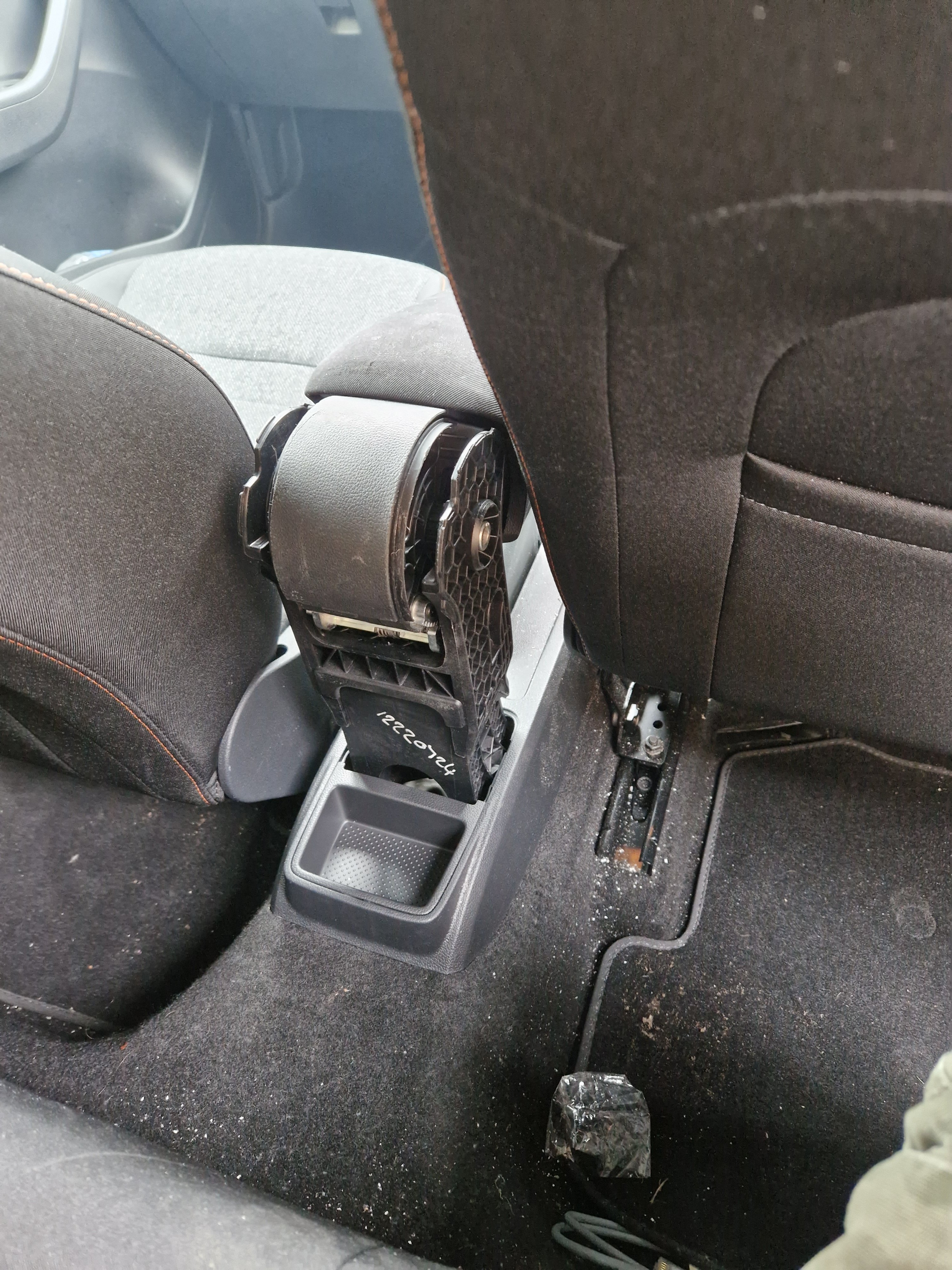

  16. Received the bolt needed to hold the armrest to the base so got it fitted in place. Just got the trim to fit

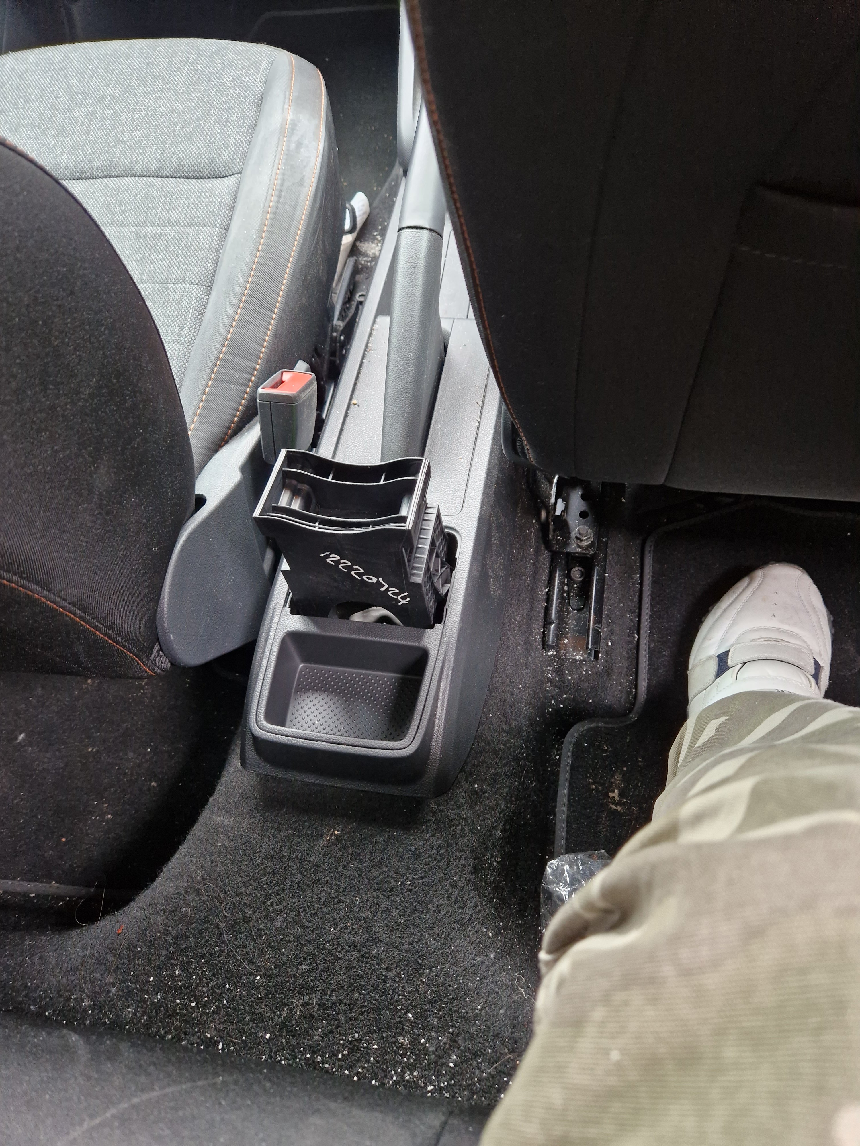

  18. Got the base fitted today after removing all of the screws holding the centre console in place. Still a pain getting it in but it's not moving anywhere now. Realised that bolt number 27 was missing so have ordered it from eBay so should be able to get it finished next weekend

  21. Does anyone know the part number for the smaller tray and the length of the m6 bolts?. Just got an oem armrest on ebay but they didn't supply the tray, bolts or plastic shroud. Managed to find the shroud on ebay after finding the part numbers for them but can't find the tray part number anywhere 😕
  22. Just purchased an original armrest for my mk3 fabia estate from eBay but it came without the plastic covers that go around the 2 sides and the back of the upright that gets fixed to the car. Does anyone know what the part numbers are for these bits of plastic trim are? Also does anyone know what size/type of screw or bolts are used to secure it to the car Cheers in advance
