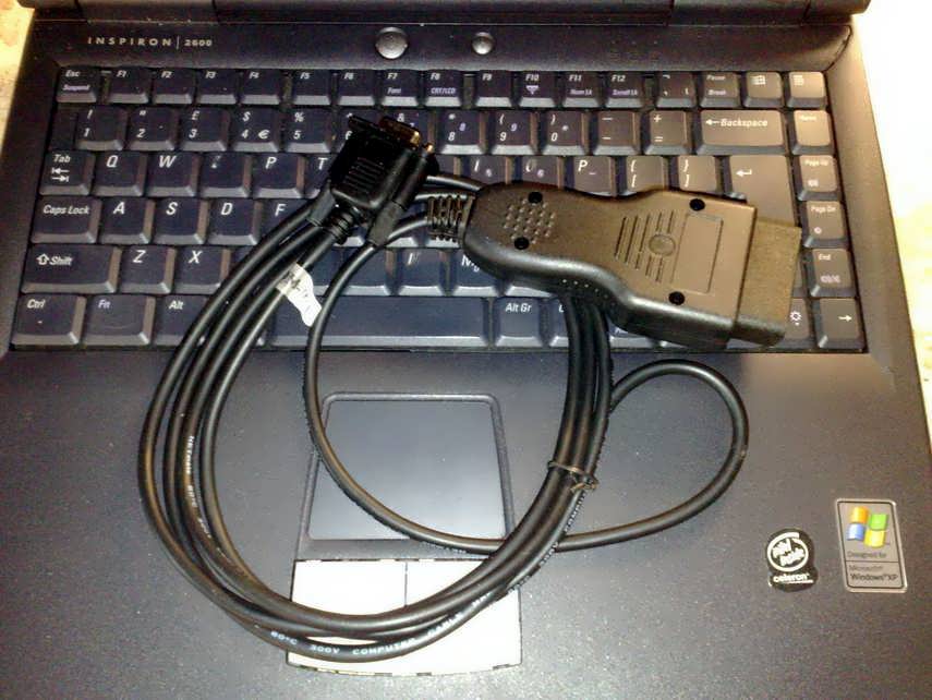

Cable arrived this morning and success. Auto Windows now enabled. Thanks to other posters here for the info. As promised here it is, you lucky people, idiot proof guide to enabling auto windows.
>>> Click For Video Demo <<<
This is going to be extensive only because it's step-by-step - so settle in. :thumbup:
You're going to need.
A Superb

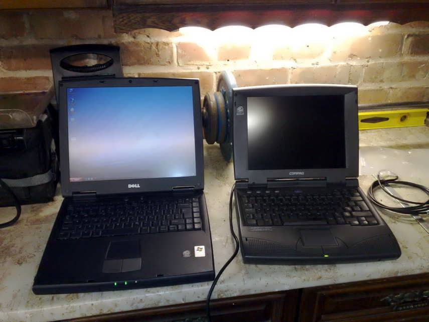

An old laptop, something from biblical times with a serial port on it
A serial cable

1. Connect your serial cable to the laptop and plug the other end into the port under your steering column. Keys in, turn ignition on so dash lights come on. Engine needn't be running.

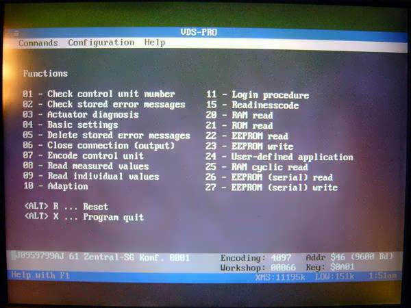

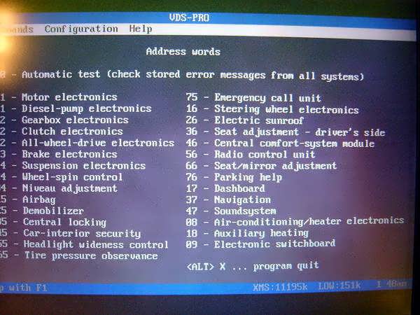

2. Boot up the laptop into a dos environment (you can use a Win98 floppy disc/CD-Rom). Start VDS Pro (use the vag.bat file to launch the program), you'll be hit by this screen.

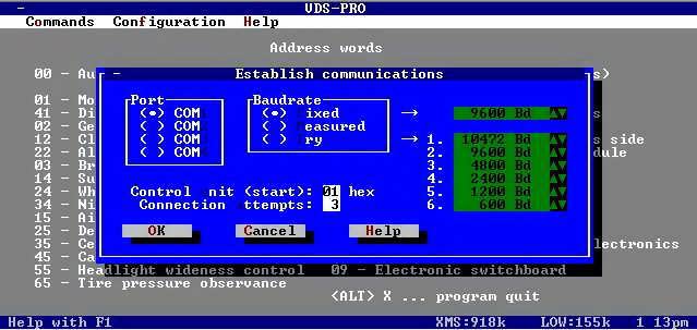

3. Setup VDS to use com port 1 at a fixed baud rate of 9600. Do this by hitting alt+f to bring the configuration menu down, then press alt+c for connextion menu. Should look like this. Configure as shown and select "ok"
You'll be booted back to the screen in step 2, hopefully all will be well and your laptop and car will be communicating well. If not, I can only suggest trying different com ports in the connection menu, however these settings seem to work best with nearly all models.

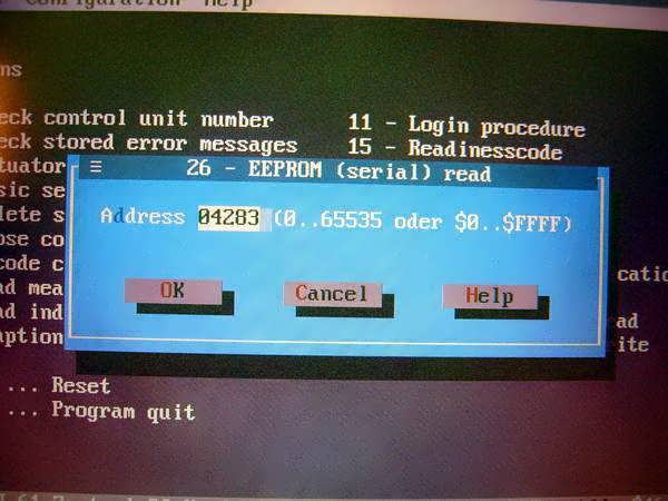

4. Type 46 to connect to central convenience module (CCM). You should be presented with a new screen like below. Your CCM module number is listed on the bottom left hand side of the screen in grey. Check that number against the tables further down this post. If your CCM number is listed you'll find your memory addresses / original values / new values. Only continue if your CCM is listed below.

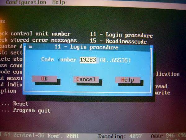

5. Type 11, to begin login procedure. Login with the number 19283

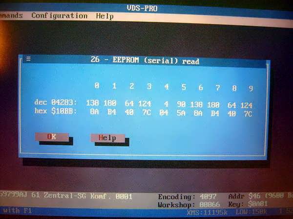

6. Read the current values by typing 26 and entering your corresponding memory address for your particular ccm - again see tables below.
Upon entering the memory address this comes up ... or something similar. Make a note of the original values!. Repeat this step for all memory addresses listed for your CCM.

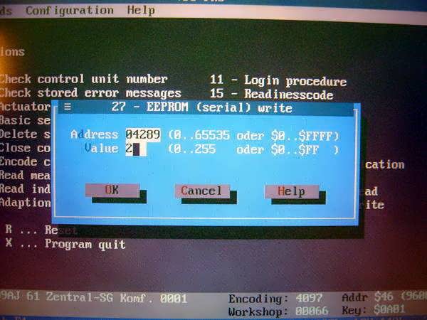

7. Ok so it's time to write new values. Type 27. You'll be asked for a memory address and a value. Again refer to the tables below and double check your figures. Don't just copy the screenshot below!

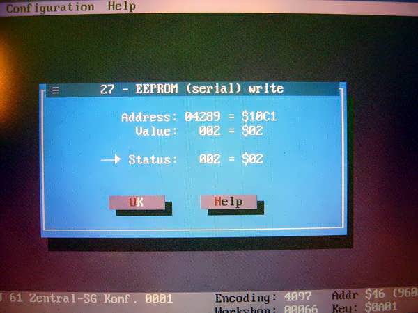

After entering each new value you get a confirmation screen like this. Select ok to exit the confirmation prompt. Repeat this step for each memory address listed for your CCM in the tables below.
8. Once you've done each value, you can disconnect by typing 06 in the CCM menu to get back to the main menu. Then close VDS Pro down altogether. Now unplug everything, exit your car and lock it. When you now open your car with the keyfob and hold the button the windows should start to roll down and stop when you lift your finger. The opposite applies when locking.

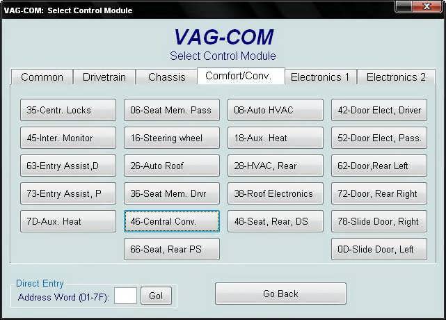

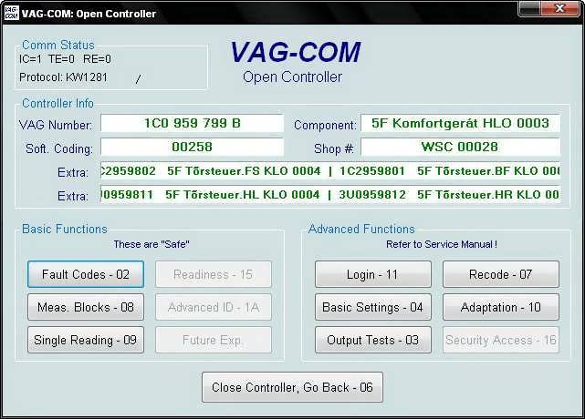

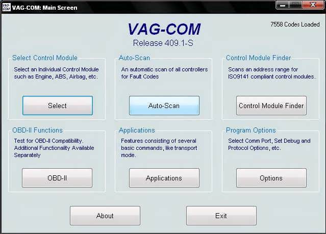

Be careful to make sure your CCM module is listed above. Incidentally someone asked how you can get the CCM module number from VAG-COM.
Start vag-com
Enter "comfort/conv" tab at the top, and select 46 "Central Conv."
CCM number is listed as VAG Number, top left:
