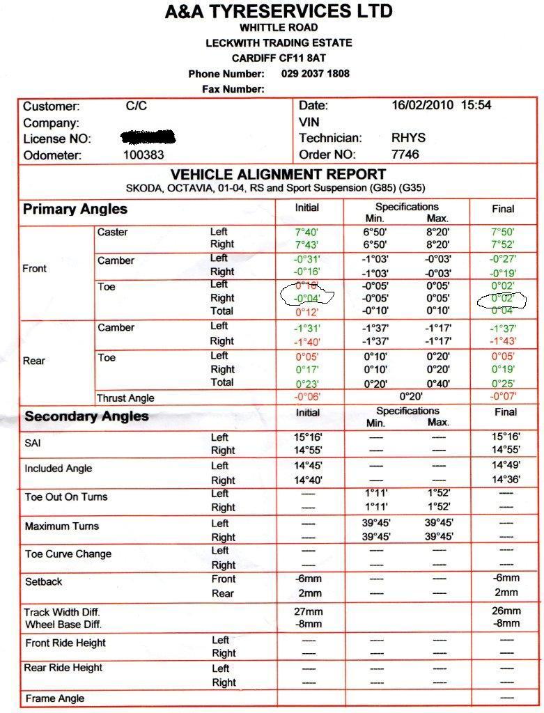

Heres acopy of the printout and I have circled the offending measurement.post-8833-12689950081666_thumb.jpg
I don't really know what a lot of it means to be honest lol
HTH
