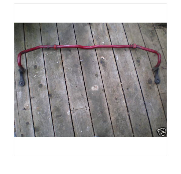

Hi,
I bought Eibach FR ARB anti roll bar 1.8t v5 gti anniversary mk4 from ebay and tried to fit it into my Skoda Octavia VRS. However, the link arms are to long from my car and the ones on the bar are from VW Bora and they are to short.
the code on the bar is eibach q/t 41 85 005 01
Have a bought a wrong part?
Please help.

Yes , the vRS and MK4 Golf 2wd are not the same front ARB
Sorry
Sarah
Great, I hoped I was wrong :-(
sell it on the mk4 forum or on seat cupra.net then buy an r32 front arb which will fit the vrs

This is the ARB for the Octy VRS labelled as item 2A with it's part number highlighted. I have also added the pic of the standard Octy ARB which is item 2 of which is the same design you purchased that is not the correct one.
Many thanks for the very clear explanation.
