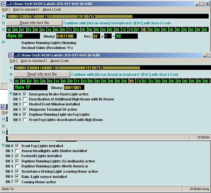

I'm sure others will confirm, but I think most of it is ready as templates/tick boxes in new VCDS:
Don't use the codes from the pic, since these are just randomly grabbed from the net, but it's to illustrate general idea - DLR in scandinavian mode is your typical "Volvo" in action - front and back switch on after turning ignition, in US mode switches on only front lamps and they switch off when hand brake is up, option of using foglights as DLR is in different label, and brightness of them can be tweaked (carefully, since binary values are used).

Piccie has reminded me that I need to ask for Coming Home as well as Cornering Fogs.

ooh, where did you get the piccies from, i'd like to peruse some more pages from the setup.
