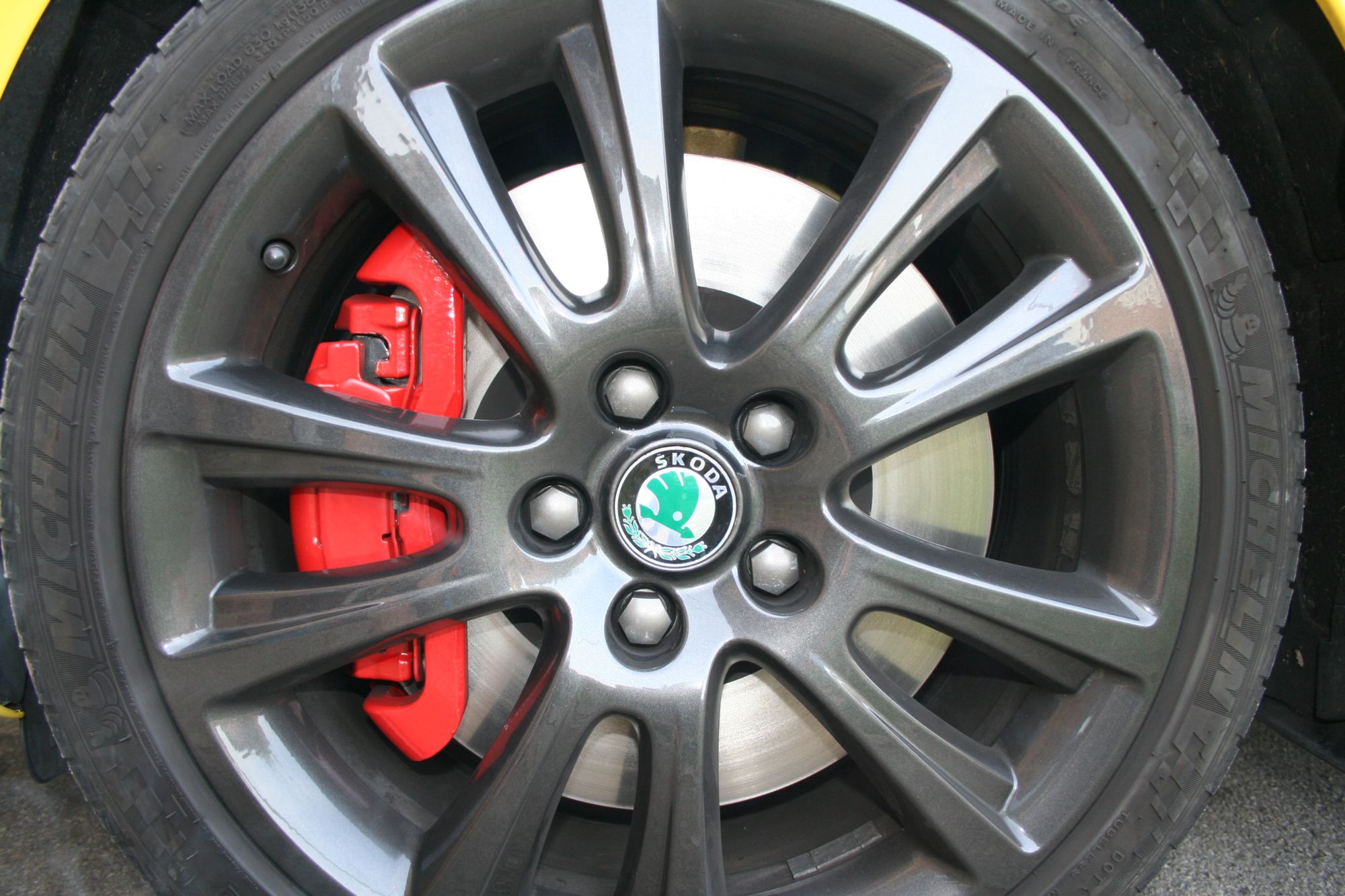

R32/cupra/s3 brake upgrade fits 17'' wheels ?
Hi guys,
I've bean reading this forum for some time now but I haven't posted until now.
I own an octy vrs 2.0tfsi which has 7,5j x17'' et 45 team dynamics pro race 1.2 and I want to upgrade the front brakes to the R32/Cupra/S3 ones.
So my question is will they fit the 17'' wheels or will I need 18'' wheels?
Thank's for your time and for the great info I found on this forum
Alex
There ain't much room on 18 inch rims so i'm not sure if they will fit 17s but someone will tell you.
I've got 17" rims and should be getting a kit soon
They will fit 17" rims. With a 7.5" inch wheel. Normal vRS wheels are only 7" so you will be fine
They fit perfectly under VW 17" Monzas on a Golf GTi which are 7.5" wide.
I've got spacers for my my wheels just because they are 7" but you will be fine
