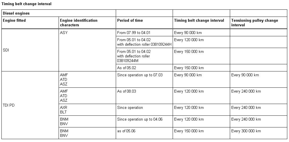

Here is the current service table
Notes:
VAG consider a cambelt change to be a repair item - not a service item.
Get the dealer to do a VIN search to determine the date range that applies to your car. The date is NOT the date of purchase/registration!
If you replace all the cambelt kit items with the latest parts, you can move to the updated service interval.
You can see from the table that in some cases the tensioner needs to be replaced after every other cambelt. My advice is to replace it with every cambelt.
Please note that's appearing as a black rectangle on my screen and when I click on it only the top third of the image is there - please check - and please advise the source
2nd time lucky...
Notes:

Forget the Haynes Manual and hear say you have heard it from one Skoda Tech now another. The latest official Skoda Service Advisors Guide to Cambelt Replacement quotes
Fabia 6Y PD, engine up to July 2003, 4 years or 90.000km (55,000 miles)
August 2003 onwards, 4 years or 120,000km (74,000 miles)
So my facelift (Sept '04) Fabia COULD go well past the 62k I'm worrying about - in terms of mileage, at least. Not that I'm going to, as it'll be 4 years elapsed and fits nicely with the timing other major service work, but even so it makes me that bit more confident.
