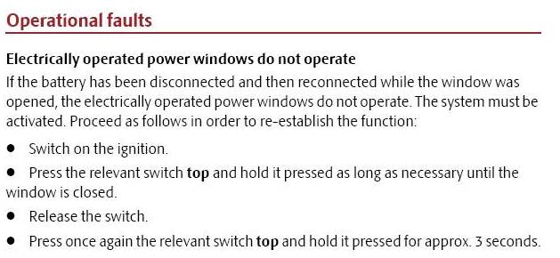

Tried that,still no joy. Then read the manual. The reset sequence is on page 49! and that works.

Ah!!! I knew there was a do-something-twice thing that gets it right! For future reference to anyone searching and finding this post:
