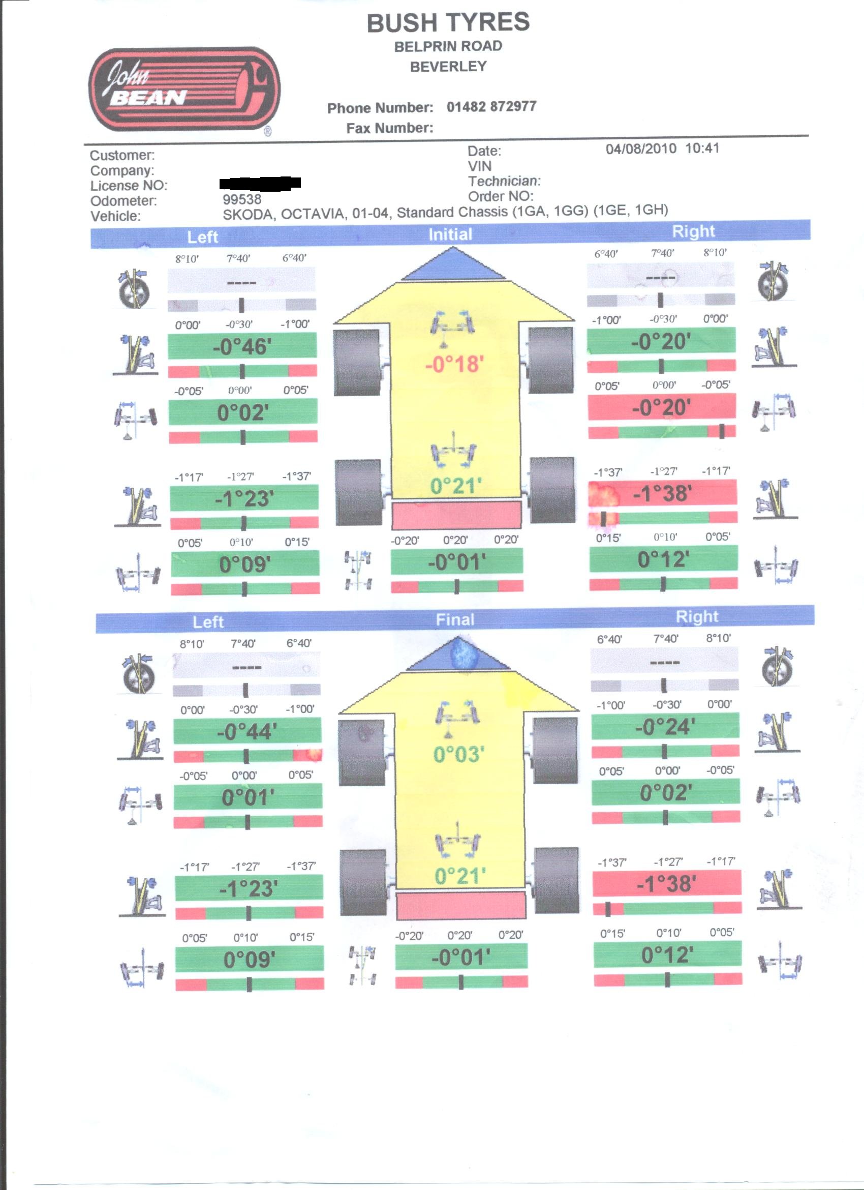

It looks like thrust angle is -0degrees 1 minute. (0d1')
Nearside rear camber is -1 degrees 23'
Offside rear camber is -1 degrees 38'. Spec is apparently -1d17' to -1d37'.
From the diagram I've got all the other values are right in the middle of the ranges given.
So it seems that the rear camber is not as far out as I remembered. Something not right though.
Annoying, I still have to steer slightly left to go straight. However sometimes its straighter than others if you get my meaning. I can't feel any knock through the steering if I steer left or right at a standstill, so I don't think its track rod ends. Would knackered wishbone bushes cause this variability?
Rear toe (total) is +0d21' . Nsr is +0d9', osr is +0d12'.

The static figures seem fine, but the wear pattern is charactoristic of excess RH negative and LH positive camber, or a mis-aligned thrust axis, as is the pull. On that basis I'd say Mikey's got to be right, and worn bushes don't always show up in static geometry checks.

Scanned figures from the last alignment...
