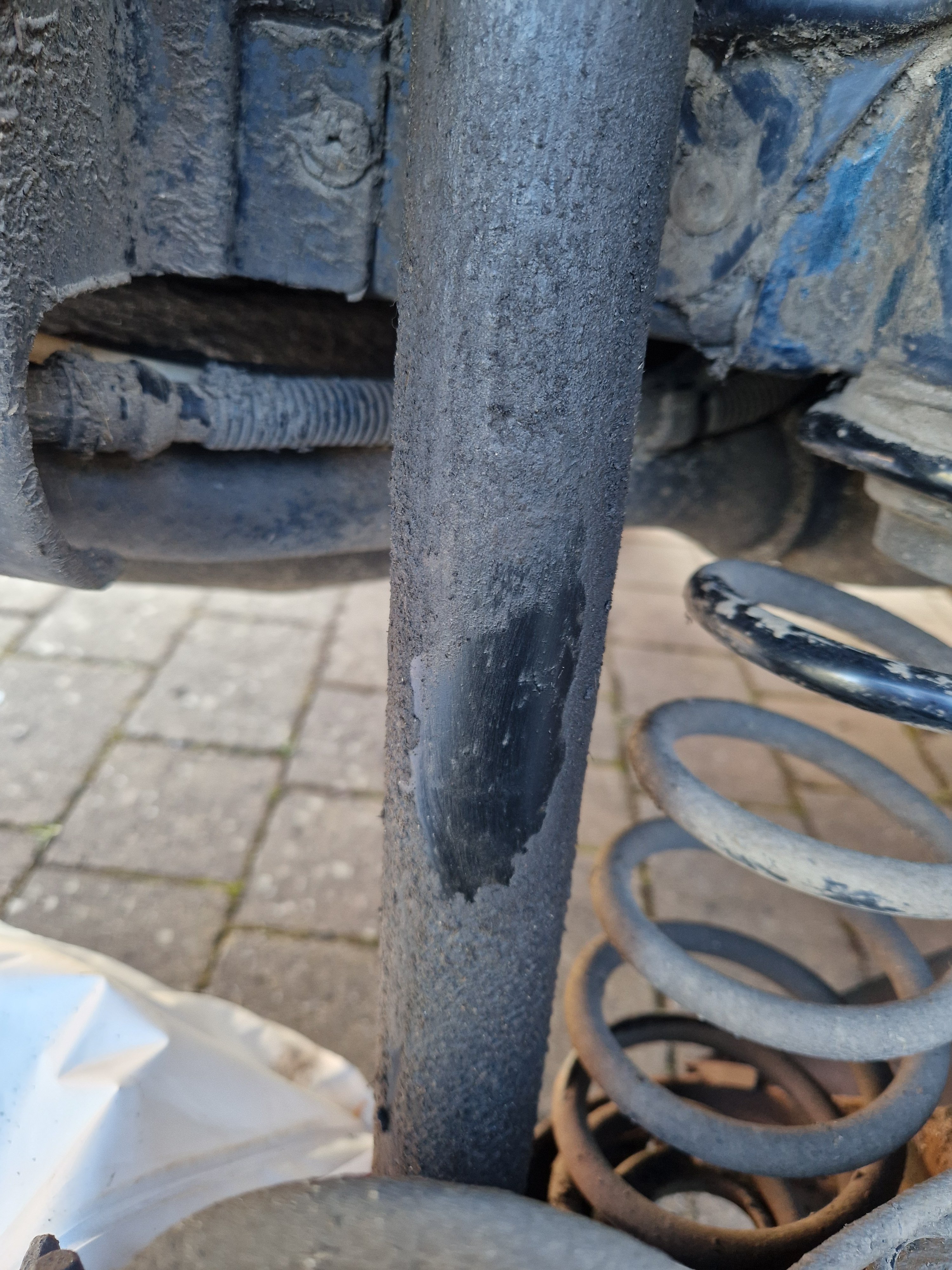

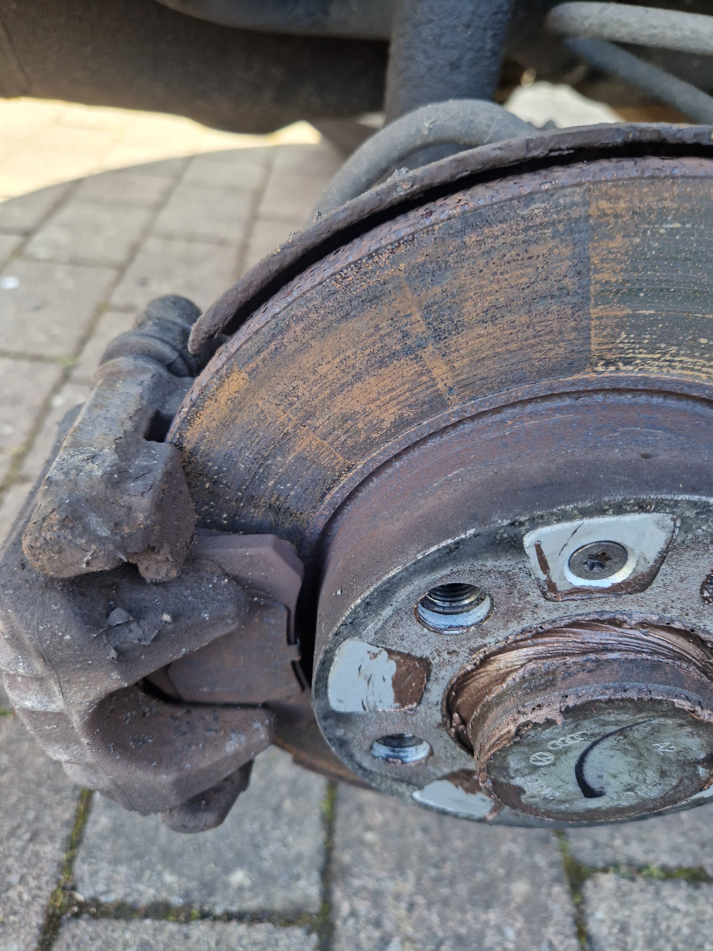

Before I plucked up the courage to sort the oil leak I went round all four corners checking suspension, brakes etc.
Started on right rear for no particular reason.
Disc - original-looking, nasty. Possibly would clean up OK, rear/inner side may be worse.
Pads - well worn but legal
Flexible brake hose has a 'pinch mark' where a clamp had been used a bit unsympathetically, but doesn't look like more than cosmetic damage. (Can just be seen in this shot of the disc below, just to the right of the top of the loop).
Handbrake having uneven effect between sides.

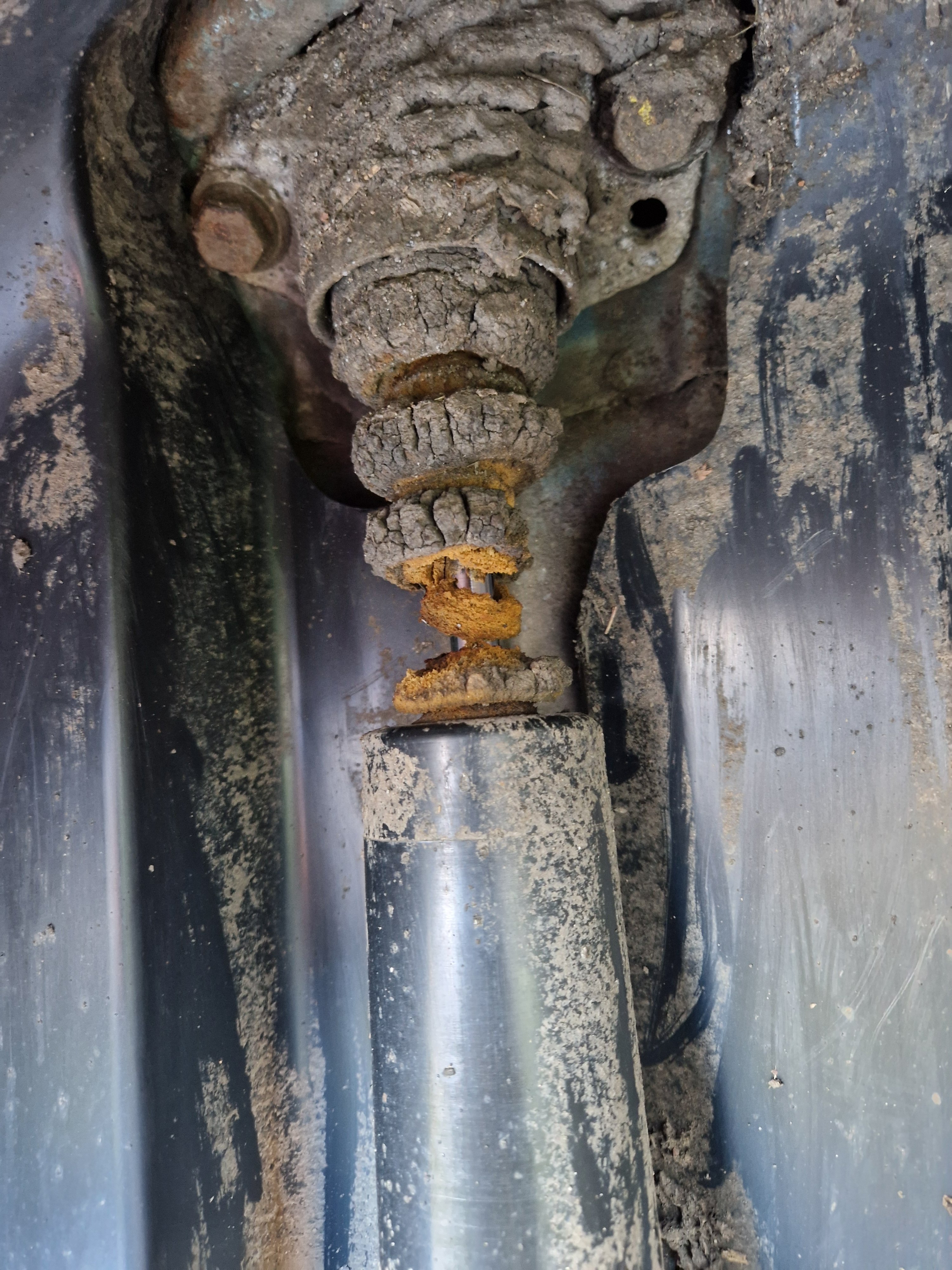

Bump stop, hanging on by a thread!
Shock covered in oil covered in dirt.
Spring looks in good shape.

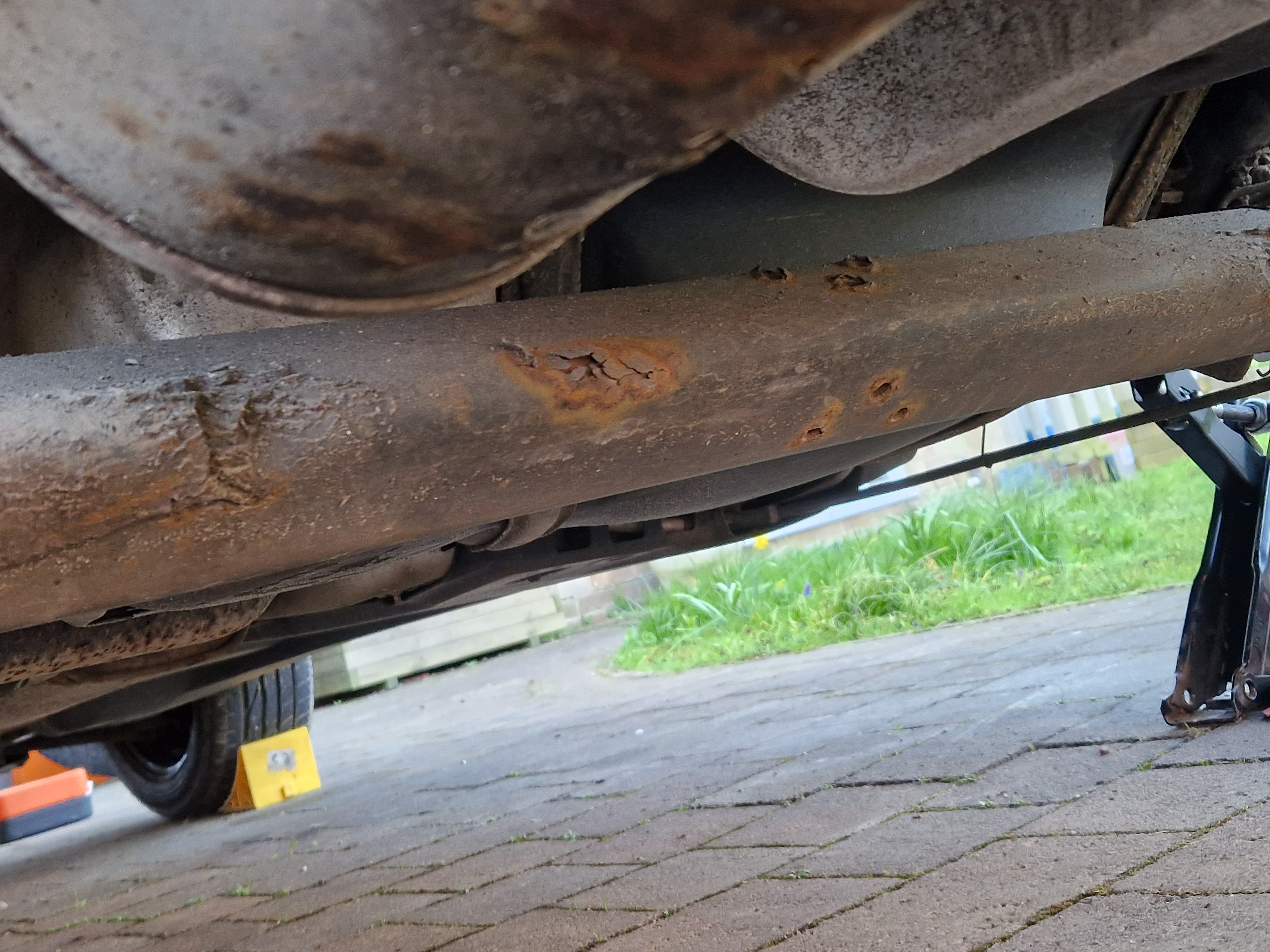

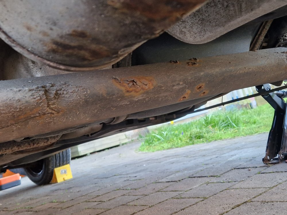

Rear beam has a scab or two that might benefit from treating.

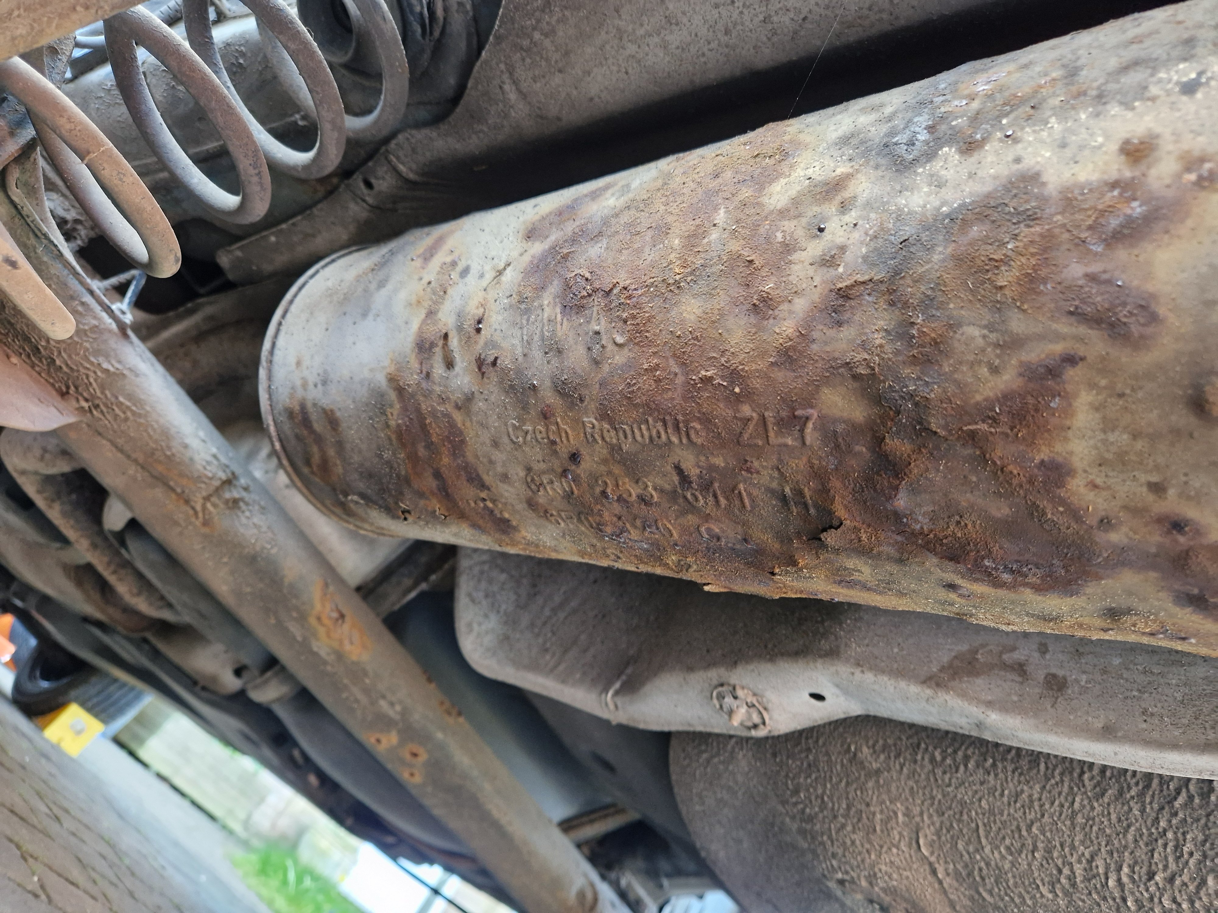

Rear exhaust box looking very original and scabby, continuous pipe including mid silencer, so confirming originality. No obvious leaks currently.

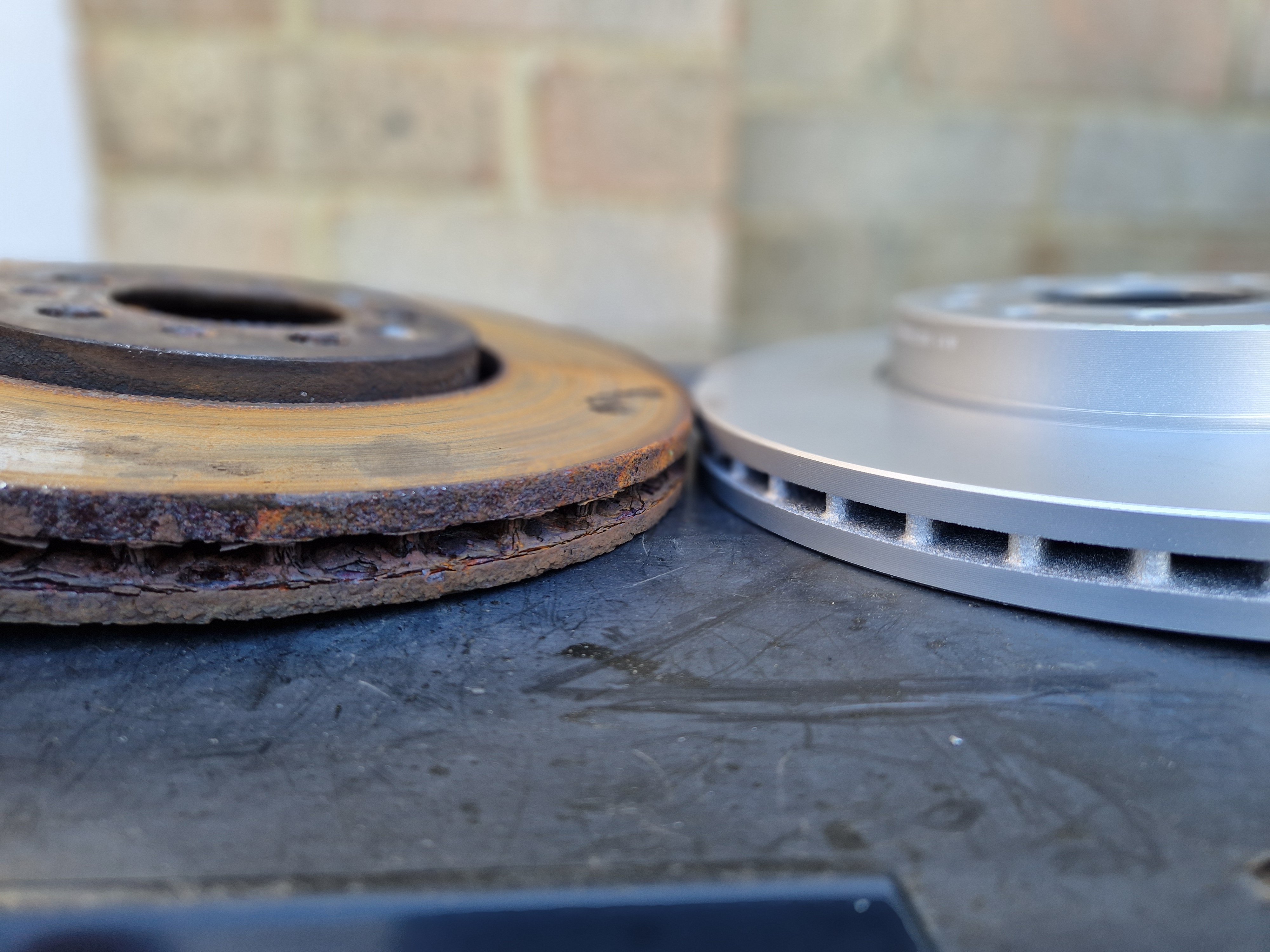

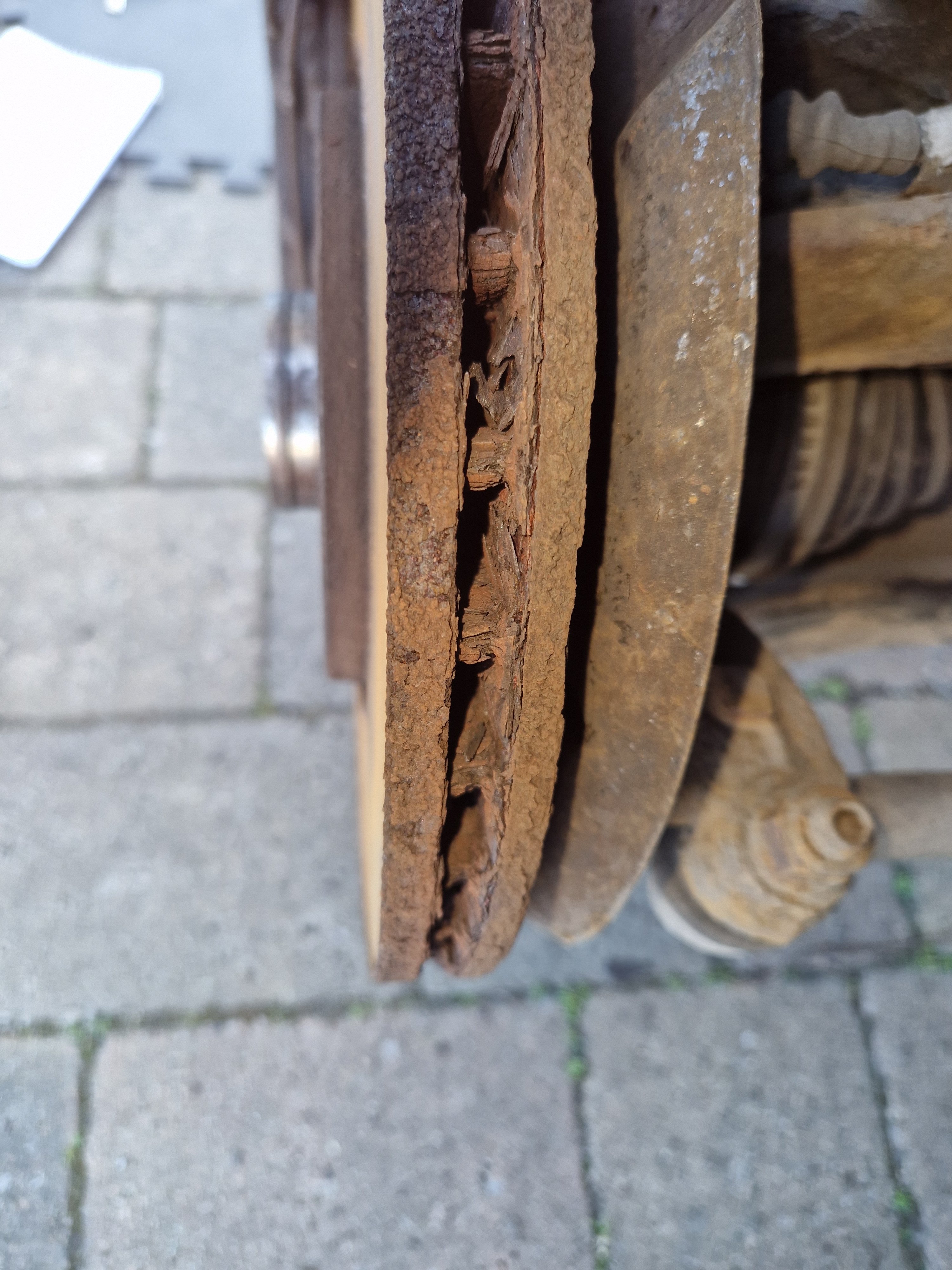

Left front
Not much to note or of concern, except disc looking very old and disintegratey. Probably not actually that close to failure, but not nice looking.
  • Sponsor
Right front

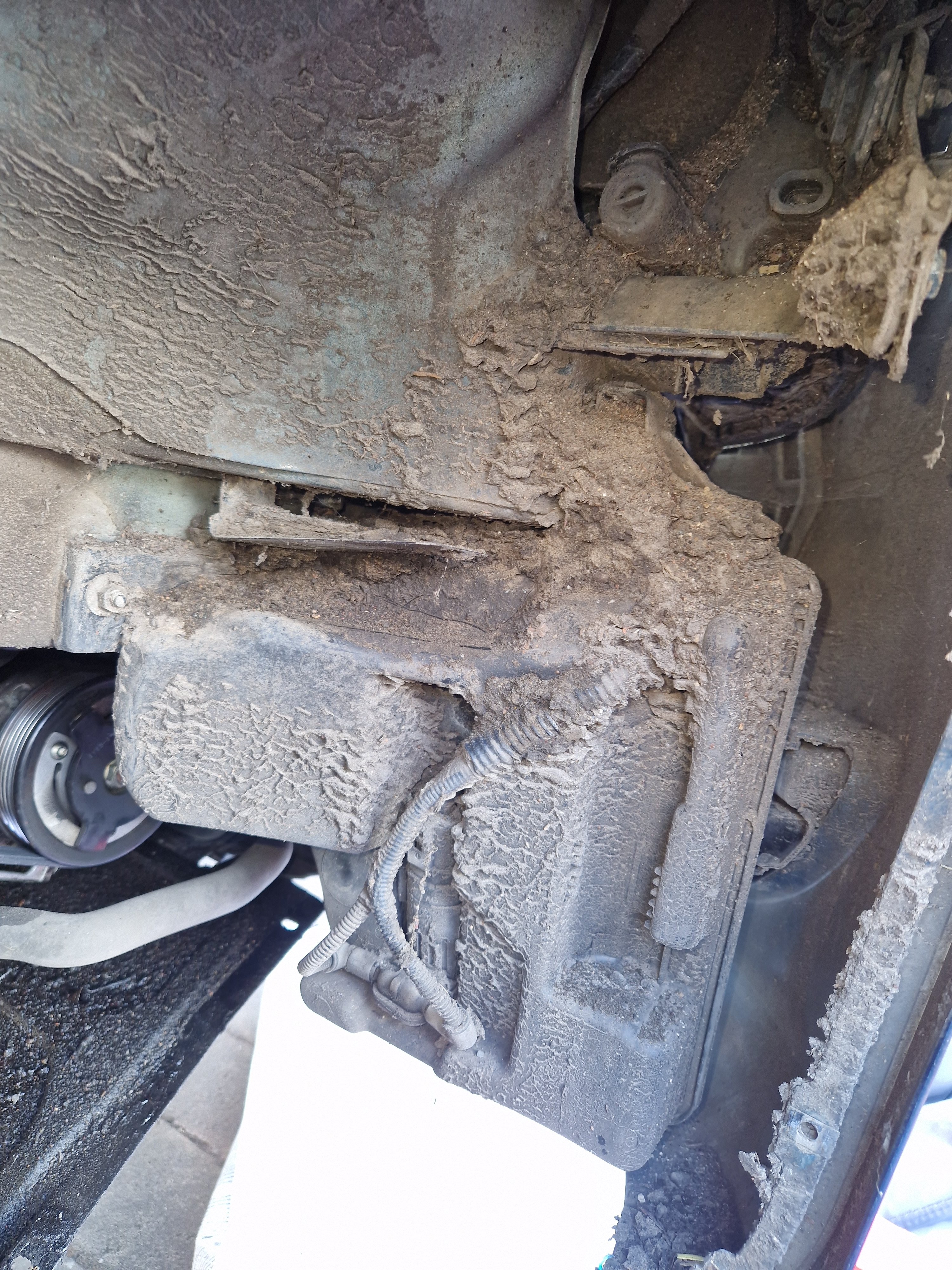

Disc in similar poor condition.
CV grease around, lots of mud around

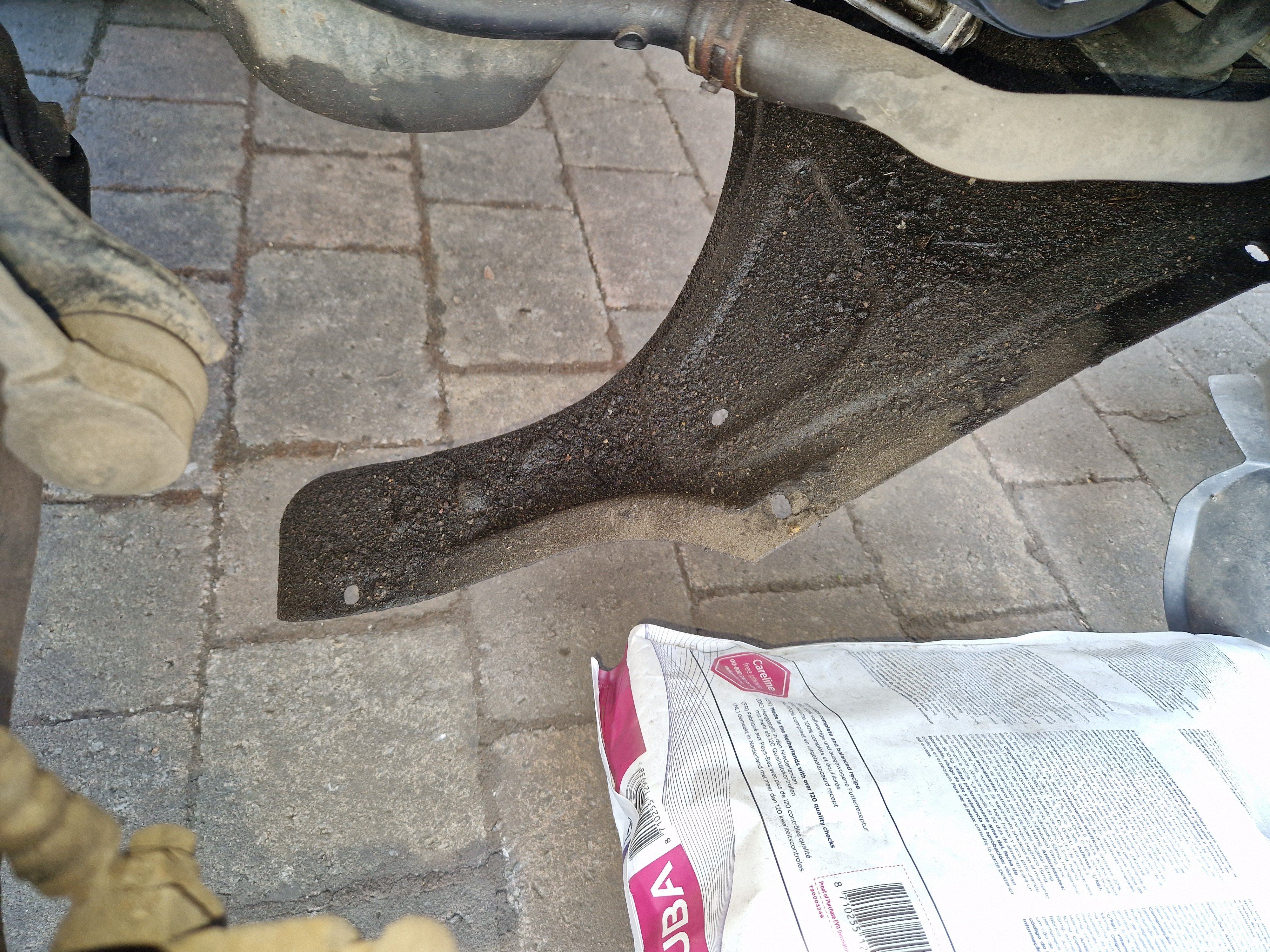

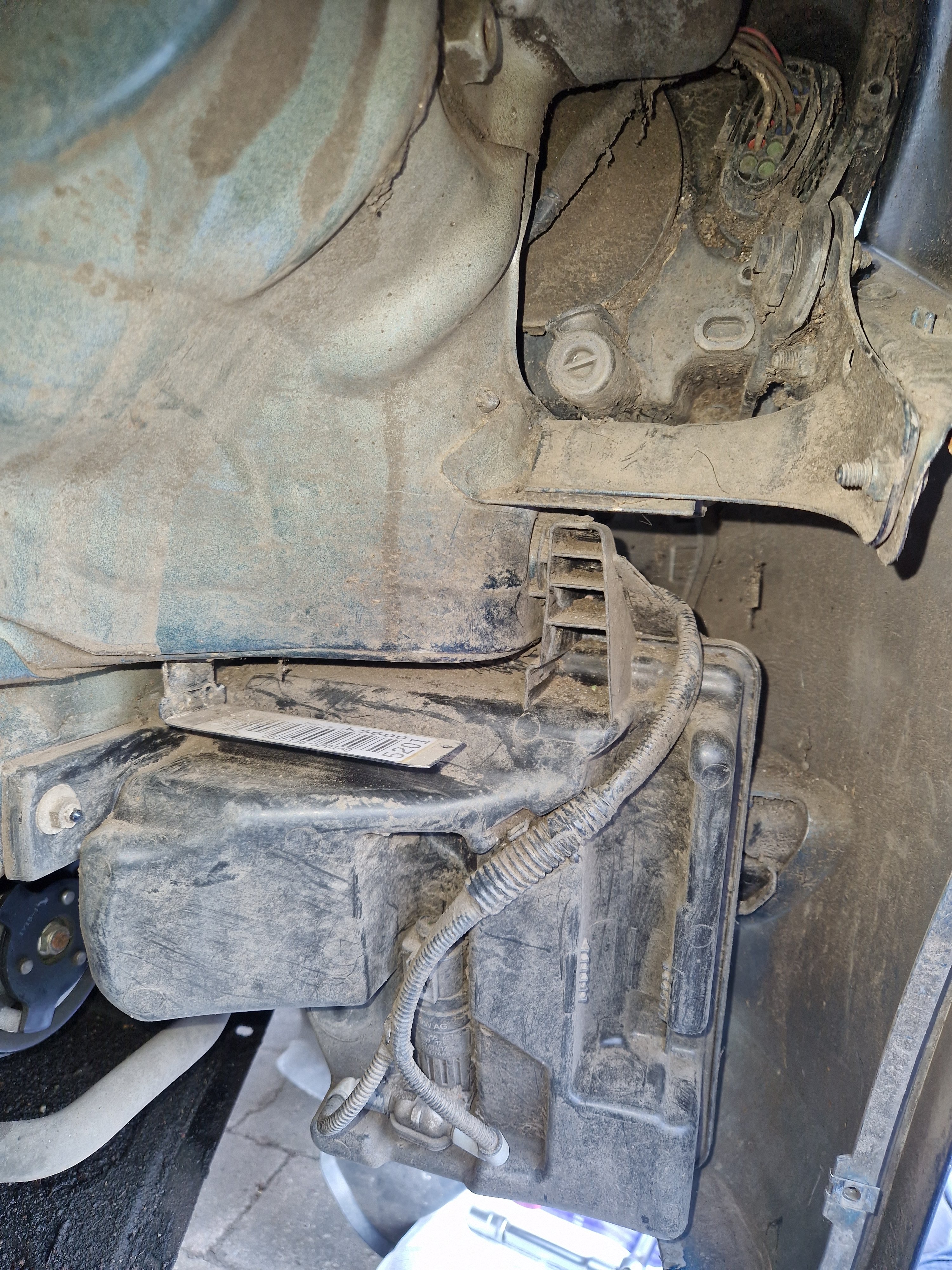

Lots of engine oil around on undertray

Ordered up Mintex brake boxes (discs and pads), a genuine NOS rear shock, rear bumpstops, a CV boot, nuts and bolts.
Started work on front left (going anticlockwise this time thinking I'd leave the front right with the CV action 'til last).
Everything came apart easily for the disc and pad change, but as noted in another thread, first snag came with the fact that despite ebay seller checking with reg number, the discs in the front brake box were wrong.
Silly me; thought all the VAG 288mm discs were probably the same, so didn't personally check everything well enough at time of order or delivery.
Seller was decent about it and gave a full return/refund including pre-paid Evri label, having established that they didn't have a correct set for the car.
I think having looked on the Mintex site that there isn't actually a front pads + discs set to suit this application; could be wrong.
Luckily, the GSF near my workplace had sets of Brembo discs and pads that I was happy enough with, for not much more than the refund amount, in stock the next day.
Went up together nicely once the 'bell' of the disc was the right depth.

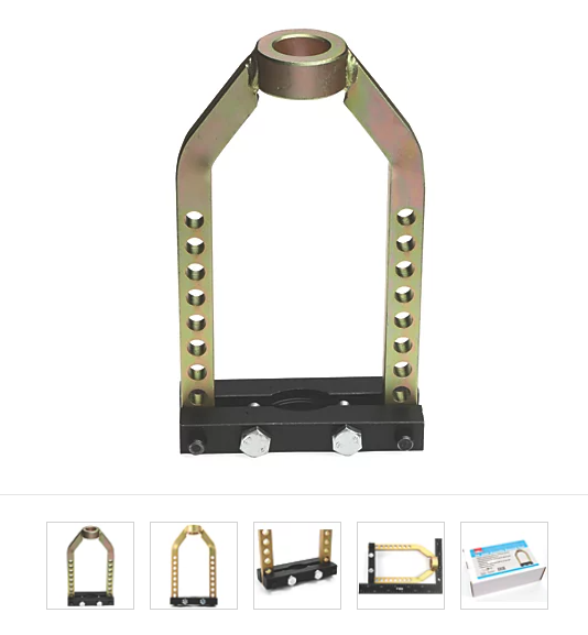

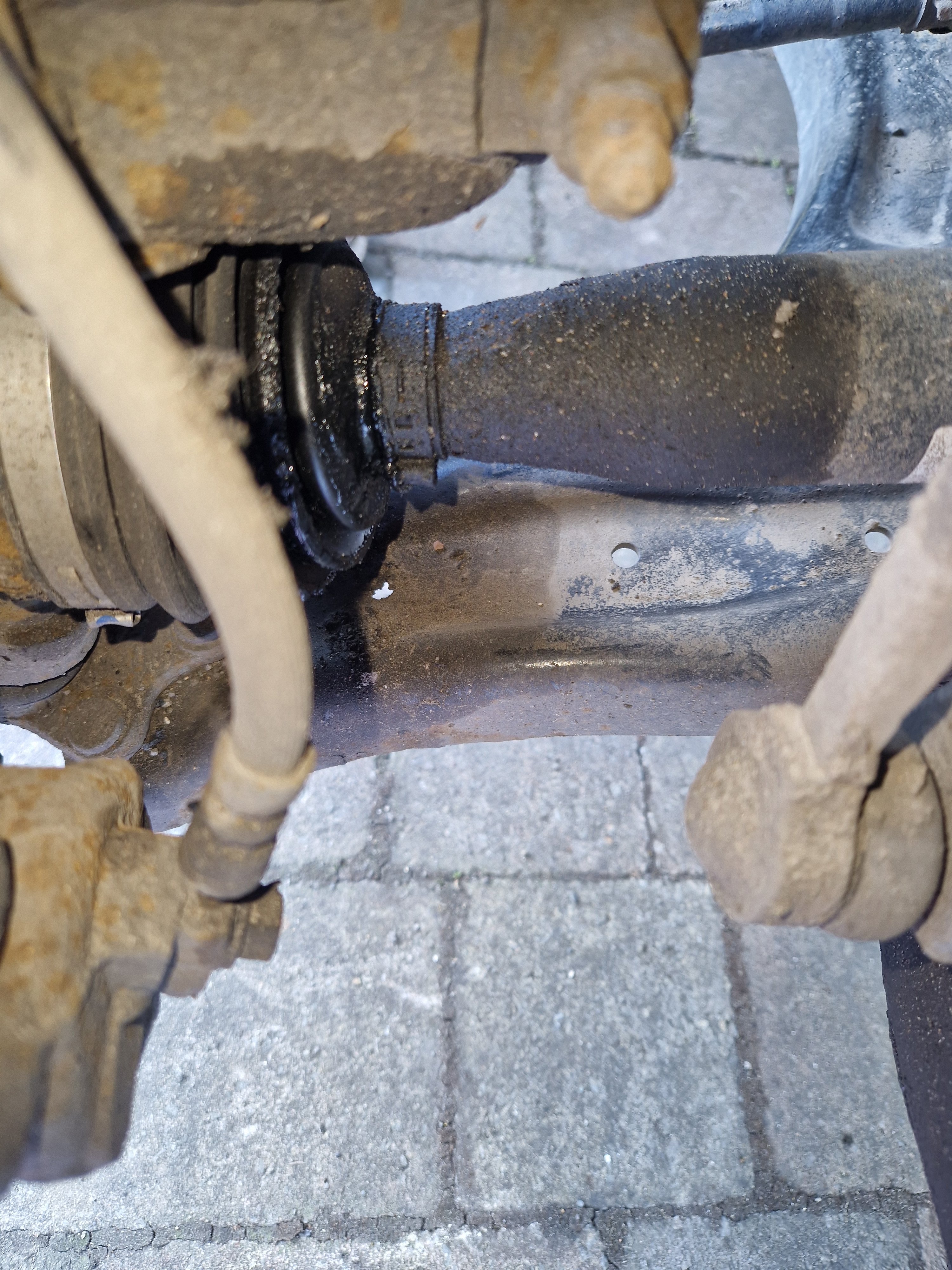

Front right needed outer CV boot replacement as well as brake stuff, but happily I:
a) had bought a tool some time back for in-situ removing of outer CV from driveshaft, and,
b) remembered that I had, and,
c) found it in my garage without undue time spent
Only in the £15 territory, from memory.
[More coming soon, just got to pop out]
Edited by Breezy_Pete
  • Sponsor
CV came away as planned, and boot replacement was the usual messy-as job. Didn't do a thorough job and clean out all the old grease, probably should have. Boot sorted.

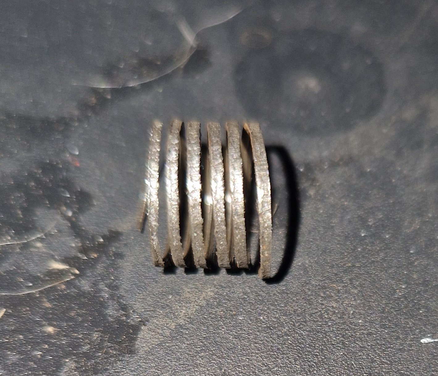

Then came the first significant snag. When re-torquing the carrier screws, the top one suddenly stripped. Bugger!
erWin info didn't specify replacement (just 124Nm torque I think), so I hadn't. May have helped me if I had, not sure. Took the screw back out in the vain hope that it was just that that had stripped, rather than the thread in the wheel bearing housing.
It looked odd. Turned out there was a helicoil (I guess?) filling in the thread at the business end, came off the screw in one piece:
So a previous repair had pulled out; yay! 😧
Wandered off to sulk for a bit. I had only just been telling myself how nice it was to be working on a car where all the fasteners came undone OK, rather than battles with seized and rusted stuff more typical of what I'm used to.
Simple choice faced me. another thread repair attempt or replace wheel bearing housing (far more time and work).
So I went for the quick and dirty option and got this set on order from ebay:
M12 x 1.5mm BRAKE CALIPER CARRIER BOLT THREAD REPAIR KIT Inserts Tap Drill Bit | eBay
Idea is that a threaded top-hat type thing is fitted into the hole where the thread was, from the side opposite the screw.
Didn't think about this quite long enough, in the context.
It comes with a stepped drill that centralises the new sized hole in the existing one, with a hardened spacer/guide bar too that forces it to be the right distance from the other one. See images in listing. Took a lot of drilling, hard work for some time. Went to fit the insert, which should be a tight enough fit to require a bit of pulling in, with pin and bearinged washer arrangement supplied. It was loose as anything. 🤔
What I'd not taken into account was that the previous repair had already created a significantly oversize hole where the helicoil had been put in, so the stepped drill hadn't done an adequate job of centralising the full size hole, which had wandered about and drilled oversize. Dumb mistake in hindsight, though not sure I could have made it work better, with this kit.
Anyway, thought I'd try torquing up the carrier screws anyway, to see what happened, and both took full torque without anything feeling bad. Wasn't happy about it, and knew I'd be revisiting at some point before long.

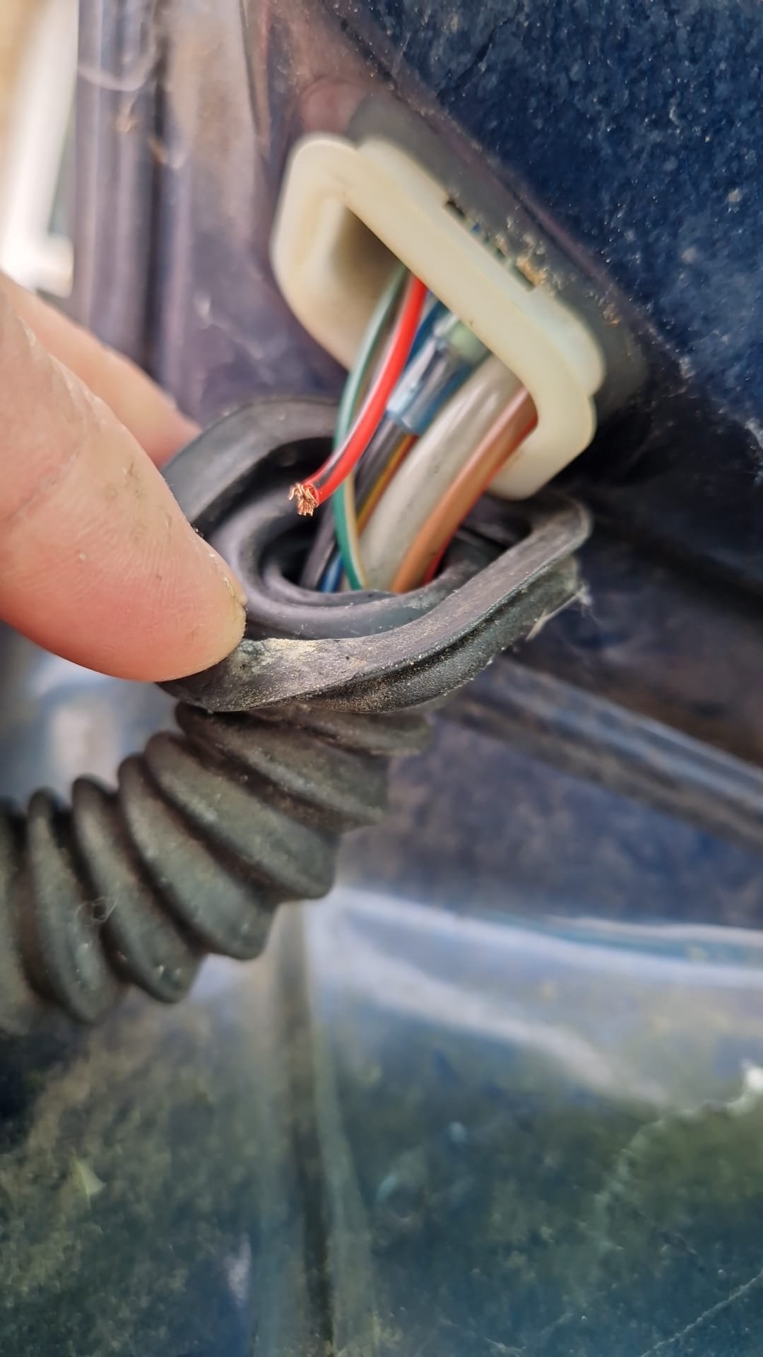

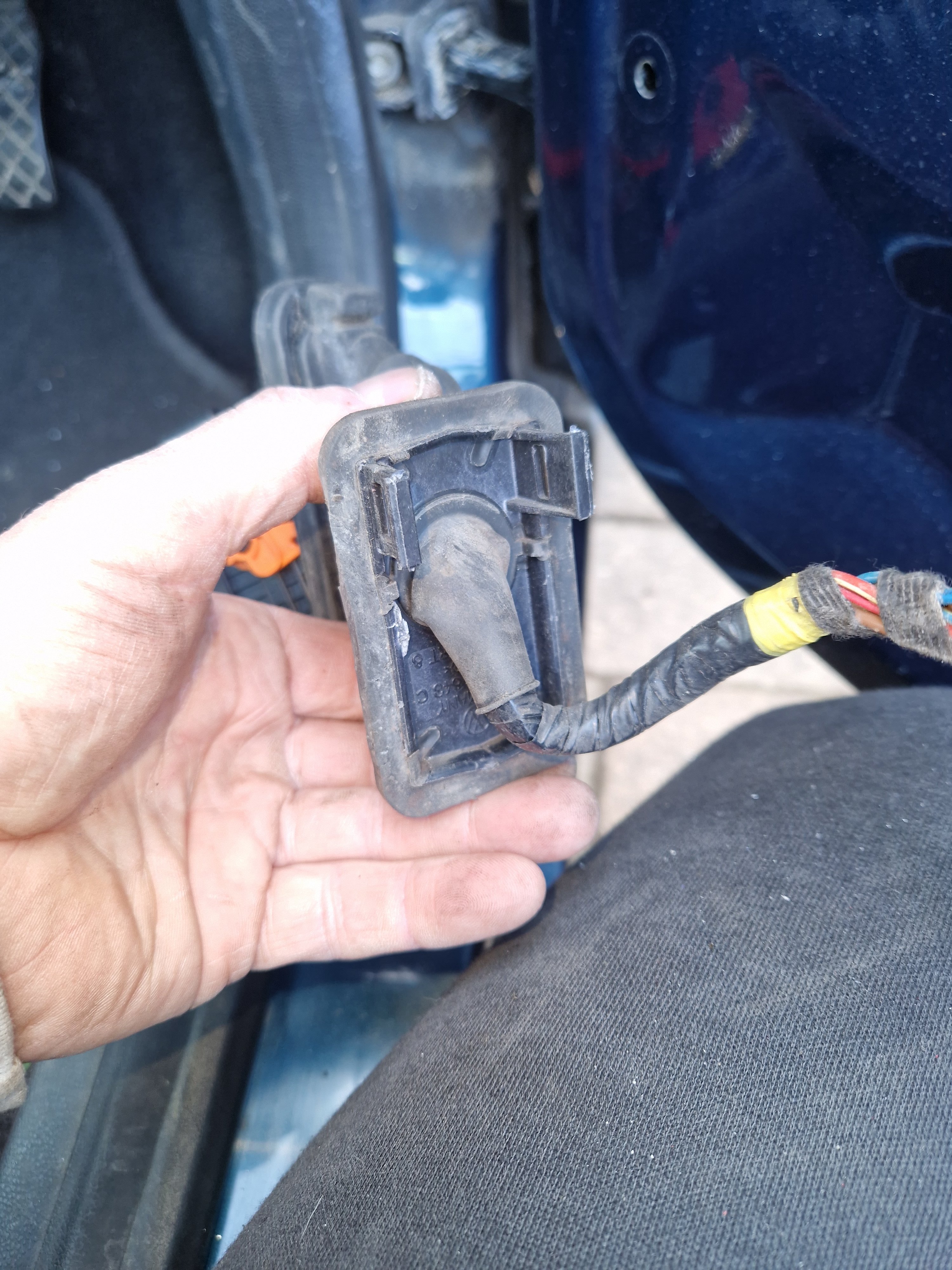

Next was a couple of electrical fixes.
Partner had told me that high level brake light was inop, following me back from collecting the car.
I'd noticed that the passenger side wing mirror was pointing down and inwards at an unhelpful angle, and the adjustment didn't work.
Boot wiring problem was unsurprising. Previous repair evidence on a few wires, and one newly broken wire responsible for brake light non-function.
Easy fix.
Mirror fault was imagined to be similar, and sure enough, after minor battle to release the bellows from (right) A-pillar 28-way connector, a couple of broken wires greeted me. Don't seem to have pics, except this one, taken just after loom removal and before bench repairs, to remind me the shape/profile of the loom as it comes into the innards of the door.
Repaired wires restored function of the mirror, and I did a couple of other wires that had cracked insulation but no sign of strand breakage yet, splicing lengths of super-flexible silicone insulated wire pre-emptively.
Was glad to discover that the loom removal and refitting process wasn't too bad to do.

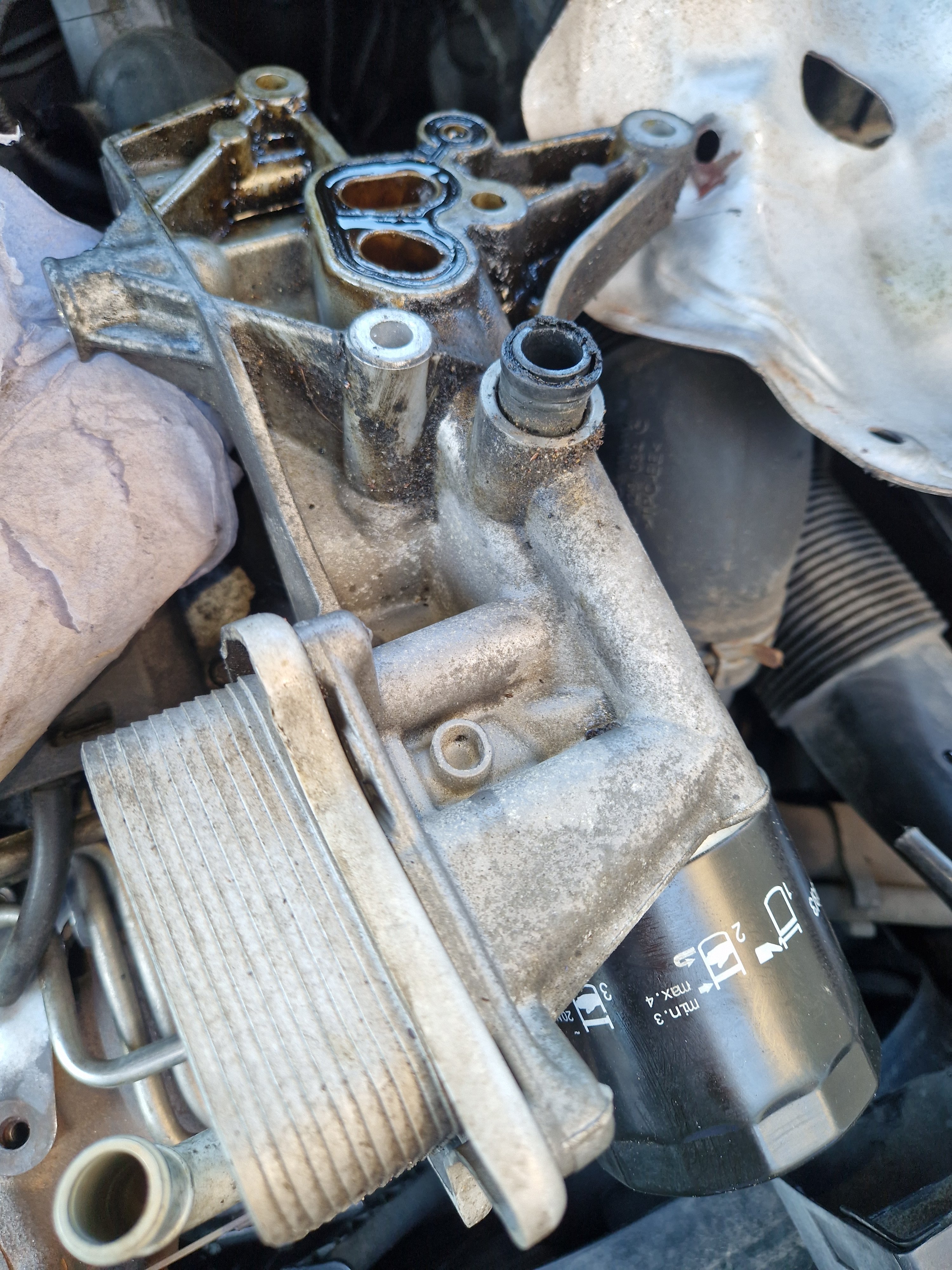

This evening I'll edit this post into a big version, but a spoiler is that it was addressing the oil leak, quite a significant one, mentioned on the last few MOTs as an advisory "oil leak front of engine". I'd already guessed at the culprit, and even headed down to the car on my first visit armed with the necessary gasket, since the replacement involved alternator removal amongst other things, and I thought it would be nice to 'kill two birds with one stone', while I was fitting a good alternator to get the car mobile anyway.
I posted a video of the seal replacement in a related thread after doing a search for 1.2TSi oil leak on here, and coming across this thread: https://www.briskoda.net/forums/topic/438119-2011-12tsi-dsg-oil-leak-head-gasket-gone/page/2/#findComment-5931213
Typically in that vid, the lambda sensor removal is made to look much easier than ever happens in real life, in my experience. It does have to come out in order to get the heatshield off, annoyingly, which then gives access to the right-most screw that holds the filter/cooler/alternator bracket casting on.
Wildly underestimated the work involved, and didn't even contemplate it on that occasion.
Spoiler: this figure of 8, plus another loop, rubber gasket seals the casting that holds oil filter and cooler onto the front of the block. It had stopped sealing it. The rubber was hard as a rock, squished flat with no compliance left at all.
Can't blame it at 13 years old and 159k miles driven. Not the best design, possibly.
There were also a few tiny bits of casting flash around the edges of that face where the seal sat, maybe holding it off the block a smidge more than planned. Tidied up before new gasket was fitted.
