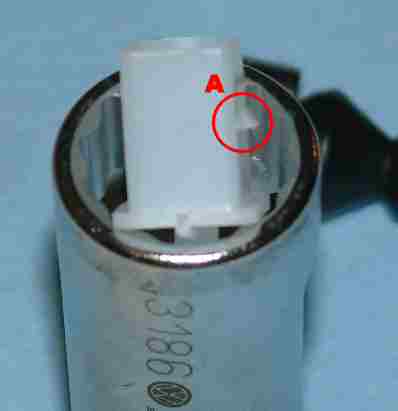

This is the lug that holds the connector in place (see A - the shape means they are easy to push on and impossible to pull off).

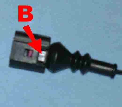

The arrow in this picture shows the opening you are interested in - don't the others look inviting :D

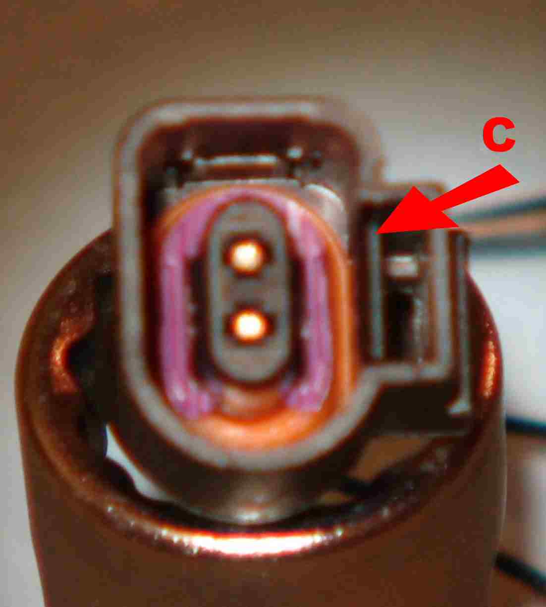

This one shows the latch in the locked position (see C)

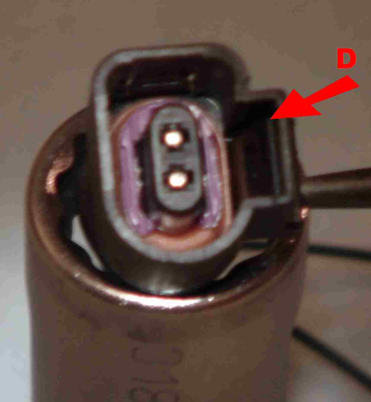

and open position (see D)
