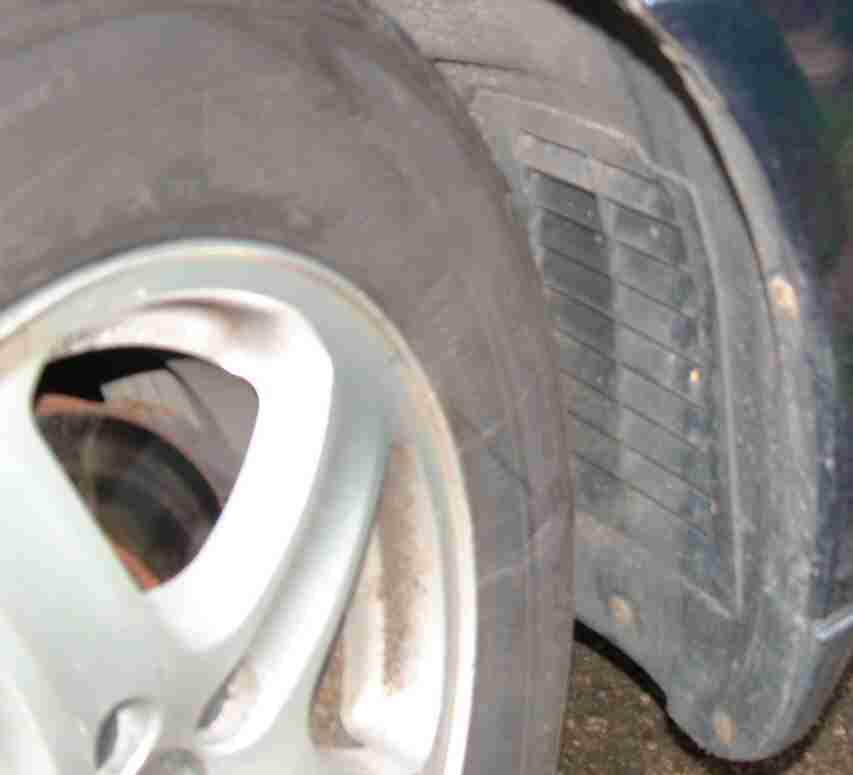

despite having a FMIC as standard my mk4 Ibiza has a vent behind where I presume the SMIC would be - would the arch liner from a mk4 Ibiza fit a mk1 Fabia?
That one am not sure about it probably will
Andy, is the vent in the lower front corner of the RHF arch liner? If so, that's the place. No idea if that liner would fit a Furbie though.
Might have to try it i have noticed a difference in performance when i been driving a while.
It does make a difference. I cut out the vent from a damaged TT wheel arch liner, cut a hole in my liner and Tigersealed it in.
Actually, further on this, the inner arch grille is there to protect the back of the SMIC, and IIRC is pop-rivetted in, so Andy could drill it out of the Ibiza without any issues that I can see.
yep, that's where it is
