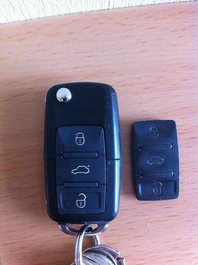

Not sure if this has already been covered. My new vRS SE came with worn keys and looked in to replacing them but obviously knew that would be expesive. So looked at re-housing the current internals in to a new case but was worried about breaking the chip inside.
So....found a better solution to just simply change the button pads for £2 each! http://cgi.ebay.co.uk/ws/eBayISAPI.dll?ViewItem&item=300585350733&ssPageName=STRK:MEWNX:IT
2 min job to do - use a screwdriver to pop the key in half from under the key blade, remove old buttons, push new ones on, put back together. Job done.

I changed the whole outer case of the fob bought it on eBay and it looks great. Wasnt much of a problem getting the chip out but it did need recoding after :(
