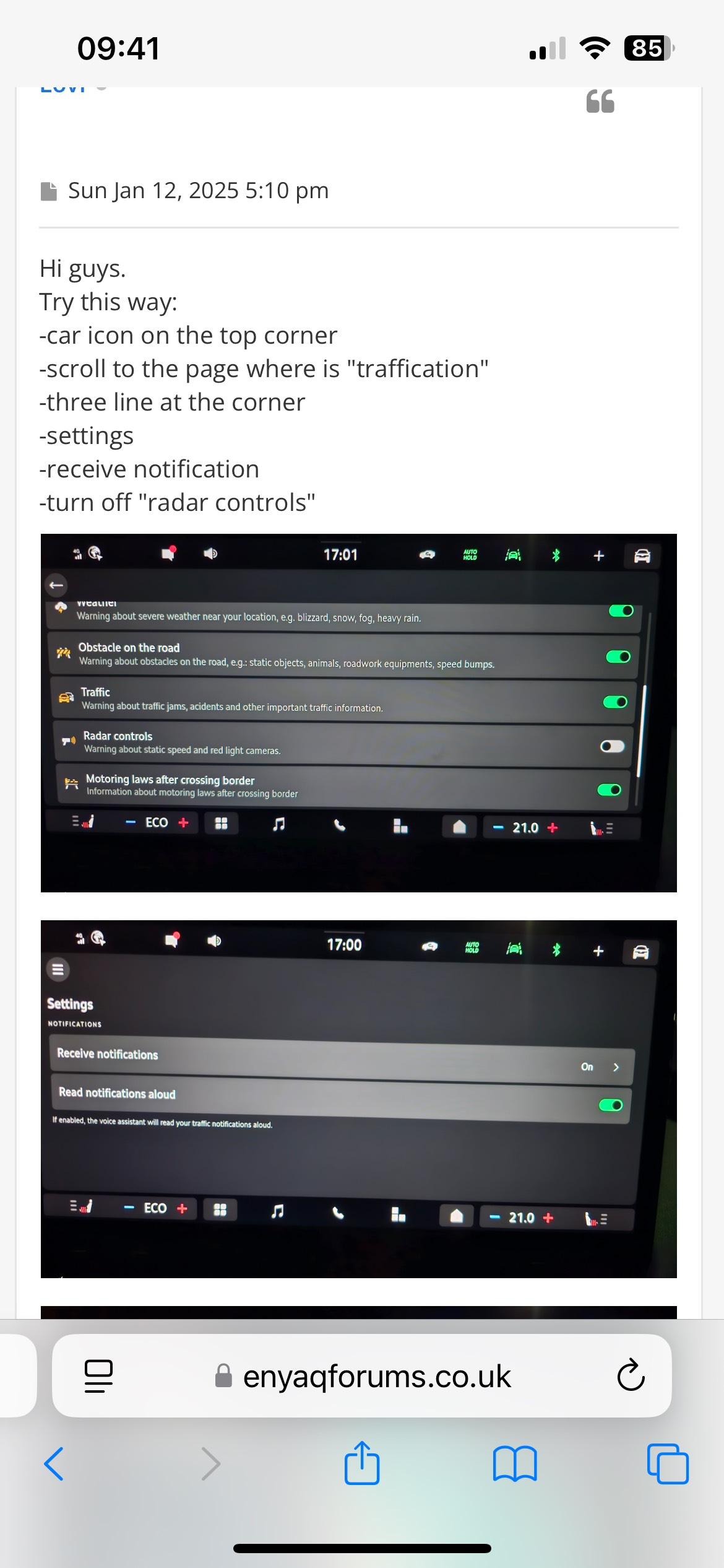

  3. It is annoying having to turn off the various assists but not too difficult with shortcuts. Some assists are positively dangerous, lane keeping on narrow roads for ex. I think the bigger issue will come when insurance companies refuse to pay out after an accident because the assists have been turned off or they are not working due to grime on the sensors. Has this been tested yet?

  13. When mine froze it was +2C but with a wind chill taking down to -3C Ny traffic sign recognition sometimes get wrong - had this same problem on previous 2 cars. All this talk of cars being forced to stick to speed limits is not going to work if they rely on Traffic signs and/or GPS. Will raise battery location as a separate thread
