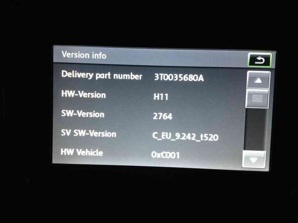

If your secret menu is activated then you need to press for about 15-20 seconds on the Setup button and look in there
I have firmware version 2764 so looking through the website it should hopefully keep the map.
