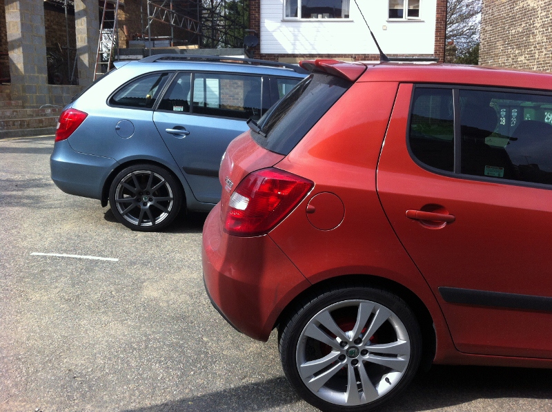

I had a recommandation from Leon-y-k but these were 55mm front and 40mm back and bit worried this might be too low, see below our cars next to each other.

Also, saw Leon today and his is only a fraction lower than my stock vRS is, so his 55/40 kit is spot on imo.

Even tho he lowered the standard car where mine is slightly lower that his...I'm just bit worried that 55/40mm will be too low for me car...:/

their not too low, and speed bumps are absolutely fine. you can see them later this week when youve got a bit of time to pop over. we can go for a drive around here and you can see for yourself! :)
