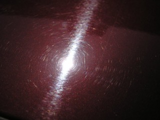

I wouldn't recommend polishing any degreasing product away. Tar will seriously scratch or swirl your paint if you use any sort of fabric to remove residue. Just let the product work for a few minutes (see directions on your product, but most petrol-based degreasers should not dry fully on the paint), flip out your power washer or hose it off. If you don't care for your paint much, disregard this post ;)

Swirls caused by dragging dirt and tar around after degreasing may be difficult to see in plain sight, but in direct sunlight or with a LED-light you will spot them pretty easily:
It's very easy to obtain swirls in your paint (allthough maybe not as serious as these), and usually they are caused by dragging dirt around with cloths, sponges etc.
