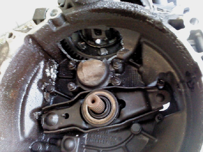

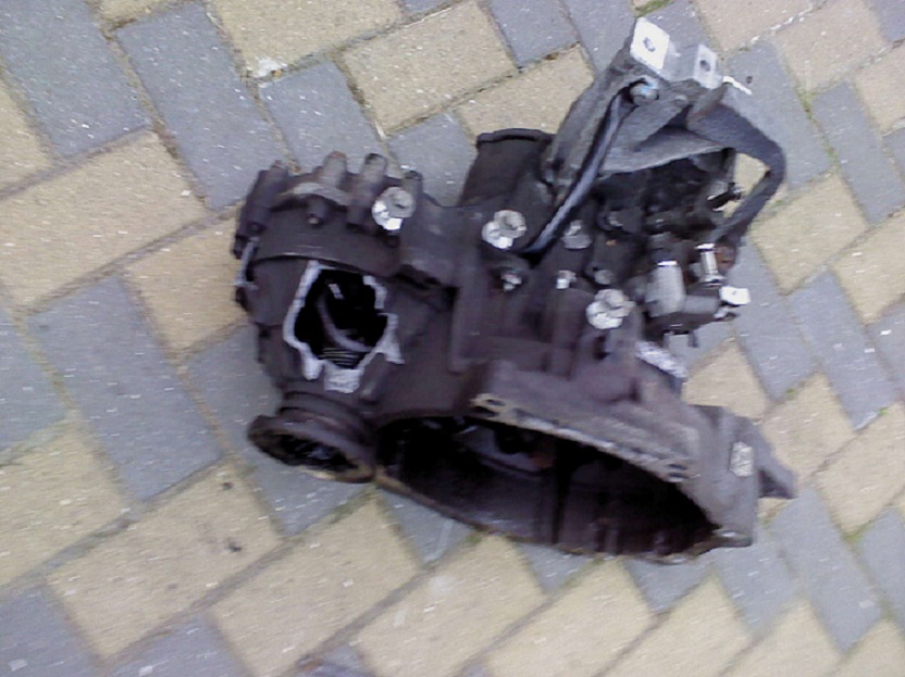

HI all,
just bought my octavia 2007 1.9tdi PD with AXR engine, gearbox is in bits as bloke was driving without bottom shield, now has two holes in it and some teeth missing (thats gearbox not the bloke) ;-). original box was jdh with dual mass clutch. im looking to replace the gearbox and wondered what else would fit to that engine-EUH from ATD engine possibly . also thinking about putting normal clutch as the current friction plate is only about 3mm thick. price difference between dmf and standard clutch is about 200quid. any suggestions will be appreciated.many thanks

Err is it me or is there a massive hole in that gearbox?? lol
That is a very impressivly destroyed gearbox, never seen one with holes that big in it,
If its like vrs's then you can do smf conversion on same box as i did when my clutch died

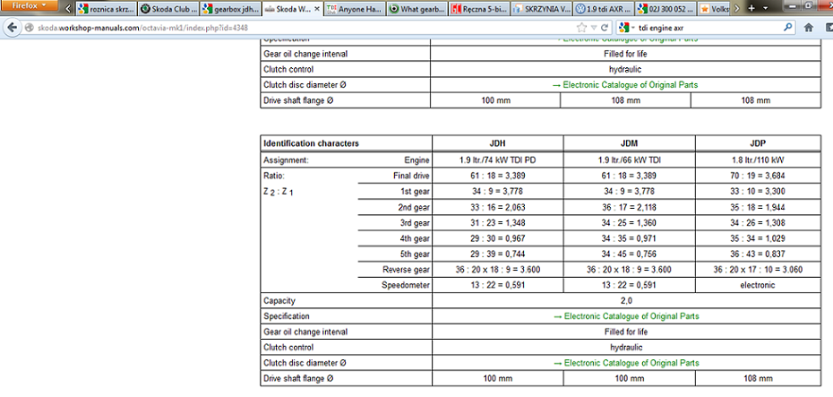

cheers guys, conversion should be fairly straightforward, i found a lot of info on it. the big question is what other gearbox will fit to AXR without loss of top speed or 'holes' between gears?
i found this comparison between JDH and EGR.Can you explain to me in plain english wether or not the comfort and economy will change with EGR fitted to AXR engine. they look identical but have slightly different ratios. if i was to fit EGR to my AXR engine and then convert the clutch to SMW will it make it much worse?
sorry but i just dont get gearboxes!!!;-)
Identification characters JDH
Assignment: Engine 1.9 ltr./74 kW TDI PD
Ratio: Final drive 61 : 18 = 3,389
1st gear 34 : 9 = 3,778
2nd gear 33 : 16 = 2,063
3rd gear 31 : 23 = 1,348
4th gear 29 : 30 = 0,967
5th gear 29 : 39 = 0,744
Reverse gear 36 : 20 x 18 : 9 = 3.600
Speedometer 13 : 22 = 0,591 electronic
Capacity 2,0
Specification ? Electronic Catalogue of Original Parts
Gear oil change interval Filled for life
Clutch control hydraulic
Clutch disc diameter Ø ? Electronic Catalogue of Original Parts
Drive shaft flange Ø 100 mm
