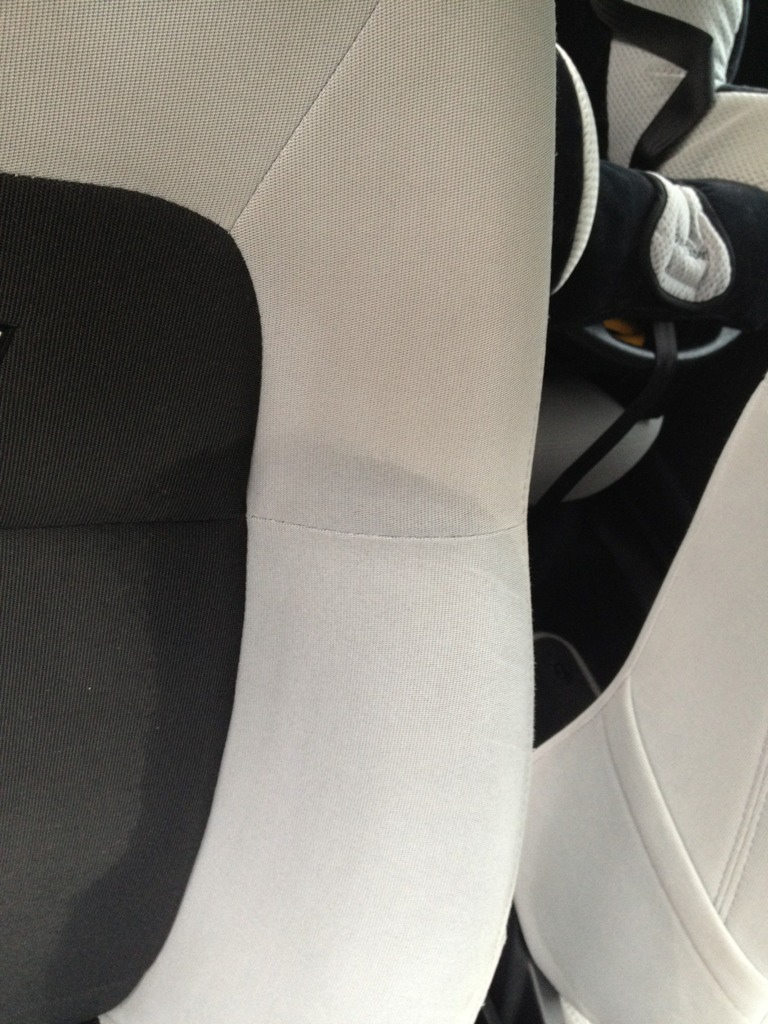

I spent a few hours today on the interior. I borrowed a wet vac from my mum and went to town. I forgot to take before and after pictures but got a 50/50. You can tell the last guy smoked in it!!!
As you can tell, I had cleaned the bottom part of the bolster

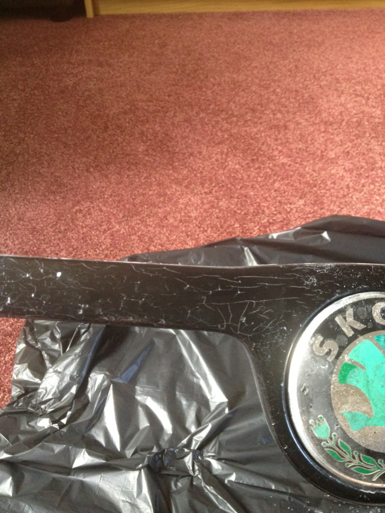

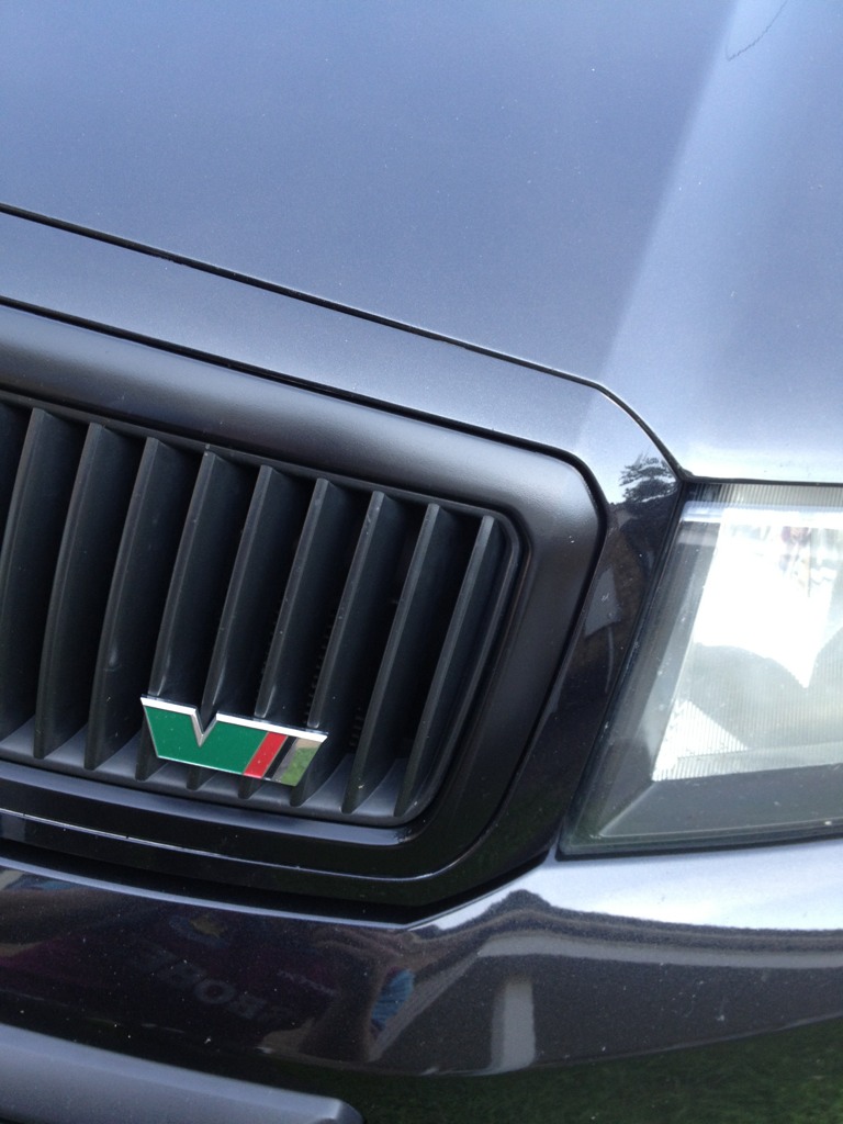

So when I got the car one of the first things I noticed was the state of the chrome grill section. It had a DIY job to colour code it to the car and not a good one... post-94317-13450630112191_thumb.jpg
So I stripped back all the paint with a stanley blade because nothing else would go through about 12 layers of paint.
It became clear that no primer had been used and black paint was sprayed on the chrome with no prep.
I went at the chrome surface with 60 grit initially and then worked up to 1200.
I also decided to remove the skoda badge as it was a state and I'm waiting on the new one still.
But after priming, painting and lacquer I am much happier with the finish.

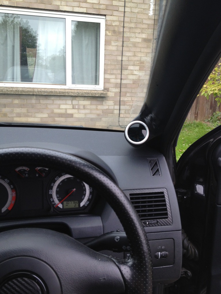

I also removed my volt gauge today. No need for it at all. I am still running the boost gauge that was fitted when I got it, still in the butchered a pillar.

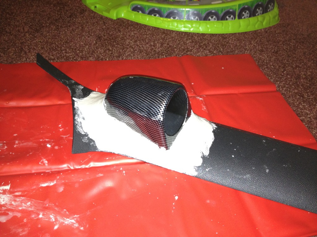

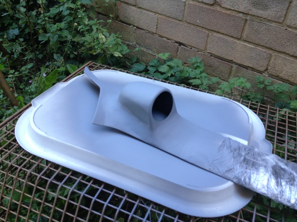

I am in the progress of making my own pillar pod. I have not finished it yet as I am going to try something different but this is it so far....
Used filler to try and get a look as though it was made like it from manufacturer. After many hours of smoothing, sanding and fettling I applied some primer
And now I have another idea... Hopefully have a finished product next weekend.
Ok, so after my failed attempt at flocking the pillar trim I brought some hycote wrinkle effect paint from egay and sprayed it instead. The finish was better than I thought and after a lot of fiddling with wires and a filter to stop the annoying buzzing we have a finished product. post-94317-13482198541825_thumb.jpg
