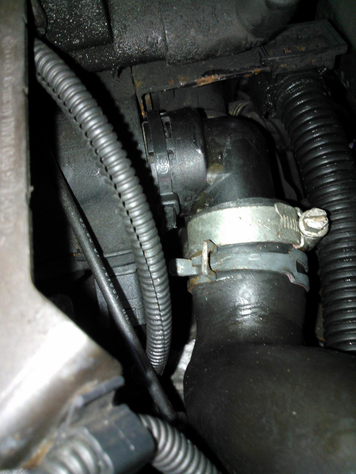

I have W reg Fabia 1.4 16V Comfort with AUB engine code and have suffered some coolant loss recently. The leak is from the connector where the top hose goes on to what I believe is the thermostat housing. However, having been sent a parts diagram by a company I rang, in order to identify it, I can't actually see it there. On my car, it is a push fit 90 degree elbow connector which goes on the housing (covering an O-ring seal) and the hose then fits on the other end of the elbow as it were.
It's a plastic part and where it goes on to the housing some plastic has broken and it no longer holds on very well. There's actually a plastic wrap/clip thing round it but I don't know when that was put on. Perhaps I might even get away with just replacing that, but I would prefer a new part. I've attached a photo.
(There's also traces of old Araldite because at first the leaking made me think it was a crack in the elbow.)

Hi,
I have looked at your photo and at the correct parts page for your engine and my gut feeling is that somewhere down the line a bodged non standard part as been fitted. hence the confusion.
Tony
I'll have a look on etka later
i can confirm it a bodge, have scoured your engine code coolant system and nothing like that is there on etka diagrams. All i can see is a flange where coolant rubber hose would be clipped not a 90 deg plastic elbow. I suspect a previous break and a fix

Thanks to freelanderman and Lofty79 for looking into this for me.
Does it mean I probably have the wrong thermostat housing? I can't seem to get on the vagcat site this morning to check the part number but should I have one like this on ebay?

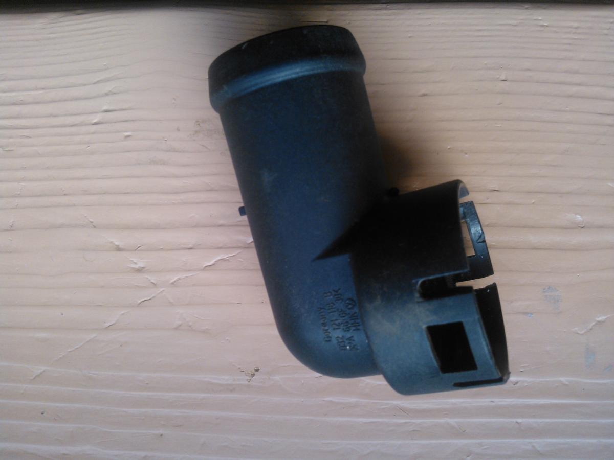

If anyone's interested I located the connector part from a breakers in the end rather than replacing the thermostat housing.
Part number is 032121118B (photo attached).
good find, that is an illusive part that.
