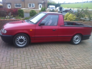

does a felica front windcreen fit a skoda/caddy pick up?
i was hoping some one could help please , do felcia windscreens fit the mk2 1998 pickup ,
any help would be great
cheers steven
Yes. Everything from the 'B' pillar forwards is a bog-standard pre-facelift Felicia. IIRC the facelift was the wings, bonnet, slam panel and bumper (Am sure I'll be corrected if I've missed something)
the pick up is still a felicia from 'b' billar but make shore you get new one sealed in or you will have a very leaky pick up
thanks new windcsreen and ruber fitted , and sealed in for that bit extra
cheers boys
i had new one in mine and sealed but needs more sealing
hi UMASLXi1998
there was a guy ( felicia16v )on this site told me to drill a small hole on the lowest point on each corner of the scuttle pannel
before fitting a new windscreen, (i did just that) and
thats the windscreen been fitted about 4 weeks now and it has rained the past 4 weeks too (sunny scotland)
and my pickup so far is still bone dry,
thanks to felicia16v for the info
