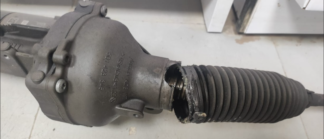

Morning you all, Finally the problem appears, it's solved now and it was the steering (obviosly). One month ago, before the noises, the car leave the road, just a little bit, but no little enougth hehe and then: the mess has maked...so, be careful and drive well 😭 Thanks you for all the answers, feedback and advices!! (I learn a little bit)

Morning fellows, After do all @numskulltold me, the noise still there. In other garage, much more trusted, the worst scenario appears again: "the steering rack". They will offer me 2 alternatives: - Repair the piece. - Replace the piece. I don't have the prices yet, but only the new piece cost around 1000€. I'm contacting with Skoda, both garages (official and non-official) told me the same "It's not logic in a car with 5 years and less than 50.000KM have this kind of problem, except a manufacter issue. The car haven't got guaranty but at least try to speak with Skoda assistance". Thank you all for the advices, I learn so much. If I have any notice I'll notice to you fellows!! PD: The Three Wise Men will be lightly laden this year.... 😞
