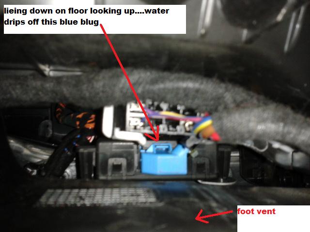

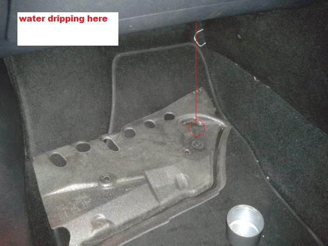

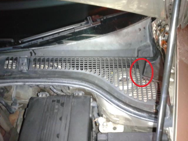

Hello......i have a skoda octavia 2005 ambiente 1.4 and have water dripping from behind the glove box (dripping down wires :rain: and down to the foot well)...water is coming in from the scuttle panel/bulkhead below the wipers (they r clear not blocked and I can’t find were the water is coming in from.....driving me mental :wall: ....anyone out there have any problems like this?....any ideas on how to fix? :wonder:

There is a rubber grommet up there somewhere that runs from behind glovebox into the engine bay (will need to removed air free box & battery to get to it).
Wonder if that might be perished / ripped / etc. and water is getting in there?
From the inside (remove glovebox) it's slightly left of centre and up behind some plastic, but you won't see anything from inside.

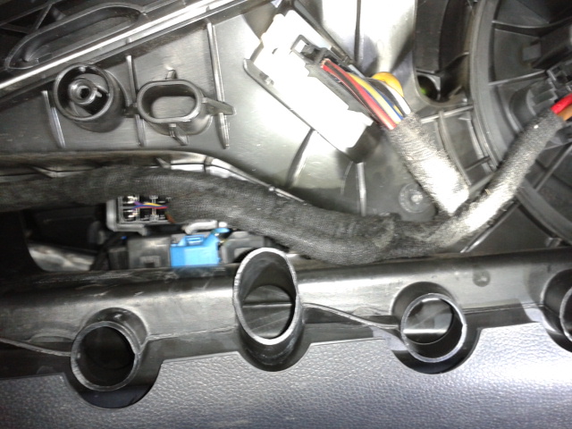

I had taken off the glove box earlier but couldn't see up based the wires from were the dripping came from...i was poreing water doew ta see were it came from but its such a slow drip its hard ta find....the smell of damp in the can stinksand the car fogs up inside all the time......any ideas what them wires r foe....been have problems with the electric...windows not automattic some days???? and mirrors now work together when on "R"....the used ta be "R" move right only and "L" left only????

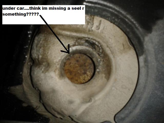

Picture 3 seems to be missing a plastic bung about the size of a saucer. I understand from another post that it's a cover for a hole into which a jacking support point can be fitted. It's an Audi sport modification but some have fitted it to Sodas since the holes are there.

I have also suffered from the odd leak there. I put plastic behind/under the carpet but it doesn't seem to happen much. I think the pollen / air intake is there and water leaks in when I use a power hose. If you have a pollen filter I would certainly make sure it's new and the drain holes in the scuttle are clear.
