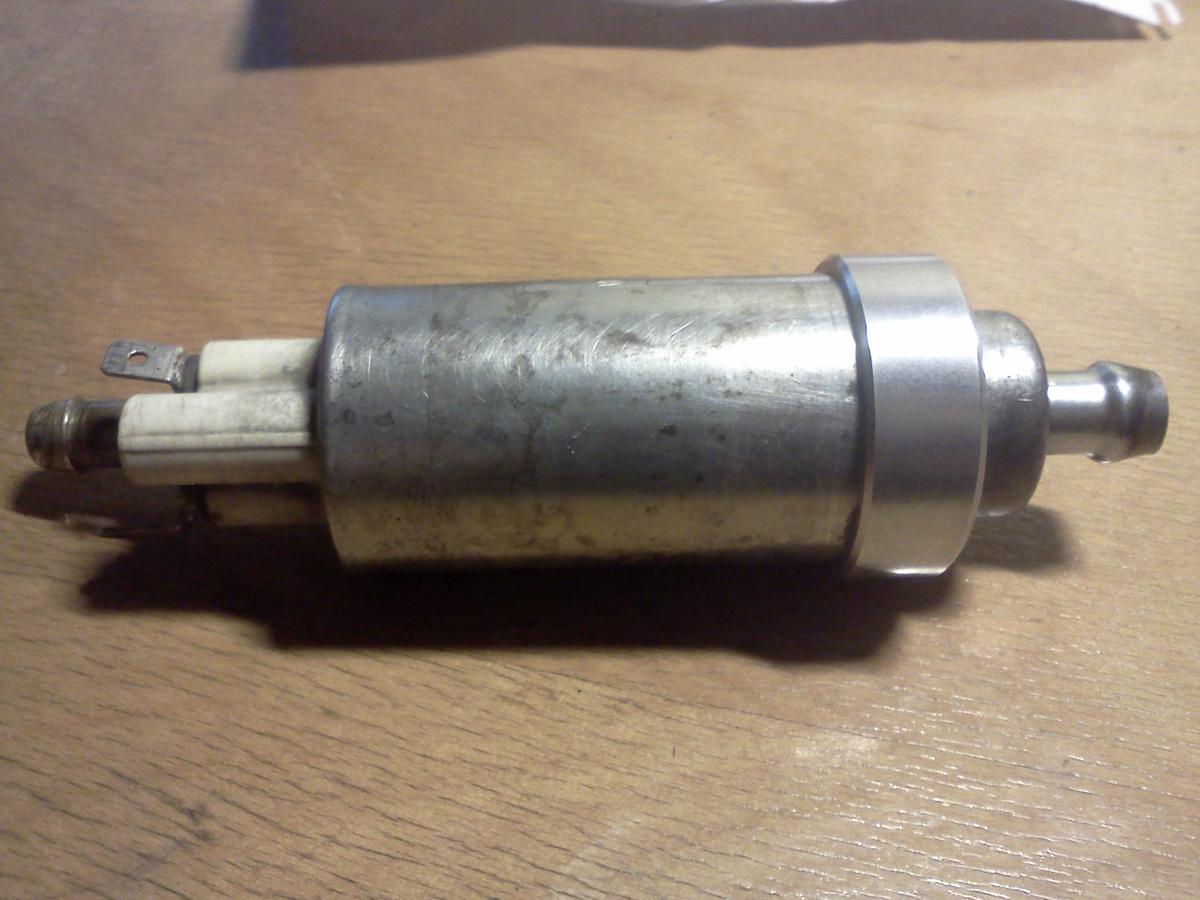

This is what we need:

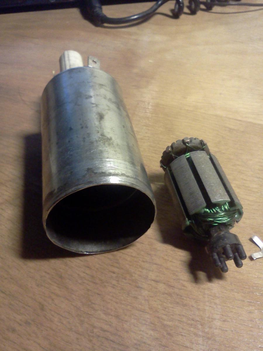

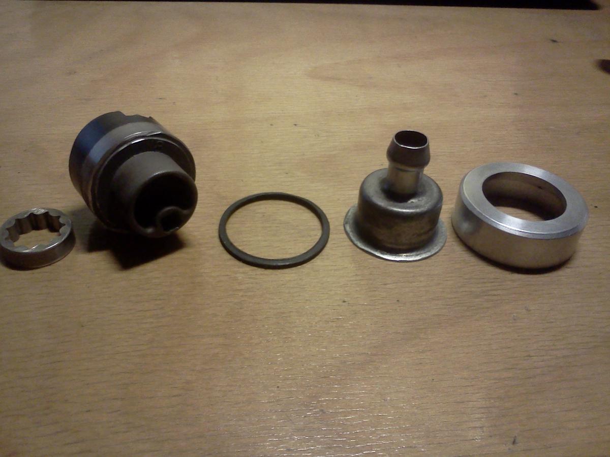

Patrick, we could finally mend the Walbro. It was full of rust. Now it works and so does my Rapid RiC.
Did you manage to repair yours?
