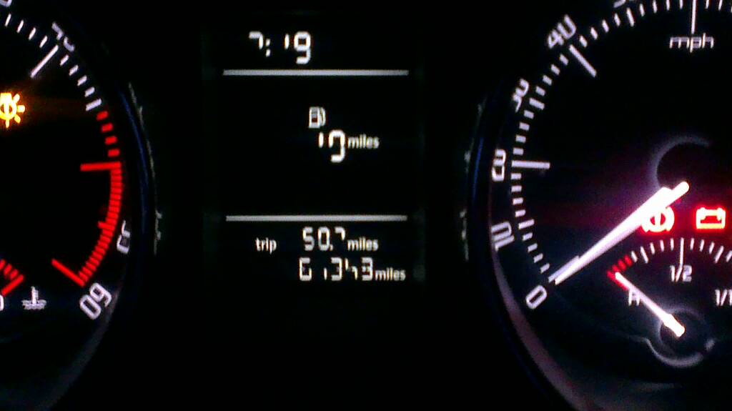

Hi I was wondering wether anyone can help me with the cheapest easiest way to replace the LCD mfd on my superb as typically its happened just a thousand miles out of warranty.

If you're very handy with a soldering iron this can be replaced. Skoda will try to replace the whole instrument panel. There are a few companies that specialise in this sort of work too, if you can find one nearby. Getting the instrument panel out is very easy too - drop the steering wheel to its lowest, pop the trip strips off both sides of the steering wheel and undo two torx bolts at the bottom and it'll wiggle out. I have more detail on taking this apart on one of the threads on failed instrument panel backlights. There might be something helpful on youtube too.
As sad as this sounds but on an episode of Wheeler dealers they had a MFD replaced on a Audi TT cluster thats had pixels missing! If I remember correctly it was about £100, If you can find it on YouTube you might see the company name, Apparently VAG say it's a non-servisable part, unsurprisingly, but these guys can do it.
