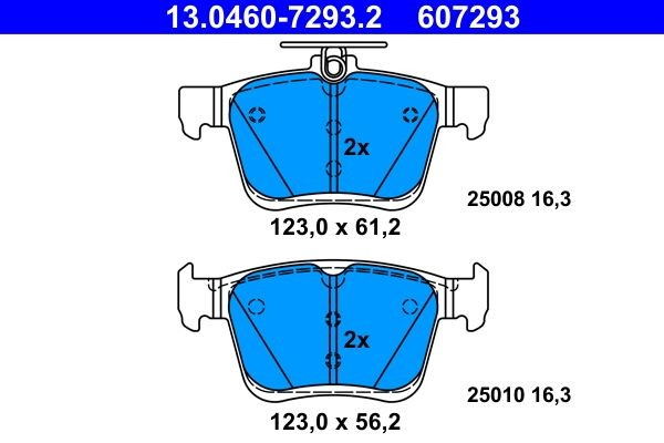

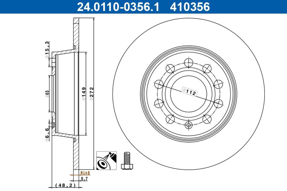

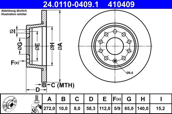

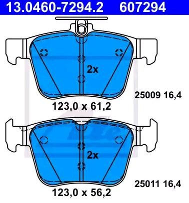

  9. If the car has build code 1KE, then search for any of the five below OEM part numbers. Build code 1KE is an ATE brake system. Brake pads for 272x10mm rear brake discs (build code 1KE) 5WA698451 5WA698451E 5WA698451G 8Y0698451 8Y0698451C https://www.autodoc.co.uk/car-parts/oem/5wa698451?supplier%5B%5D=833&supplier%5B%5D=62&supplier%5B%5D=48&supplier%5B%5D=3
