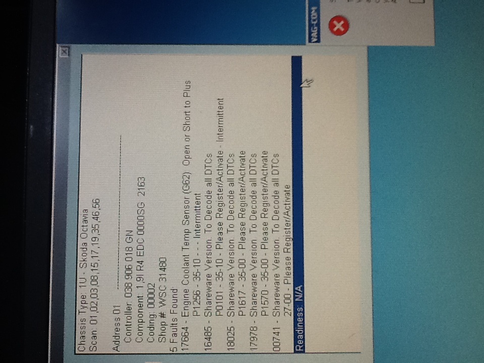

Hi I ran the vag com softwere through the octy and she cam back with the following results could anyone make head or tail of this for me ??

That's a very old version of VAG-COM you are using.
Has the ECU been replaced?
If not, I would start by checking relay 109.
As far as I am aware it is still the same ecu
The reason I ask, is that one of the codes is an immo fault.

Ah the car runs fine , all I wanted to do is code out the service inspection from flashing up all the time , all the falt codes are probably from a long time ago before I fixed them all and there probably just sitting around on the memory , I was just curious to know what ones they actually are

That's good. Usually when you see a random collection of faults like that, it's a faulty relay 109 (ECU power relay - behind the dash, above the pedals). Clear the codes and see if they come back.
