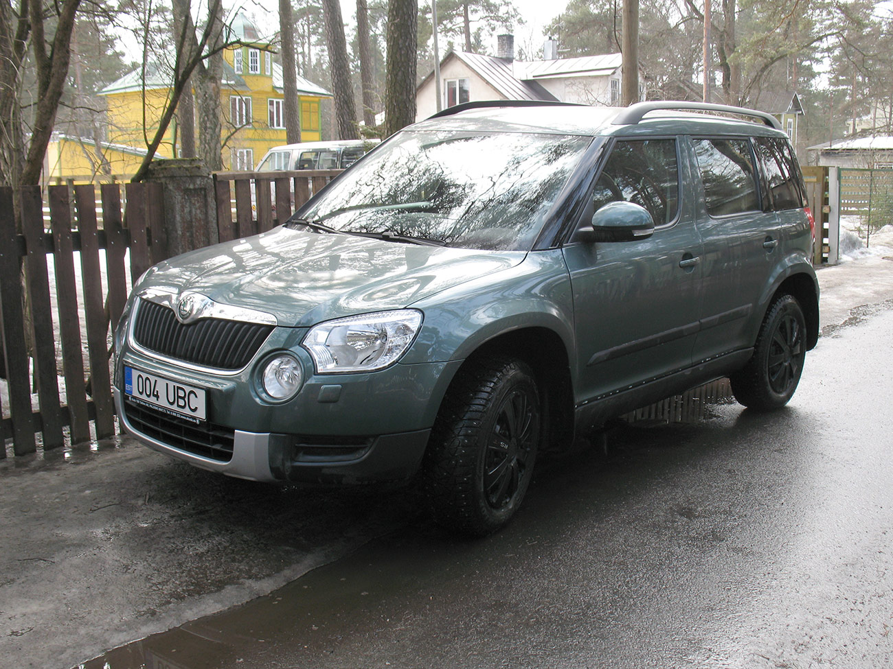

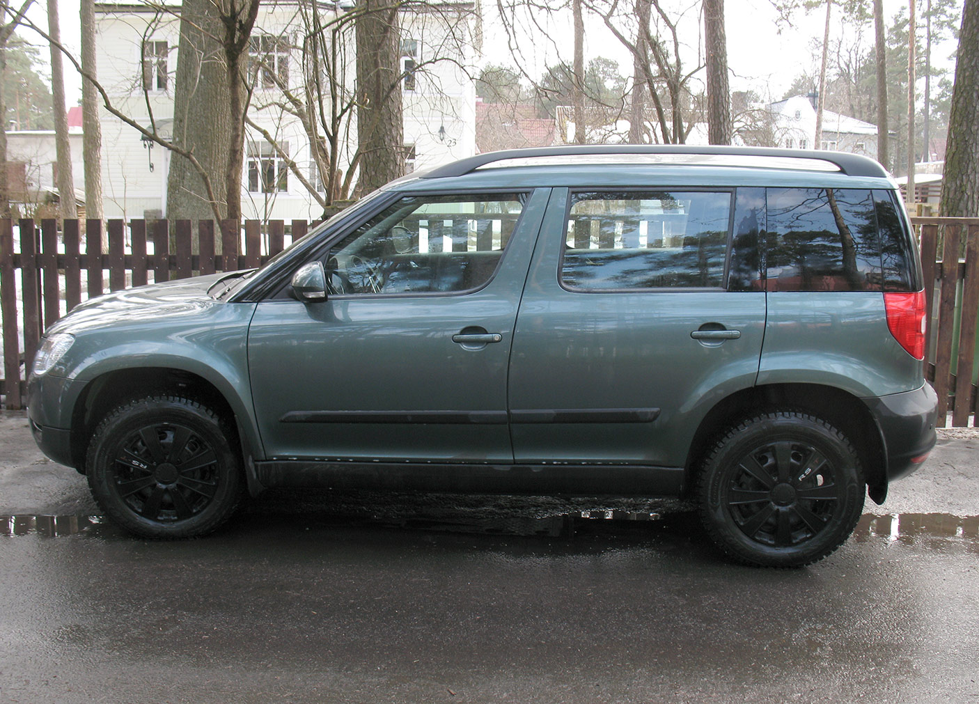

Regency green Yeti on 215/65 R16

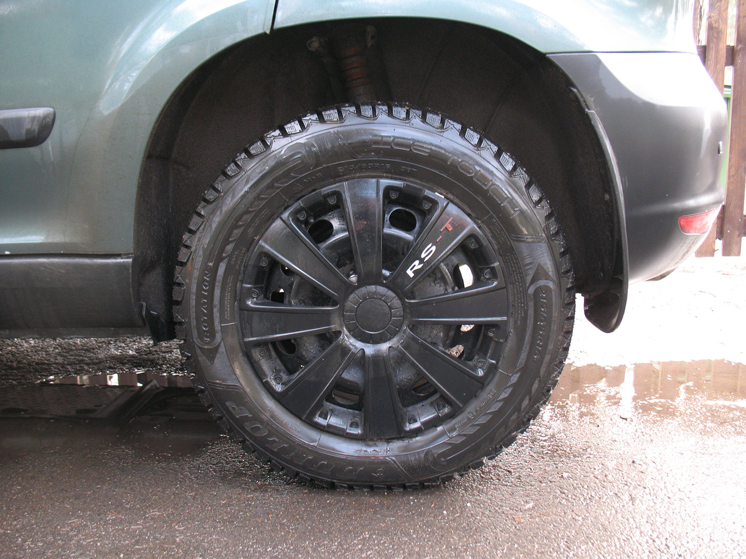

For those who want "bigger boots" (215/65 R16 Dunlop Ice Touch) (and those who wonder how Regency green Yeti looks like) :notme:
As You can see - plenty of room still...

But seriously – wanted a bit more ground clearence – harsh winters over here...

Looks good with no shiny chrome anywhere ;-)
Sunroof option would have given the "commander" somewhere to stand :giggle:
Like the bigger boots, not sure about the colour.
I absolutely love it. Makes a 'Range Rover Drug-dealer sport' look girly in compassion. Good work !
It needs a turret. I love the colour - good camouflage. :bandit:

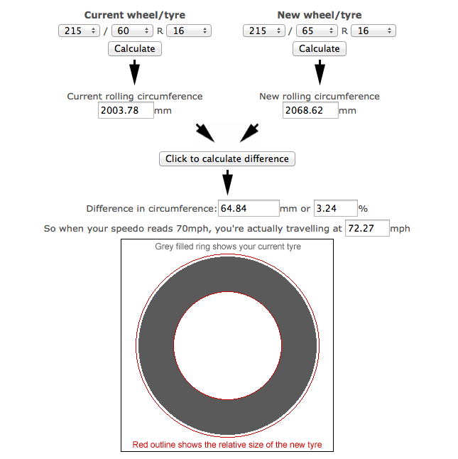

The bigger tyres do look good but over in the UK fitting something of a size that is not specified in the handbook means it is something that needs to be declared as a "modification" to the insurance people. If you don't your car is uninsured alas. Your speedometer will also be very inaccurate having done this!
Yes it will, a bit:
But - correct me if I'm wrong - doesn't speedometer lie already (shows a few km/h MORE than actual speed is)? If so – isn't this set-up ("bigger "wheels) more accurate then? :notme:
Yes quite true (its at least 5kph out)....and it really winds me up. What is the point of a speedometer if it does not measure your speed !!!....especially in the age of speed cameras.
Yes..
The 225/50/17 tyres fitted to many Yetis has a slightly smaller circumference than the 215/60/16s so is even more inaccurate.

Quick observation re: speedometer readings. Surely this changes slightly over the course of the life of the tyres due to the rolling circumference reducing over the life of the tyres? Someone with a big brain could no doubt work this out. If you assume that tread could reduce by 5mm (so 10mm on the diameter) I quickly calculate that the difference in rolling circumference is approx 33mm or 1.6%.
