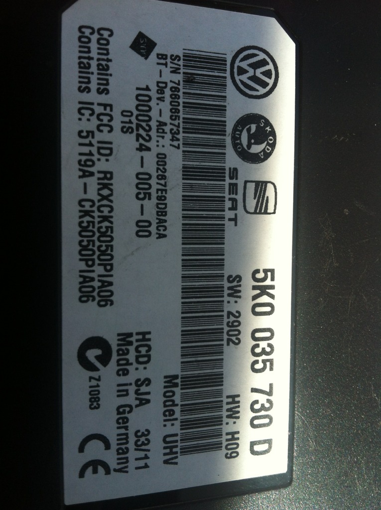

This is the kit I bought
It all worked without coding except the mic the phone book is scrambled and it does not show on maxidot.
It's booked into dealers on Monday so hope they can sort it.
Regards whoosh
looks like you have an early bolero that doesn't work properly with the BT kit. No fix I'm affraid other than buy a newer bolero
