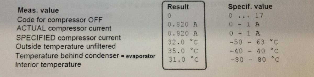

Sounds like a knackered compressor to me, I have posted some details of what to check with VCDS which will tell you what's going on.

VCDS can report the Compressor spinning when its not. Mine was siezed and the nut was not spinning yet VCDS showed it as turning. If the target and actual are exactly the same I think that is a sign that its actually broken.
If you got those figures (the last three just have to be around about the same) then the compressor is knackered.
If the compressor has broken internally the system must be flushed and a new drier fitted.
I started a thread in the VCDS/diagnostics forum which has what to check with VCDS posted by tech1e.
