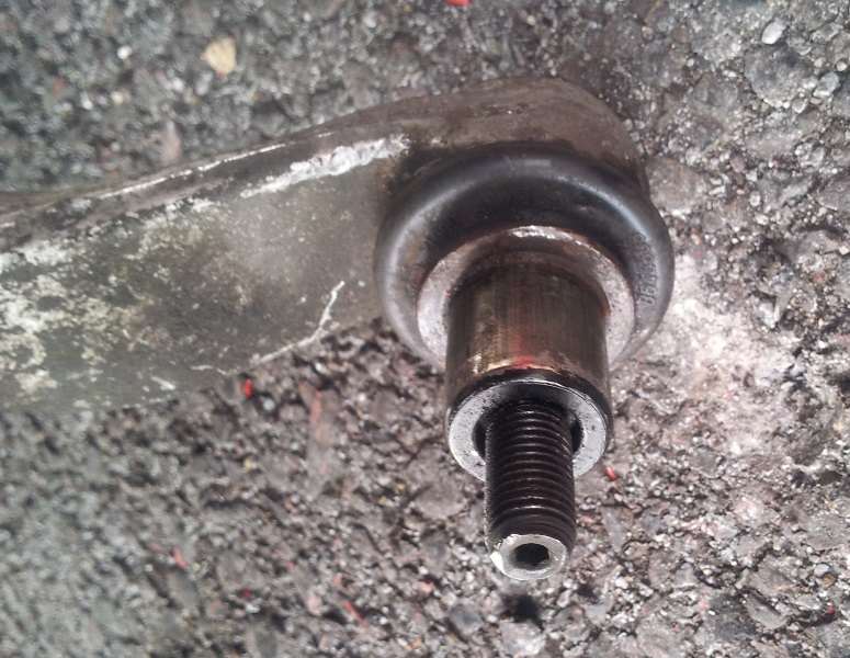

Now after removing lower back arm I noticed that ball joint is different then the one I have. So went googling and found that the front lower arm can have 16mm or 20mm taper on the ball joint, but mine both(front and back) with 20mm tapers. The part is lemforder and has number K1799-12 on it but I could not find anything. Can anyone provide me a correct part number?

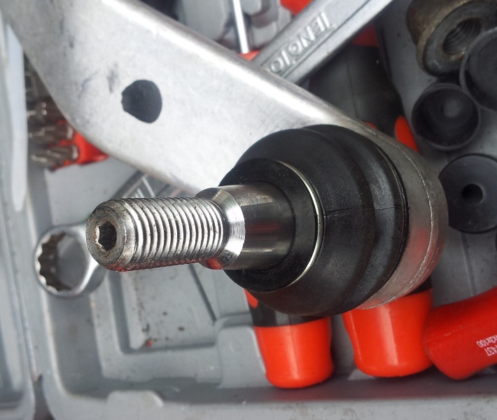

The parts that I bought are Febi 19932(should be 11350) and 21196.
What I don't understand how did the dealer installed the same parts on the right side? I've checked the part number(just to be sure) and they are the ones that I provided? Is there some kind of converter between from 16mm to 20mm?
I'm attaching photos of original part and a new one.

All sorted... my bad.
Somehow the ball joint came of with the bushing that was suppose to stay in the knuckle and this is why it looked different. :)
