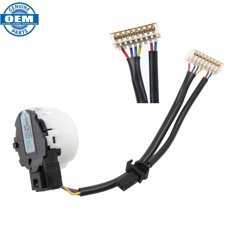

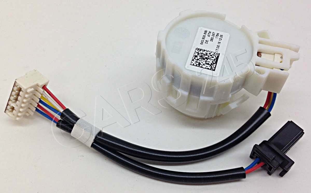

  10. I need a new ignition switch for my 1.6D 2013 car but can't find any without ordering from Lithuania, all the ones for sale that say are for my car have a different plug with 8 connectors but mine has 6, the 8 connector one is sold as a compatible one for the same oem part. Does anyone have any experience in using this newer part and will it fit onto the steering wheel connector? I have attached photos of both.
