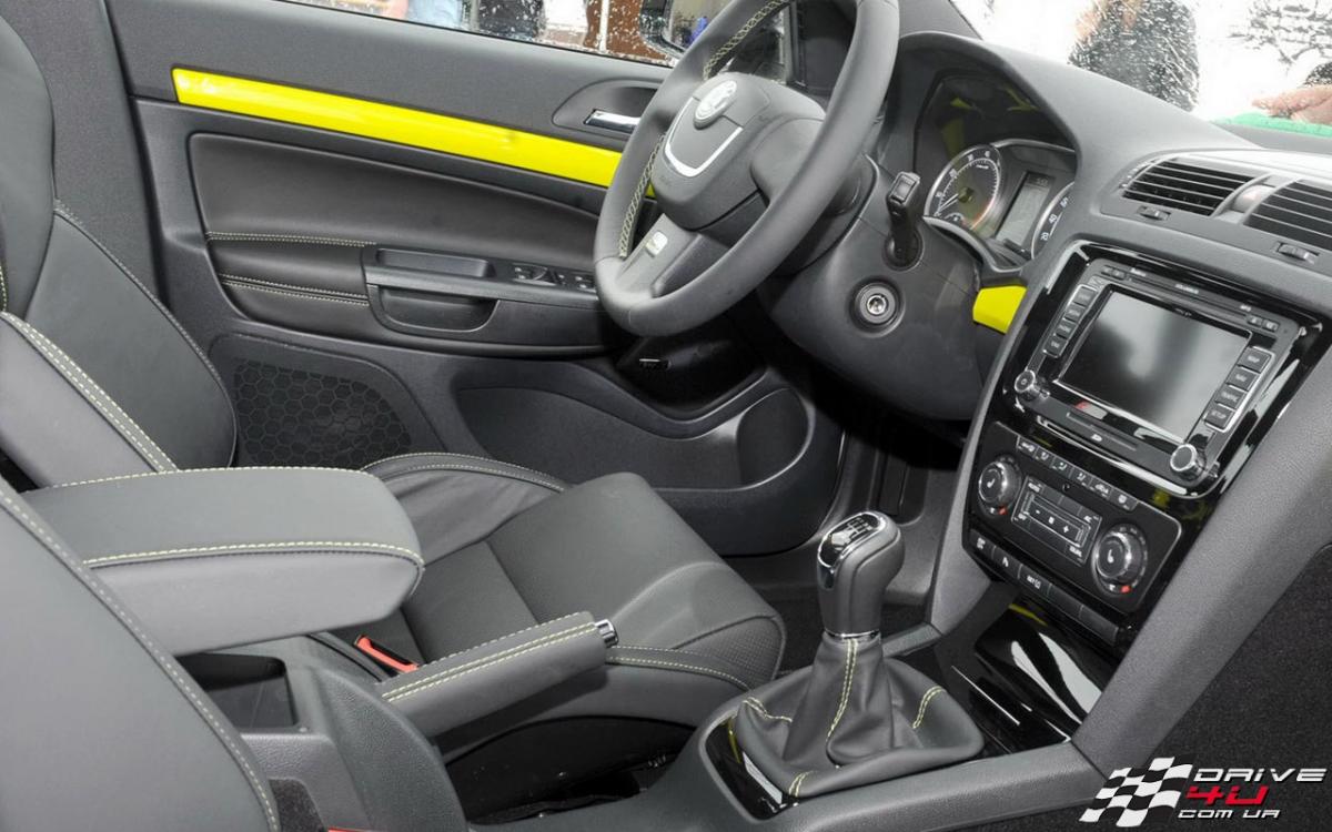

I found a picture of a Skoda Octavia vRS interior and what appears to be a premium sound system upgrade.  I understand on the new Octavia and Superb a Canton sound system is offered?
I can see what appears to be a badge tacked to the speaker grill on the drivers door. The car is left hand drive model.

The canton is only available from the factory on the new Octavia 3. A retrofit to yours wouldn't sound right at all due to the EQ side of things being setup for the newer, bigger car. Focal are a decent brand but IMO in the older octy its equally to do with sound deadening the doors for the upgrade benefits to be heard properly. :)
