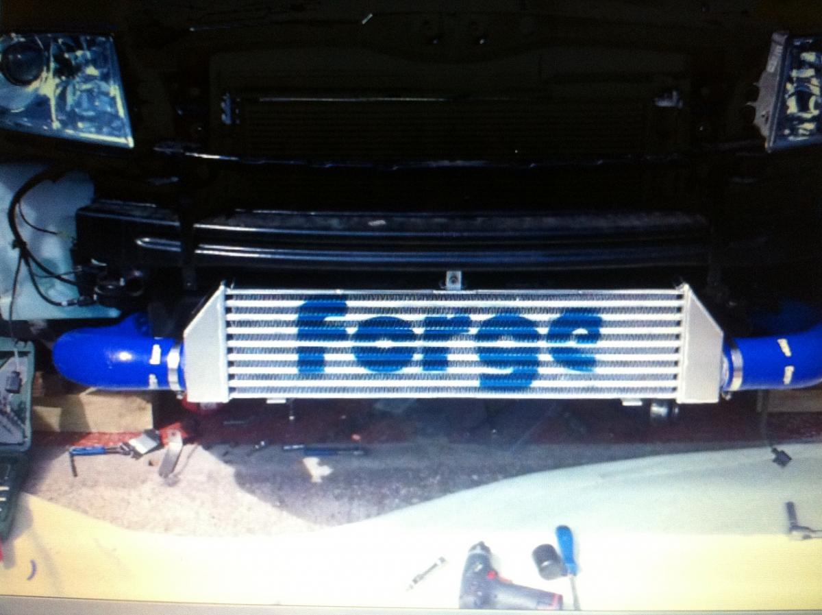

I fitted one to my 57plate vrs with no issues at all just follow the instructions, if I remember right I removed 2 vertical tin plates to allow the pipework to fit, but a few years have passed but as said follow the instructions as they are good.
Awesome! Thanks for the quick reply!
I think the two tin plates you reference are the ones I'm on about. They are painted matt black and are very flimsy!
I take it these are not integral to the front end?
Did you notice any difference once fitted? I'm running stage 1 with intake and cat back exhaust. Really struggles in the heat, or after a couple of spirited runs!
Yeah those are the plates I am on about, they just came off really easy and are of no structural part of the front end, We did some vag com runs with the standard intercooler fitted and then some with the forge twincooler fitted, I was quiet surprised at the drop of intake temps especially when ambient temps where high, I didn't notice any power drop when the cooler was fitted as well. I was running stage 2+ though so was creating some high intake temps when standard but was very impressed when the forge cooler fitted.
