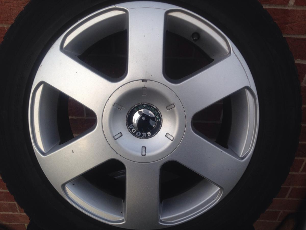

Anyone seen these wheels fitted to a yeti?
Just wondering if anyone has seen these wheels fitted to a yeti. I think they are a style called vega and are r16 They have came up for sale locally and I think they might do for a set of winter wheels. They are 16 x 6.5j ET 50. post-103241-0-35184600-1380712446_thumb.jpg
Had though about those myself, but my insurance would only take Skoda UK recommendations which is 7J x16 ET45 with 205/55/16  94H or V  for winter wheels and tyres even though mine came with 17" from factory.

Just wondering if anyone has seen these wheels fitted to a yeti. I think they are a style called vega and are r16 They have came up for sale locally and I think they might do for a set of winter wheels. They are 16 x 6.5j ET 50. attachicon.gifimage.jpg
Not those, but I have a set of MSW 22 alloys which are 16x6.5 ET48 for my winters (205/55/16 94H XL Nokian WR A3s). They clear the brakes of the 170 fine.
I'm lucky in that my insurance company have no limitations on fitting winter wheels. Just as long as I wasn't going to bigger size wheels I'm grand. I was thinking of just sticking to the skoda recommended 205 55 16 or perhaps go for the larger 215 60 16.
Your insurance may have no problem with fitting winter wheels as do most, but you may find not fitting  a recommended size ie 7Jx16 ET45 may be a problem. And if your thinking of 215x16 tyres, they require a 7"wide rim.
