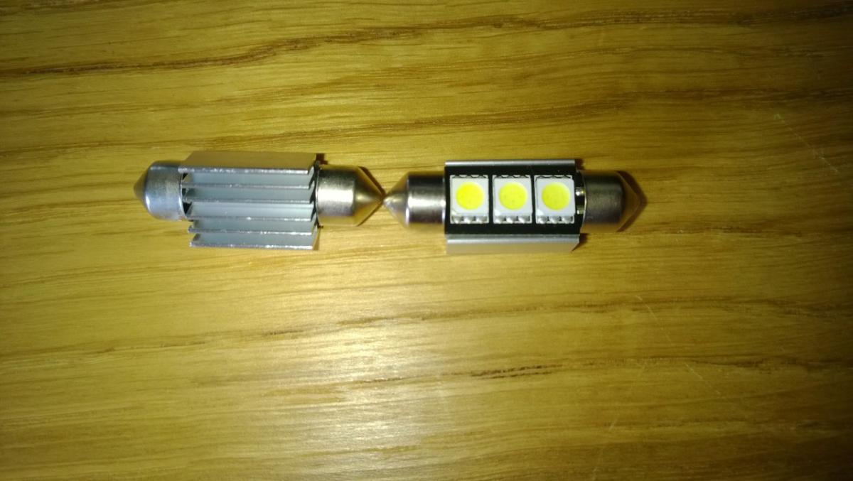

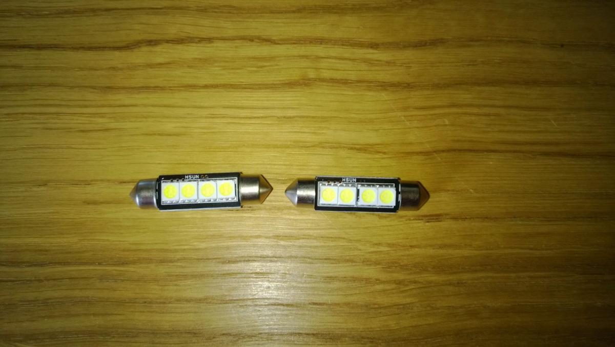

Hi all I bought this kit of LED's off ebay the other day
http://www.ebay.co.uk/itm/300885268105?ssPageName=STRK:MEWAX:IT&_trksid=p3984.m1423.l2649
The problem is that they came off loose and I have no idea which ones are which lol
I have attached some photos of them and would be really grateful if someone could advise me.
These will be going into my Skoda vRS 08 plate pre facelift.
Many thanks
Tom.
Edited by Tom1984
42mm festoons fit in the roof lights
38/39mm festoons fit in the puddle lights in the door, if they are 36mm they fit the rear number plate

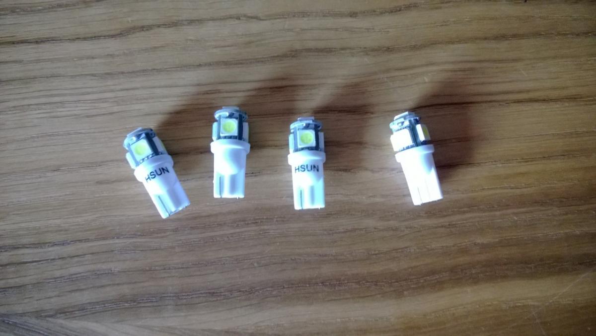

The w5w bulbs also go in the front roof light as the map reading bulbs - I don't think the rear light has those, just the festoon - not sure why you have four, unless they anticipate you using two as sidelights
