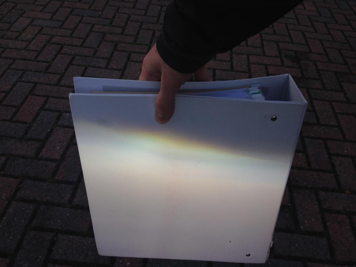

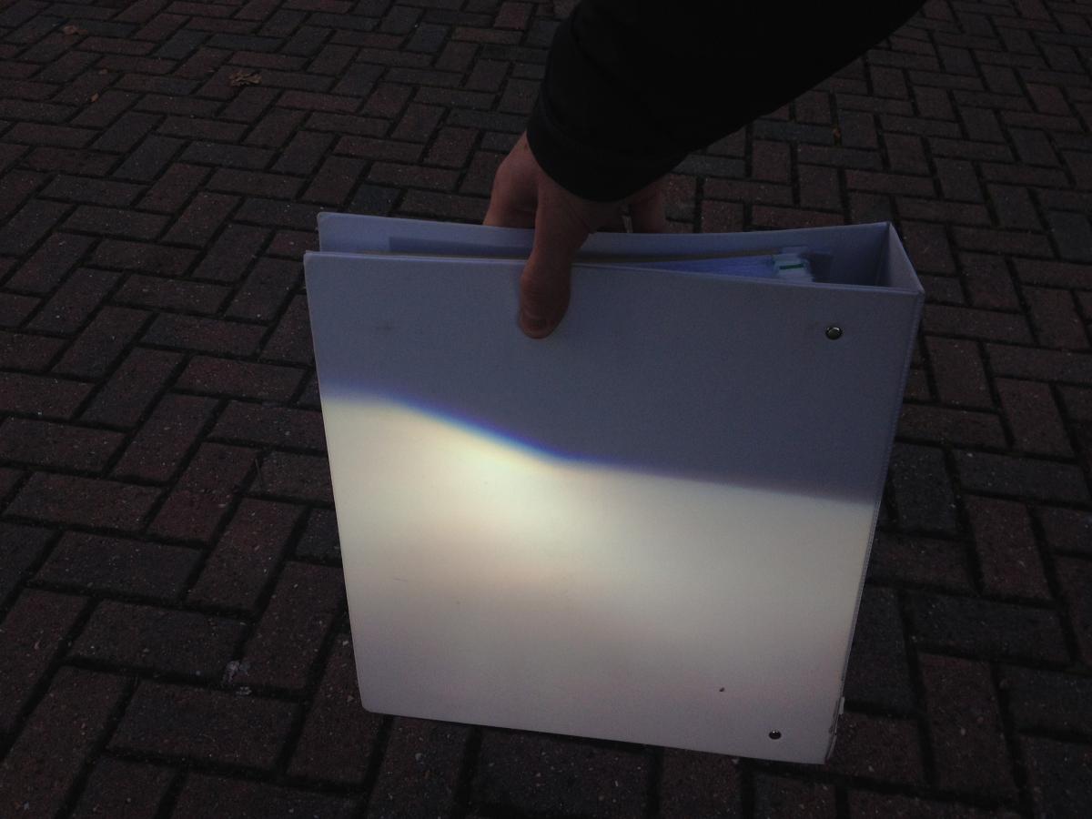

I have depo projector Xenons - 4.3k. Passenger side is coming out white/blue, the drivers side is coming out with a yellow tint on top of the beam making both bulbs look completely different.

Photos to show :-
From a distance it's very noticeable.
I changed over the bulbs and it was the same. I got a replacement headlamp but it's still the same. I'm thinking possibly HID kit (?) However when i had normal headlamps on 6k they were both the same colour wise.

If you swap the bulb and ballast from the side that's fine, and it still does it, the headlight unit is faulty.
Just swapped the ballast over to the yellowly side and it's still the same. This is the 2nd headlamp now :o
yeah, its a discoloured lense in the unit, i had the same issue.

This looks to be your problem . It's often a side effect of cheap lenses, which I guess they have in the headlights you've ordered. There's not much you'll be able to do to solve it, it's just the colours being separated as it goes though the lens. The fact it's not consistent from one unit to another, just makes me believe the lenses aren't made to very fine tolerances.
You may have seen the same effect on old-style OHP projectors. It happens towards the edges of the beam on those too. I wouldn't worry about it.
