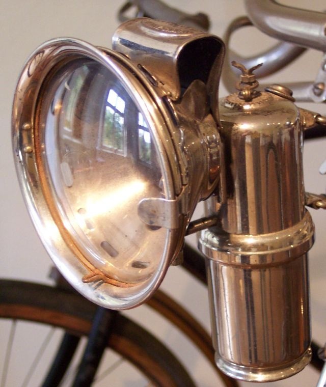

^ Really?  I think my SE's got old-fashioned acetylene or whatever?
My SE had the acetylene, it was a bu@@er to light them in the wind  :giggle:. So upgraded to the halogen NB plus much better and they work off the switch  :giggle:

Like this? Just a bugger polishing
