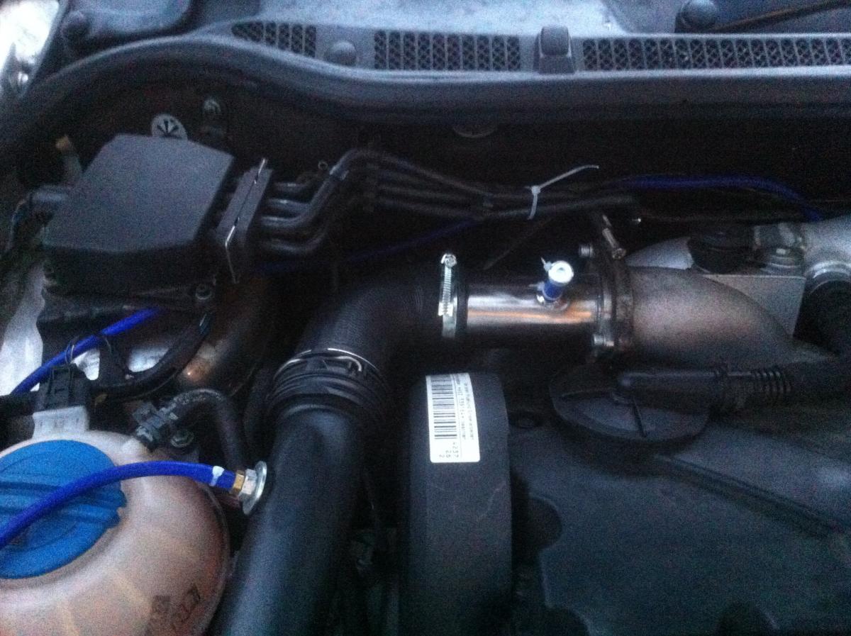

My egr delete fitted
About 2 hours and job done , well chuffed with it
Nice nice!
Why do you have two places for your boost gauge though?
I've ordered another platic boost pipe to get rid of the one on the upper pipe and go in to the delete, but it hasn't arrived yet , hense why I've blocked of the boost nipple
Is that the 51 to 57 90 degree pipe you mentioned in another thread?
Nice one Olly. Can I use this picture for future Group Buys please ?
Also, what diameter piping did you end up using ?
Yeah u can use it no probs , no I mean the pipe from the intercooler up to the 90 bend, I've orders another standard one so I can put my boost guage pipe in to the egr delete , but I'm tempted by the stainless up pipe that is in the group buy for next year , £133 not bad
