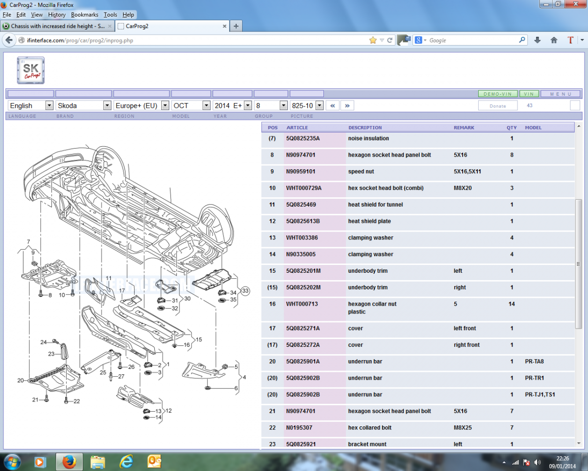

Now at home I've more access to other links and looking at the on-line parts book, then item 7 is the normal insulation panel and item 20 the alternative reinforced thermoplastic sump guard, similar to that fitted to my RRP equipped Yeti, which I believe is what is described as the stone guard on the Octy III.
Part number suggests it's a Golf VII part; Yeti has a Golf VI part number.

That's very helpful. When I get the car on a ramp I will see if I can work out which one it has fitted.
