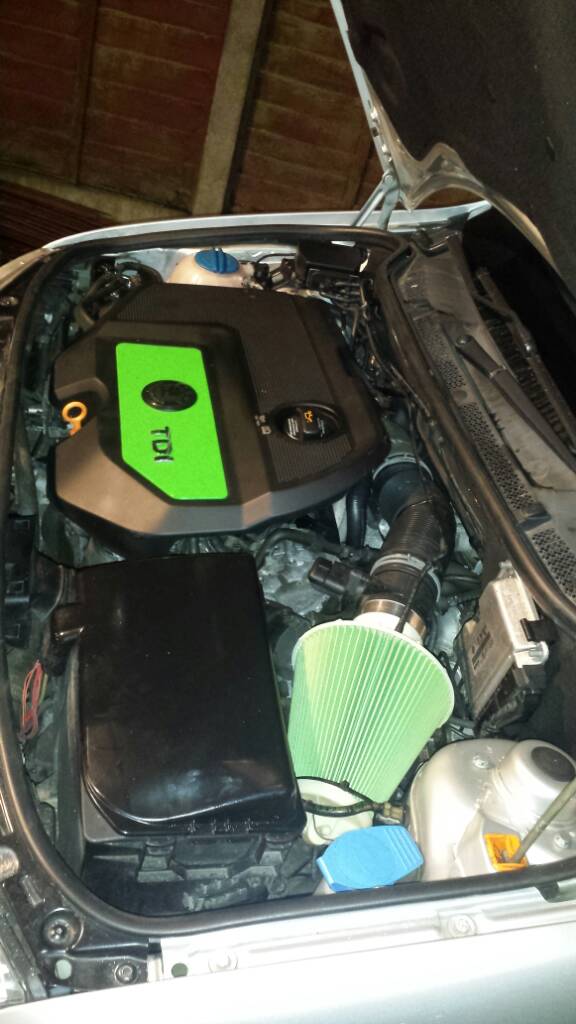

Upload photos of your induction kits, makes and prices as I need some idea for mine :) (vrs only)
O/e honda s2000 filter + hydralic clip 18quid
Sent from my GT-I9505 using Tapatalk

I chose the s2000 filter aswell based on cost and also the fact that if its ok for a 240bhp n/a engine. Then 175bhp turbo diesel will be fine. Its an oem paper cone filter.
I wouldnt go for a foam one again I don't think. Especially as these are 12quid off ebay :)

Im sure I already asked this but ive forgot the answer lol, do the s2k filters fit over the maf and then just tighten with a jubilee clip or do I need a silicone adapter? Will be fitting one when I've had a back box put back in to quieten it
once you have the whole airbox assembly off, you'll see that the MAF has a sleeve. the S2000 filter slides over the top of that and then you tighten with a jubilee (70-90mm)

Cheers I though it would fit like my old k&n but just wanted to be sure. I'm working in Sheffield on Friday so might call to ecp and get one along with a pollen filter when I have a look at it tomorrow if it needs one.
What induction is this ?
Yeh a honda s2000
Its a common mod on the 1.8t engine as its a genuine cheaper good qaulity cone air filter
Yeh a honda s2000
Does your s2000 filter have slits in the neck to so when you tighten it it will close as I've just bought one and it's a solid neck, is that right and it will tighten anyway with a jubilee clip round it?
It won't tighten but it's incredibly easy for you cut small slots using a hacksaw so that it will.
